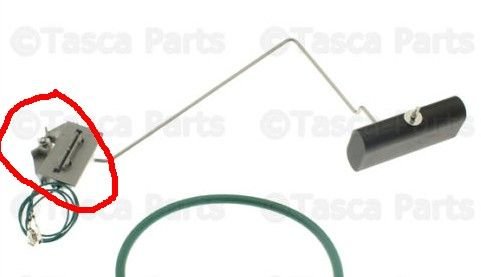

This is from my C6 but same principle. When the contact points on the sending unit become covered, they no longer send the signal when the float switch moves up and down. Bear in mind also that our cars have two fuel tanks. I'd put in a bottle of techron and keep the tank as full as possible so the unit stays submerged. If you have a Chevron station near you, use them exclusively for a while. My C6 did have a vapor canister located on the outside of the tank but I don't know for sure if the C5's do.
