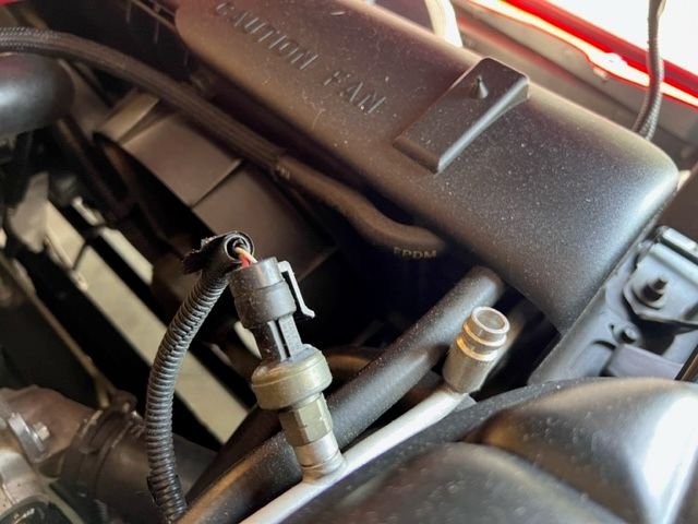

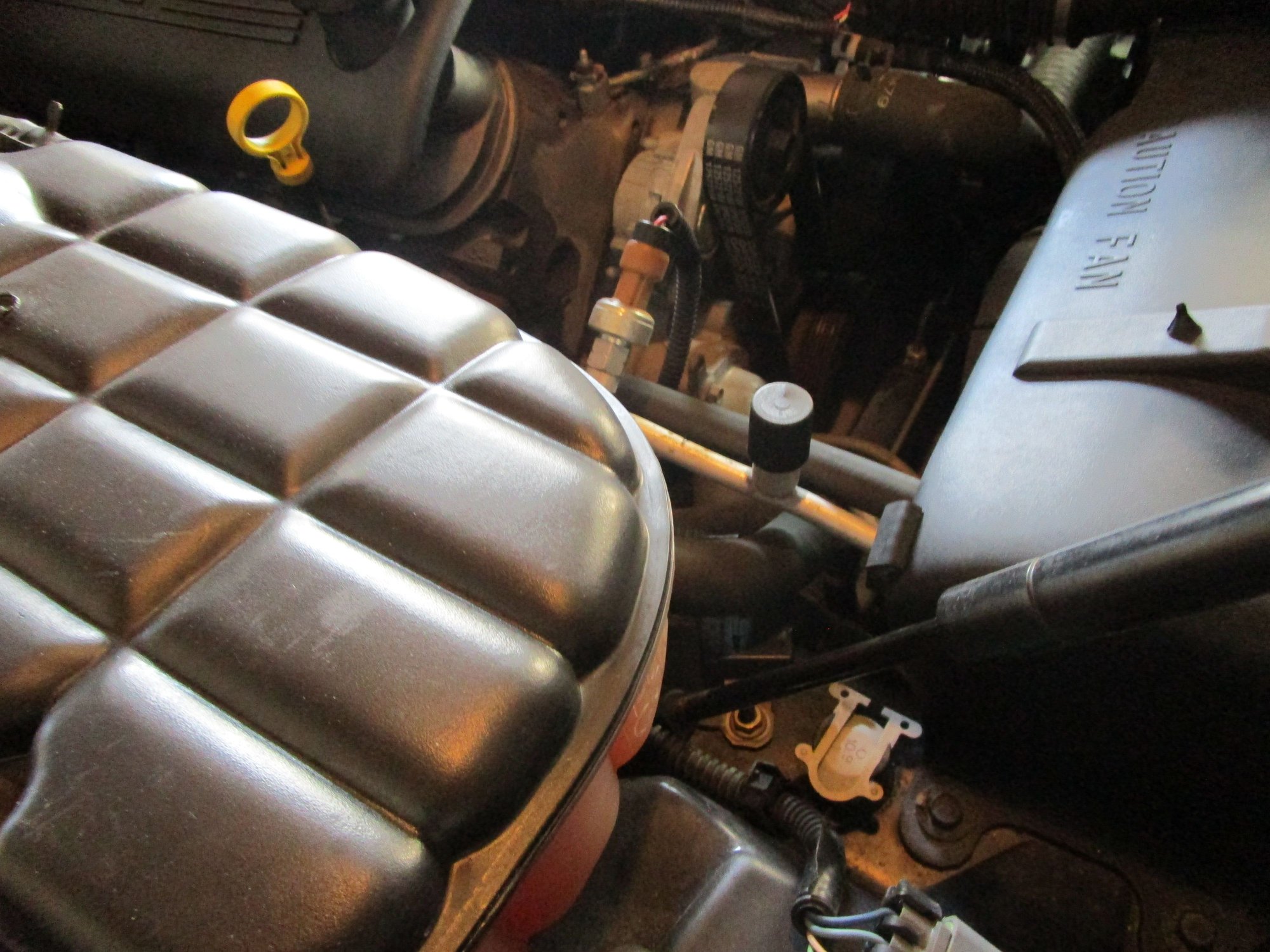

Does anyone know if this part should have some type of cap on it? I have no idea what its called to search the forum or the internets to see if its missing a cap or its ok how it is. Any help is appreciated!

That is the A/C refrigerant high side port and yes it comes with a sealing cap and yours is missing. The refrigerant type is R-134a, so you need a sealing cap for that type of refrigerant and it must be for the high pressure side of the system and not the low side.

You think its ok to drive around for a few days without it as I wait for the part to arrive?

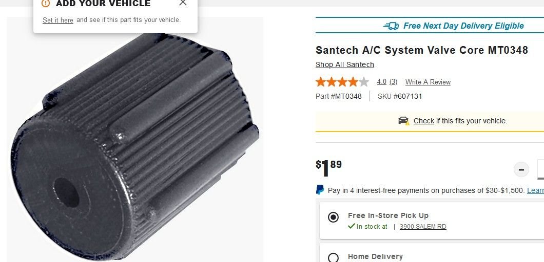

Here what it looks like : Basic Black Cap !
You should be fine. Although it is a secondary seal, it's mostly to keep dust and debris out. Put a piece of tape over the port if that makes you feel better.

It is common to all GM vehicles using 134a. I'm sure a local parts store will carry a dorman equivalent. Autozone

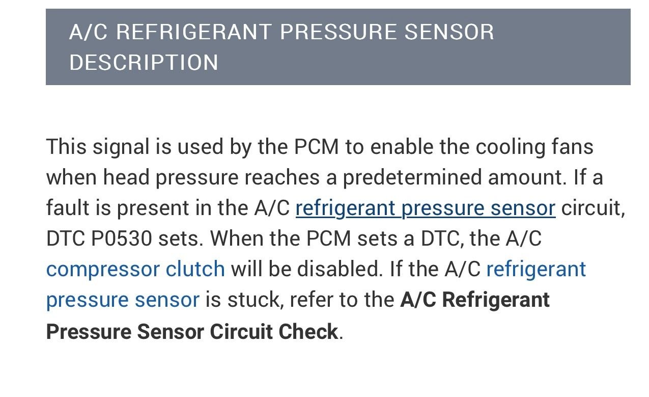

The switch you reference on the C5 is technically a 3 wire “AC Pressure Sensor”…info below from the FSM.

According to GM the cap is the primary seal, and the Schrader the secondary.
Just noting, not necessarily agreeing.

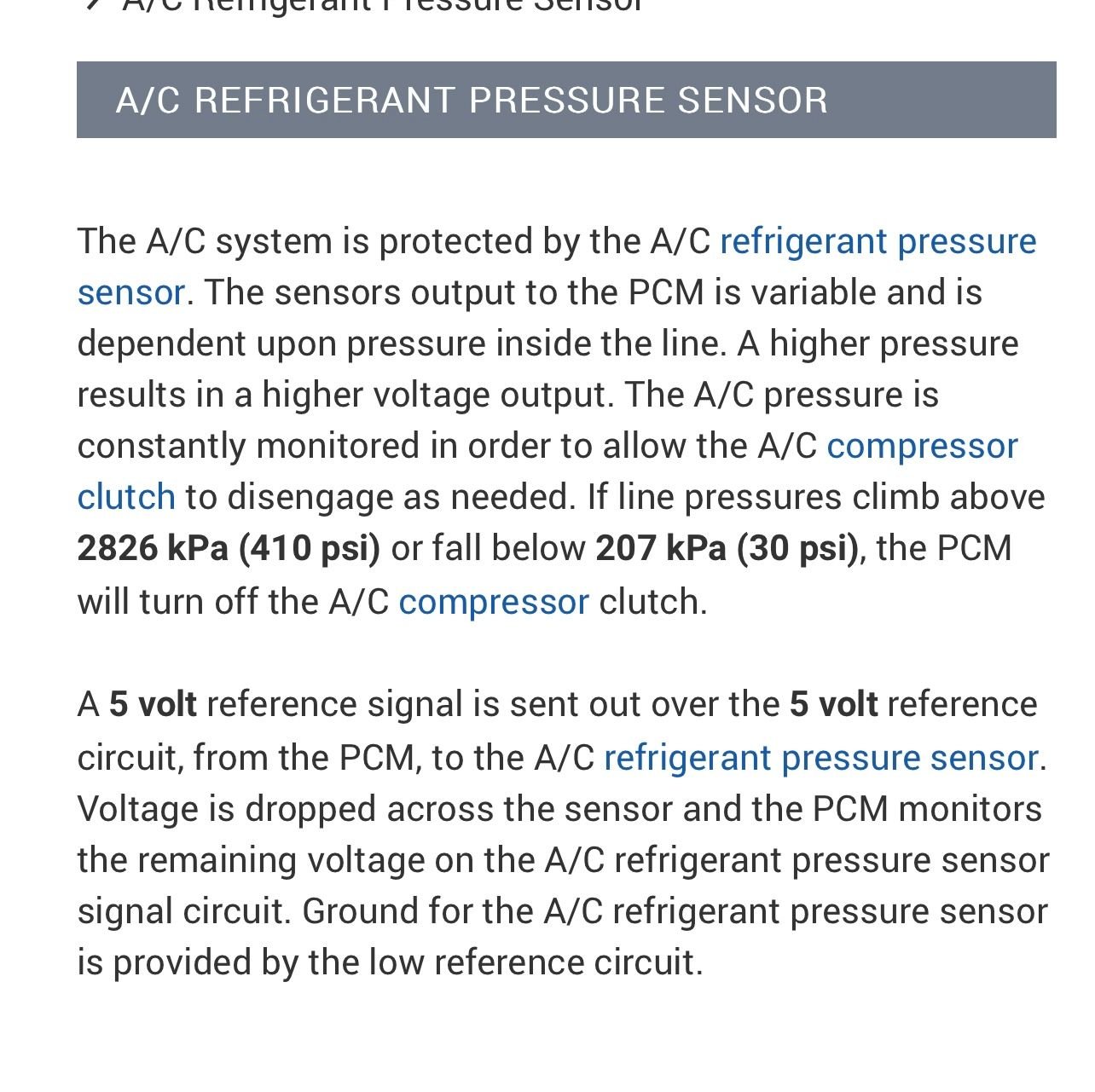

If I understand correctly, not likely lol, there is already a pressure safety on the high side. But is there a compressor shut off on the low side?
Yes, the AC pressure sensor is just on the high side and here is the info on it from Service Information.

as mentioned, you can drive the car but put a piece of electrical tape over the port until you can get the cap.
