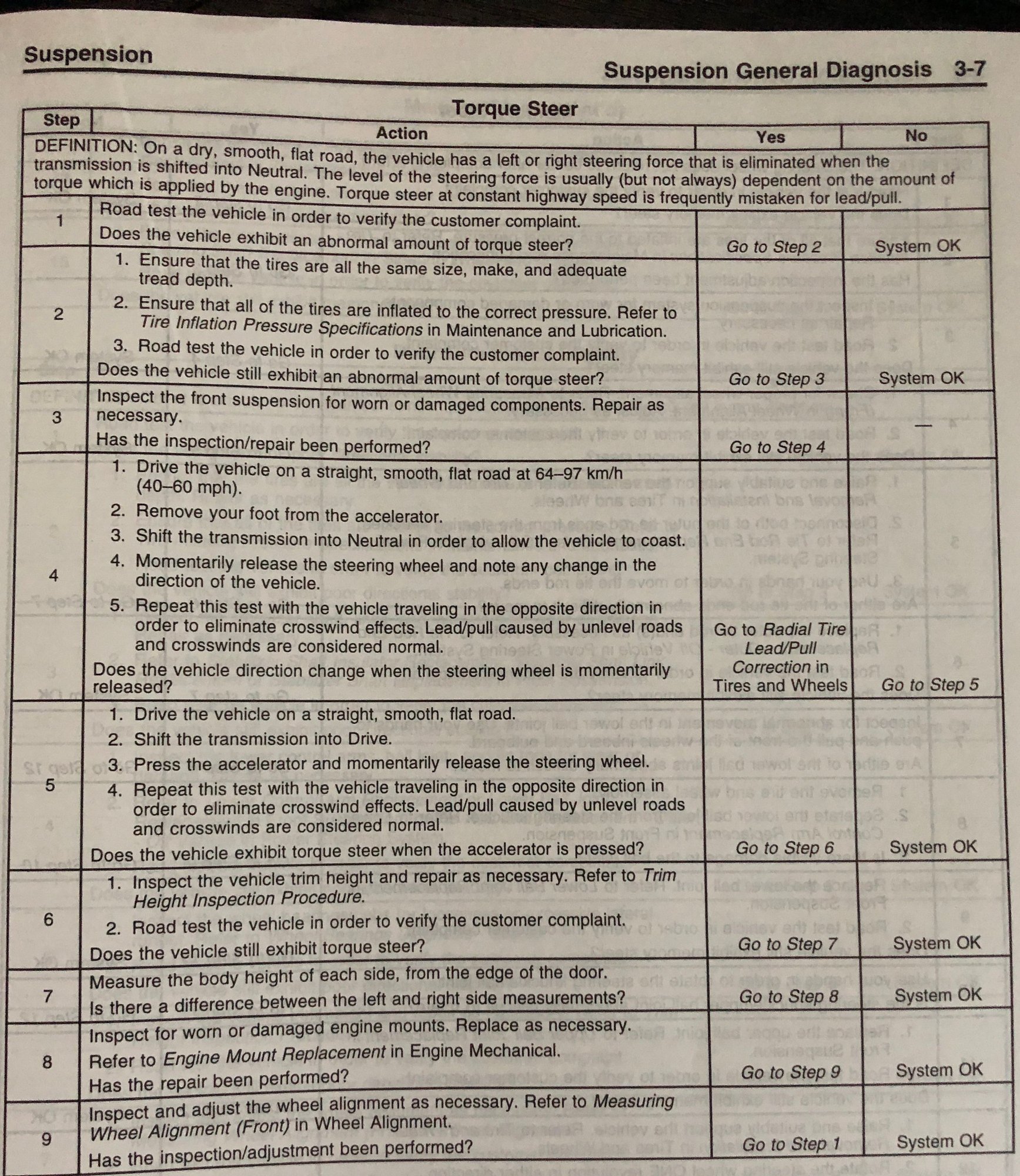

Originally Posted by d.moscatelli@comcast
a problem called torque steer. When cruising , steering wheel held straight, cruise control on, the vehicle would go relatively straight. But when the throttle was released, the car would gently drift to the left, and when the throttle was applied, the vehicle would gently drift to the right.
Note that your definition is different than GM's definition.
This is the definition used in the 2000 service manual: On a dry, smooth, flat road, the vehicle has a left or right steering force that is eliminated when the transmission is shifted into Neutral. The level of steering force is usually (but not always) dependent on the amount of torque which is applied by the engine. Torque steer at constant highway speed is frequently mistaken for lead/pull.
