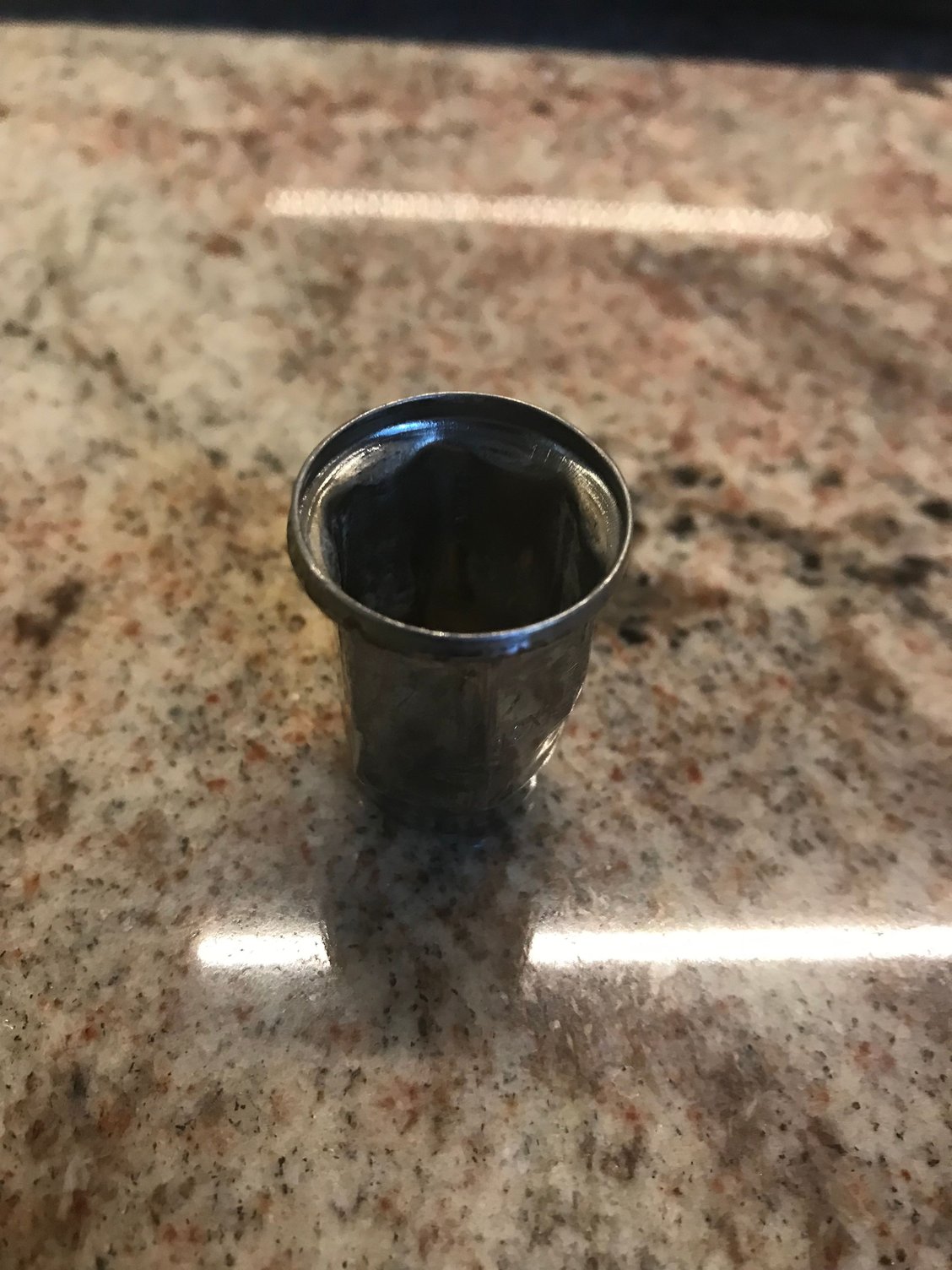

Were the OEM lug nuts used with the thin spoke or Y2k wheels just a chrome cover over a steel nut?
In putting the rear tires back onto my '04 today, went to tighten one lug and my socket would not go on, so I tapped it on, but then the lug nut would not tighten down, felt like it was stripped. Had to wiggle the socket off and when it came off, a thin metal cover came with it......see picture.

Have ordered a complete set of McGard 64012 as I have two 13/16 or 21mm lugs and all the lug nuts have corrosion on them between the steel nut and chrome cover......the joy of purchasing this '04 from Florida.

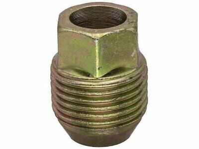

Correction: what I have are not factory lug nuts as they are not as shown below from Adwest52. I had that style on my '95, '96 Corvettes as well as my '02 Blazer.
The ones I have are probably made in China.

The lug nuts for the factory thin 5 spoke wheels (Y2K) were steel with a plastic cap that threaded onto it.
