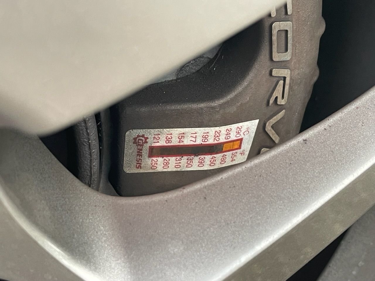

If you need help to decide when upgrade time, get this temperature indicating sticker and put it on the caliper body... ideally near the piston (eg, fluid) and not what I did lol. If you max it out, whole sticker black, time to upgrade for sure. I think if I get one more dot (over 480°) I will consider it...
