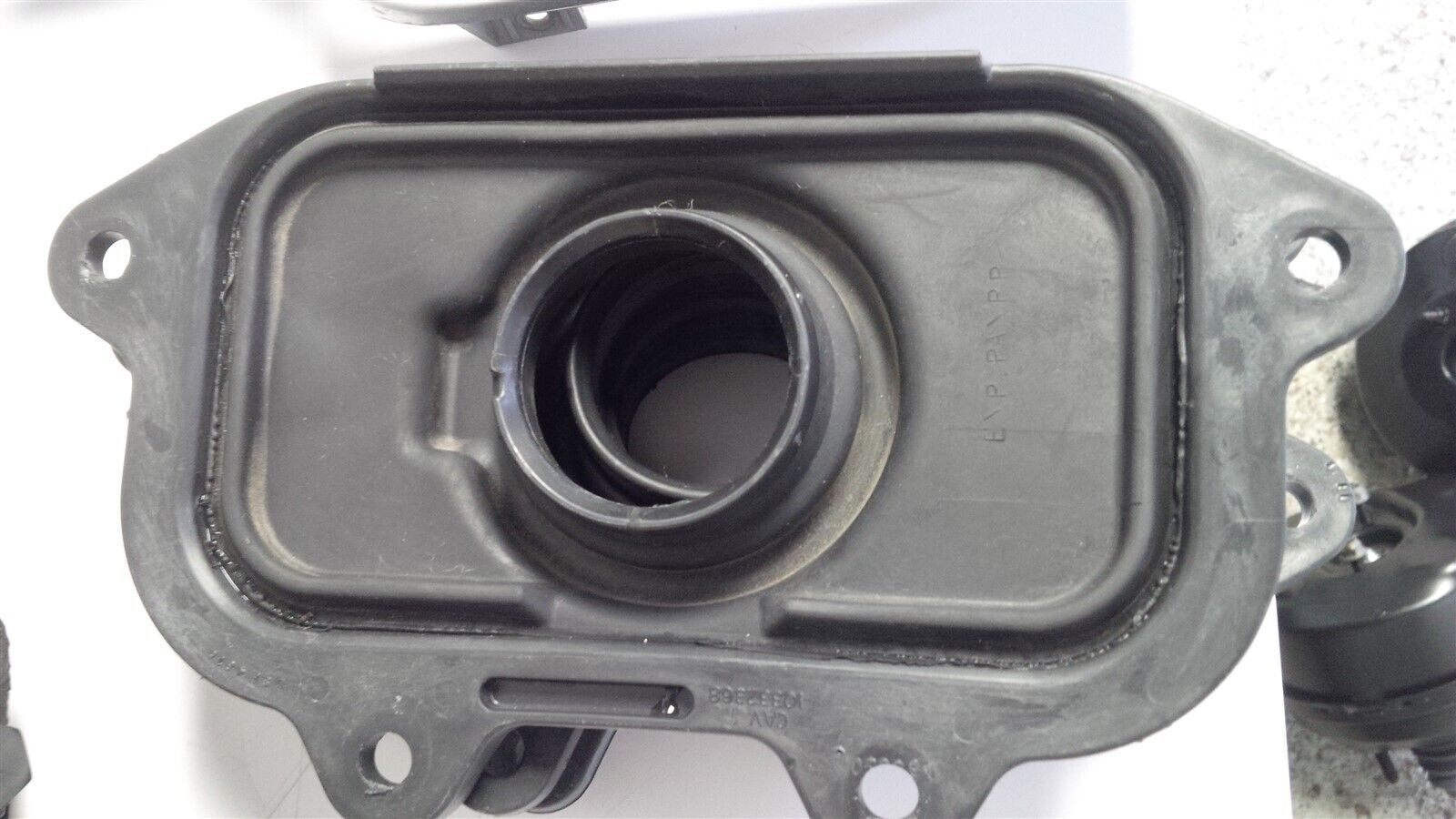

Originally Posted by Tusc
Yes you reuse the cover. Absolutely. Unless you want a reeeeally loud interior. If the base of the shifter is too wide then you need to carefully cut it to fit/allow the shifter. Less cutting is more as it will give you a positive seal around that shifter base. If you cut too much you can use your preferred sealant. I have recently used orgavyl which is not perfect because it doesn't like TT tunnel heat, but does seal well to the boot.
Thanks, I heard back from the good folks at Callaway this AM who confirmed the same.

Originally Posted by Vader_C5
Got the Callaway Shifter installed this evening, does anyone know if this rubber boot/insulator is supposed to be re-installed with the new shifter? The instructions weren't too clear on this. CC: @njpete19 @Info@CallawayCars
Is it still possible to purchase a new one of these "boots"? I trimmed mine, minimally, when I installed a Hurst shifter in my C-5, MANY years ago. I did this, just in case I opted to re-install the OE shifter at some time in the future, so the boot would still, more or less work with the OE unit. However, the fit with the Hurst shifter, is less than optimal, and I'd like another unmodified boot, again, "just in case"....

Finding a new boot is probably still possible. Just beware that the C6 has two bolts which are different, so chase a C5 specific model. Used off a wreck is fine too if unmodified. And you can add the C6 upper boot and cut to fit as well. More sound deadening.
UPDATE: reinstalled this insulator boot tonight and did not cut it at all, seems to fit fine with no restriction to shifting. Sound/heat is better with this installed, of course.

Any pics of the shifter with boot installed? The square base inside the round boot opening has me wondering how it makes a positive seal.

The one on my C6 is cut then secured via zip tie.
Funny enough, I neglected to take a picture, but the insulator is secured, and the heat/cabin noise is back to levels before the surgery

I'll take the time this weekend to install it and try it out. The square base is offputting to me about getting a positive gasket seal. That can be handled if I kept it. The unit itself needs some break in. It slides in one direction smoothly. In the other direction it breaks faster. I believe the ball it all rides on is simply not fully lubed on all sides. I have the fix for that for sure. It definitely has centering springs. Not weak. Not rock solid. But somewhat strong. And the center shaft setup allows the upper handle to be installed to either side. Wouldn't it be funny if the BPP had the same center distance between bolt holes? I might give this thing a fair shake in my daily for a while. We'll see. I like the BPP and the C7Z it replaced. And the Tmod/Mgw remains my high water mark above all. The Tmod box is refreshed and I'll likely slap it in with this one for now.
