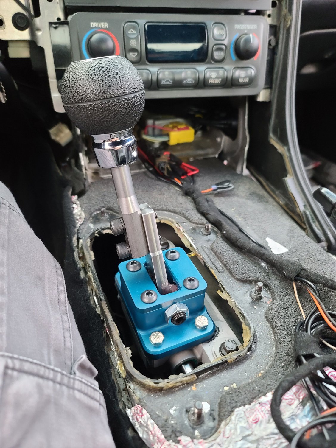

I finally slapped mine in.
Along with the brand new TMODcustoms Z06 tub, including one of his upgraded bushing cups.
It is well assembled, solid, and does the job just fine. Clean motion. Positive engagement. Not as light as I'd expect for the relative height.
A plus for some would be the adjustable stops. I see them more as a way to adjust travel and fore/aft alignment without adjusting the two TT mounting bolts. I didn't play with them.
Negatives to the design: the need to make a gasket to seal it to the tub itself, the open-to-air top of the shifter housing which will collect debris in time, and the square housing which... while currently sealed with some windshield sealant... doesn't naturally mate well to the oe circular cover.
It's not grabbing me, so I'll probably yank it this weekend and post on here.
