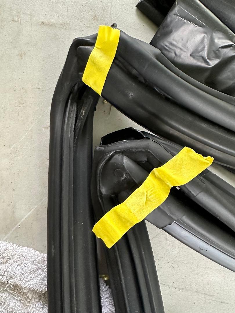

The picture is Top weatherstrip is a C5 OEM A-Pillar weatherstrip.
The bottom of the picture is a CorvetteRubber C5 A-Pillar weatherstrip
the corners don’t match the OEM + the miters do not match the angle on the C5s fixed aluminum trim miter.
I ordered 2 C5 A-Pillar weatherstrips.
I ordered the first one from SteelRubber. The top corners do not match. Plus the weatherstrip is not molded with the correct miter angle as the OEM windshields aluminum trim miters. The miters don’t match the OEM aluminum windshield trim miters + the driver side corner was pulling apart at the glued corner seam.
I sent Steel Rubber pictures and they issued a refund and told me to keep the A-Pillar weatherstrip.
I ordered the second one from CorvetteRubber. I thought they were different manufacturers. The two were identical and I decided I to have a couple shops look at it and see what they thought. They both agreed the top corners are molded totally different + the mitered angles aren’t even close to the OEM mitered angles in the pictures.
I sent Mike at CorvetteRubber pictures of the miters angles did not fit the OEM aluminum windshield trim and he told me it would fit if I worked at fitting it. I took it to two of the best shops in the north Chicago suburbs and they agreed the miters don’t match the OEM aluminum windshield trim. I told Mike for 900$ I wanted a better fit. He then agreed to sending me a return label and refund.
Mike did send pictures of the Burgundy C5 Corvette Convertible that CorvetteRubber installed their A-Pillar weatherstrip on.
I’m hopin there’s another manufacturer out there with a fit closer to OEM.
