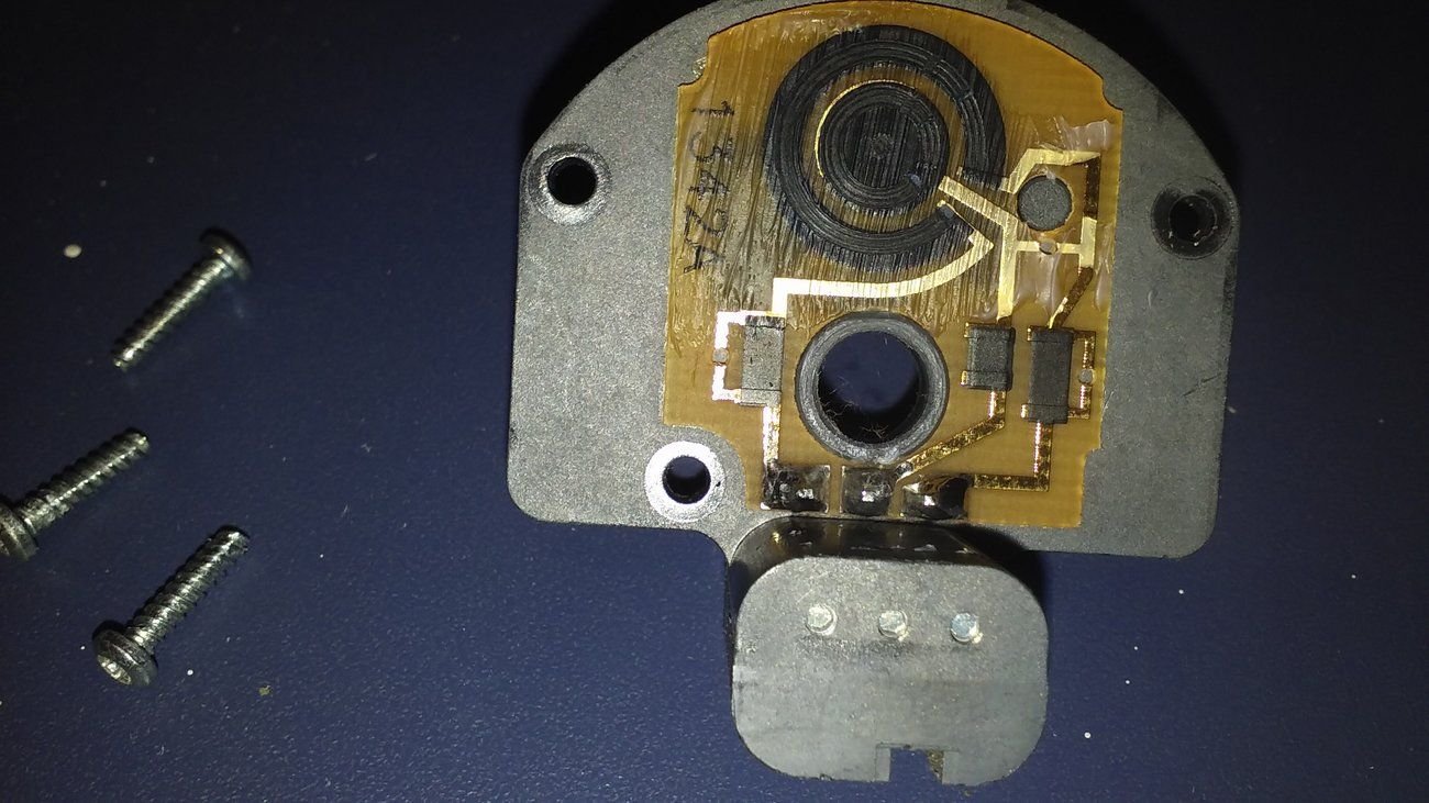

One cause of wandering seat is that the contacts in the seat motor that control seat position become gummed up. One way to diagnose is to run the seat back and forth full range a few times. This procedure may temporarily cure the wander. If it does, a more permanent fix is to remove the seat then the motor and disassemble the rear of the motor where the contacts are and clean and dielectric grease them.

Another thing that can cause this is a dirty potentiometer under the seat. Mine did this every once in awhile, and I read a thread on here somewhere about how to clean it. Seat removal must happen. Also need a work bench to rest the seat on. Make sure bench is very clean, as you must flip the seat upside down, and it will then have the leather resting on the bench top. Do a search. Not terribly hard, but a couple of hours, minimum. Hope this helps.....
