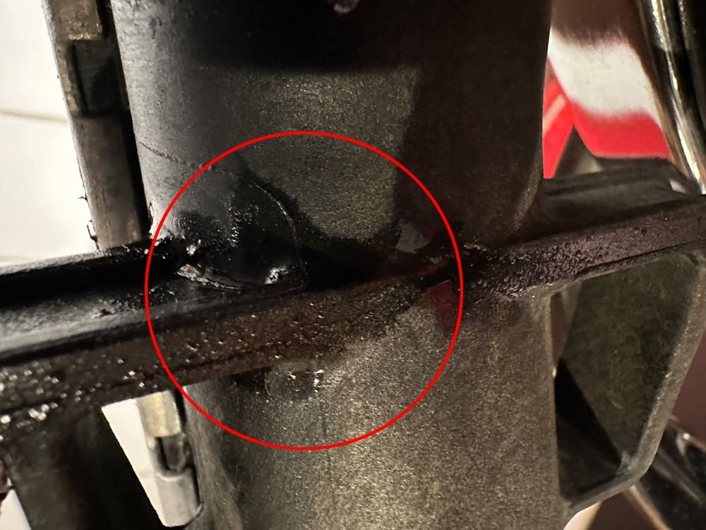

So, in 2019 I had a 14 day hospital stay that really took the fire out of me (did not see that one coming), but when I got out of the hospital, I noticed a few spots of coolant on the garage flor when I got home (when it rains it pours!). I was really in no shape to tackle that job at that point so I drove the car every day leaving spots everywhere and refilling whenever the surge tank would go down. Only used about 1-1/2 gallons through the leak in four years, but never missed a day without leaving drops on the floor. So, I have to give credit to that weak-looking stock radiator - it got me through a tough time.
Now that I have the old radiator out I can see the crack toward the top driver's side (pics below):

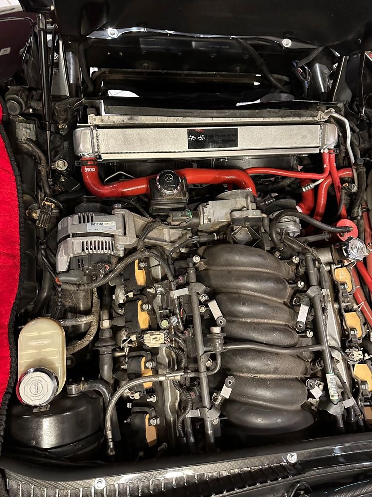

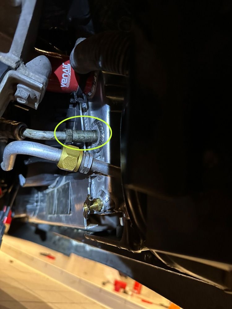

Well, I finally got up the nerve to tackle the replacement by myself. Working alone and without a lift, the whole job took me about 12 hours, but I really took my time cleaning things along the way , etc. Turns out that disconnecting the Transmission lines only spilled maybe 1/2 ounce of fluid from the bottom line only. I had one of the early 2001's, so my fittings were the non-O-Ring - metal-on-metal flared connections (fortunately ordered the right configuration from DeWitts back in 2015).
Added all new hoses and surge tank as well while I was at it. The only snag I ran into so far was after the initial startup, I noticed the lower transmission connection on the radiator was dripping a few drops of fluid. I loosened that flare nut, wiggled the line some more and retightened - that "seems" to have fixed the problem, but I will keep an eye on it.

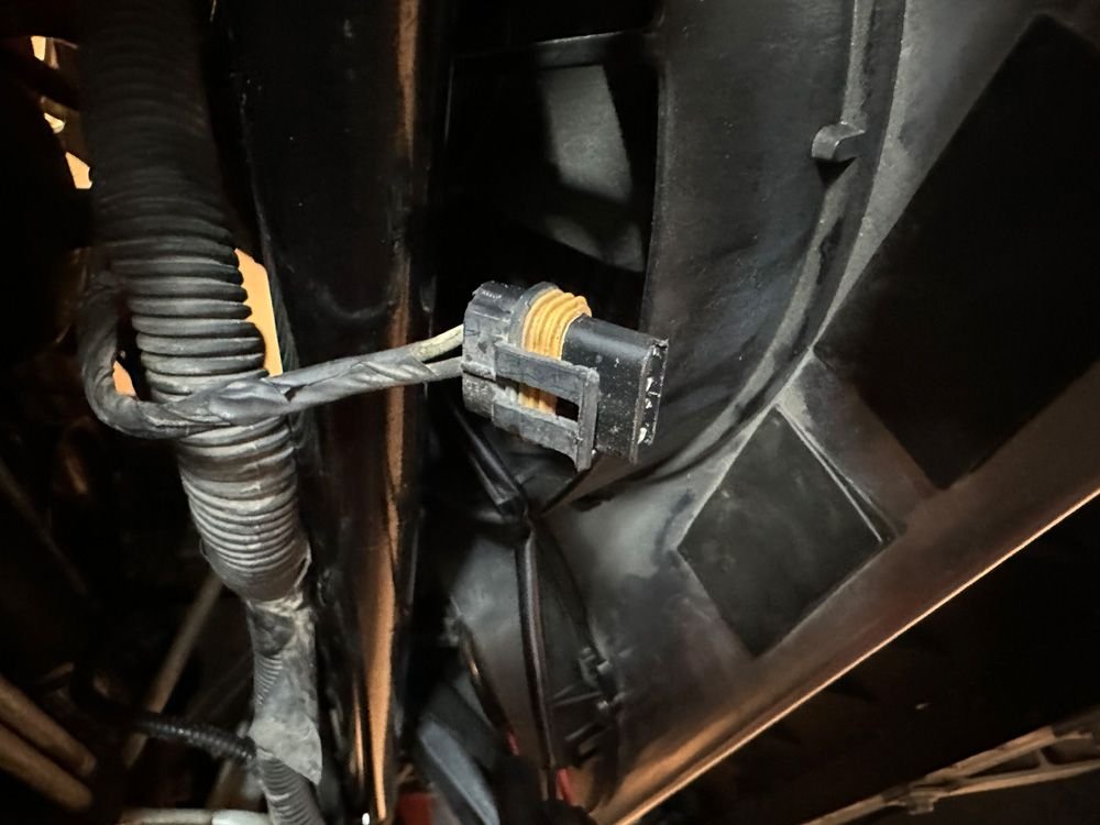

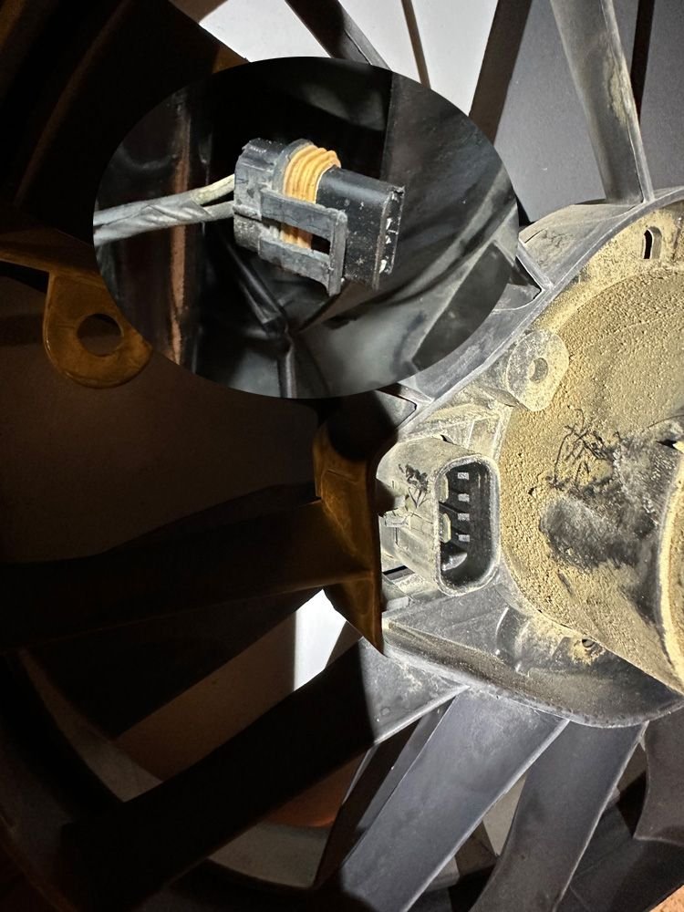

One thing that had me scratching my head was how to unplug the stock wiring harness plugs to the fans. I was doing that from underneath the car and they were right up against the sway bar. I finally got a pick in there to pull up on the small tab (on the male plug) to get them loose, but I am sure there is some trick besides using a pick to detach these things?
All-in-all very happy with the upgrade. Been testing everything out for a couple days and no explosions yet! Only thing I need to change is my high speed fan kicks on at about 196-degrees F (my old fans were probably doing the same thing), but that high speed SPAL fan is REALLY LOUD! In fact I am pretty sure I could shut off the engine and that fan would pull me down the highway! Looking up the stock fan set-points, mine were obvious out of spec - this "might" be a carry over from a Chuck COW mail-in tune I had done years ago?
On to cleaning up the engine bay!
