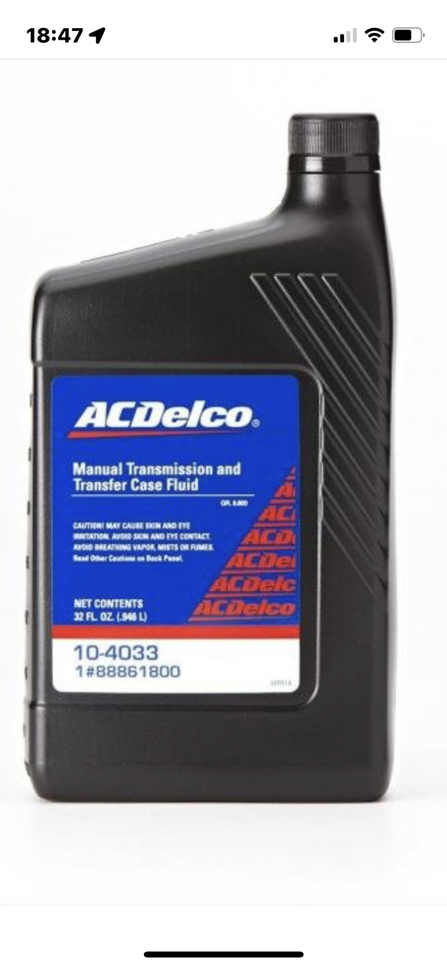

Default Trans fluid
Think I found the right one

Any Dex 3 ATF fluid works for the T56 you have.

Amsoil Signature ATF or Amsoil TorqueDrive is what I prefer.

I too initially sourced Amsoil's Signature ATF for the 1st trans fluid change in my 01 Z06. FWIW, I ended up using the recommended AC Delco 10-4033 after reading this from a reputable drivetrain & transmission shop near me <Texas Drivetrain Performance>:
Why not use synthetic fluid? Isn’t it better?
We’ve determined that synthetic ATF has additives which allow the synchro rings to slip a small amount, causing excessive wear. These additives are made to benefit an automatic transmission which has fluid under high pressure, unlike a manual transmission which isn’t pressurized. We’ve found that the life of the synchro rings are drastically shortened when using synthetic fluid.
Source: https://www.txdrivetrain.com/fluid-t...56-tr6060-faq/

Disclaimer: The info above is specifically pertaining to the Tremec T56 & TR6060 manual transmissions.

Not surprised. I ran Mobil1 Dex III synthetic for a while (dealer recommendation at the time). Later went back to Dex-Merc non-syn (Valvoline) and found that I no longer had to do "slow" shifts to avoid synchros grinding. Cheap too, about $18/gallon at Wally's.

so you support that 10-4033 is the right trans fluid for our T56

That's the right stuff for OEM fluid.
