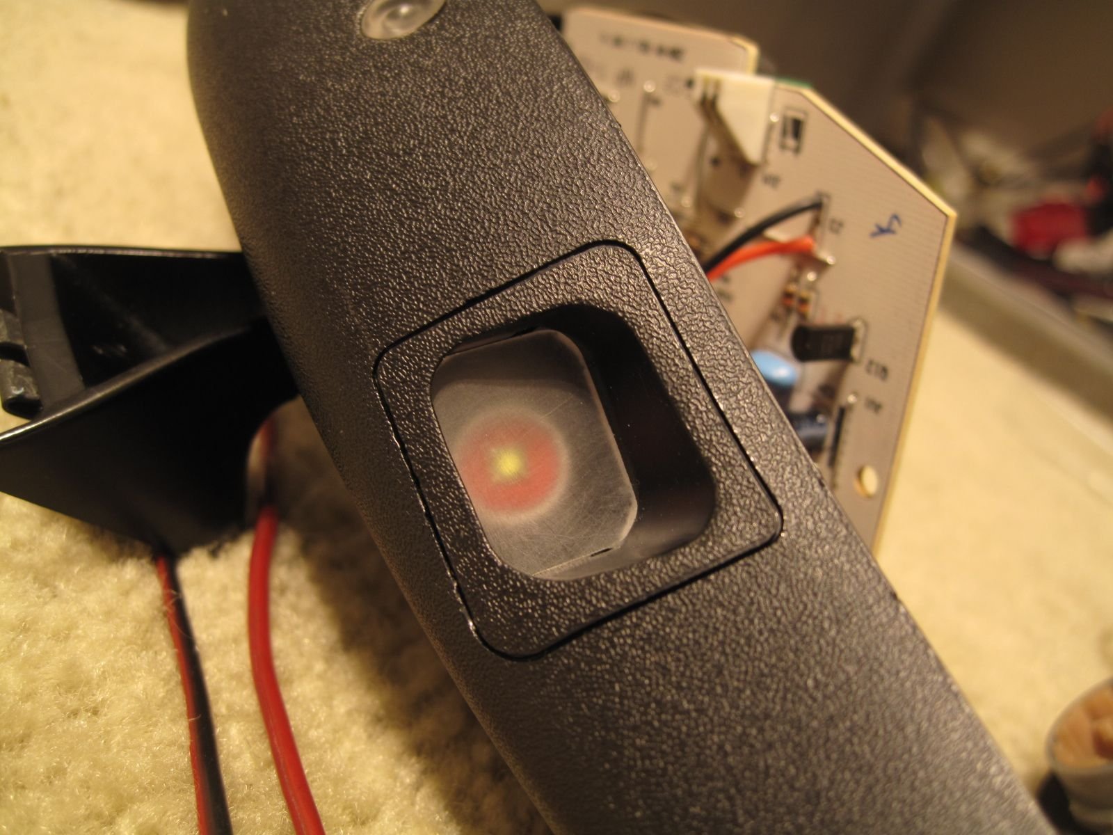

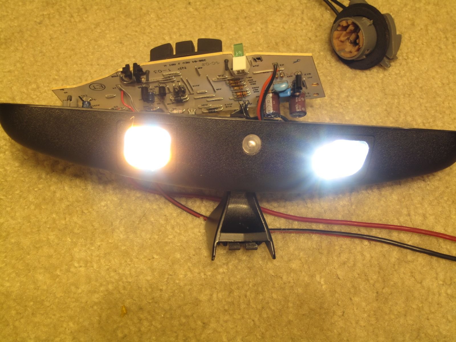

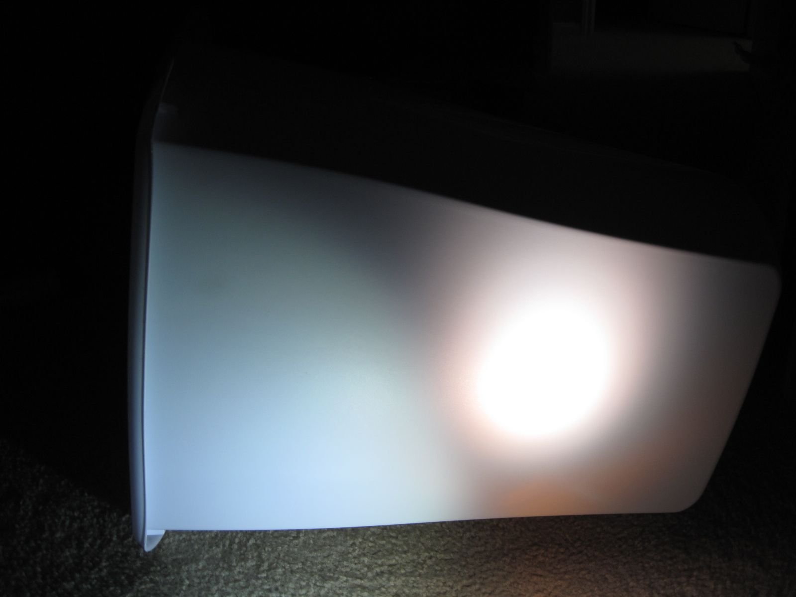

The LED array can be removed. The board gets 12v+ so you can hard-wire in a small 12v LED bulb (like a 194)
OEM LED vs white 194
new custom-made lens. (frost/sanded 1/8" acrylic)
color comparison
OEM create a spot pattern. The new LED is more of a flood pattern.
Both White LEDs.

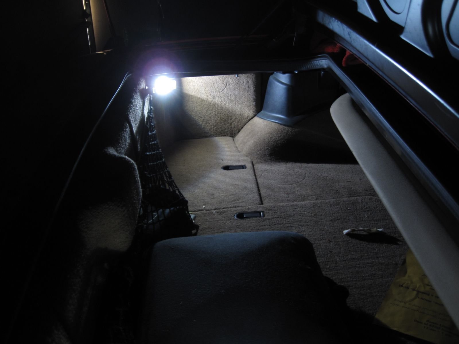

To the OP: WE have a complete interior LED conversion package HERE
Map lights (standard mirror repl)
Foot well lights
Cargo Lights
