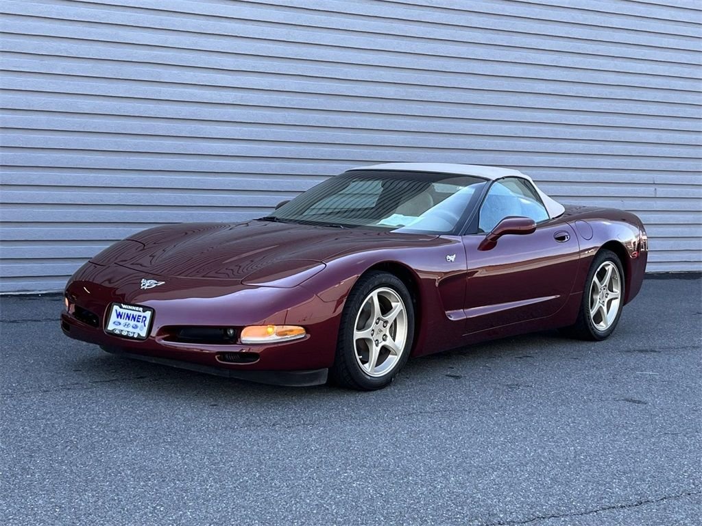

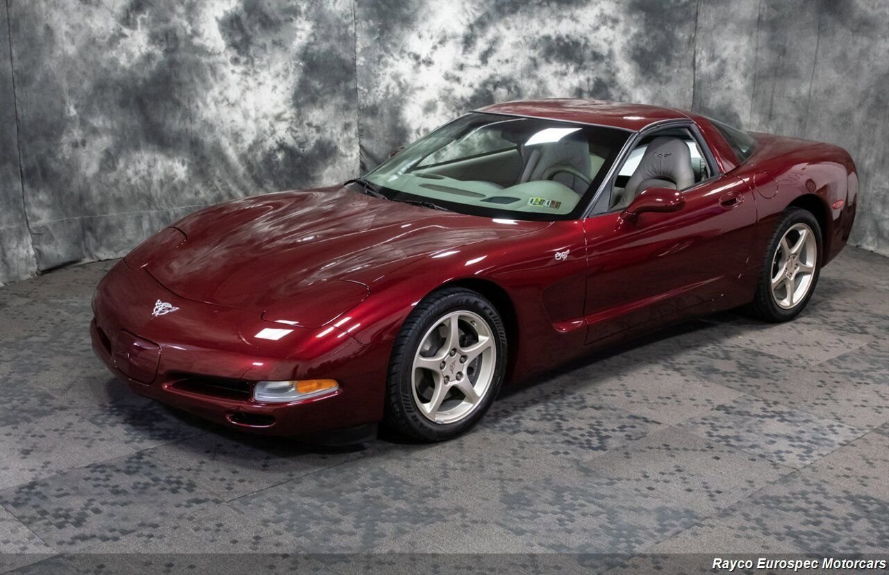

I have had 2 2003 50th anniversary Corvettes, one a coupe and the present one a convertible. To me they are truly a beautiful, beautiful Corvette. . .
And the present
