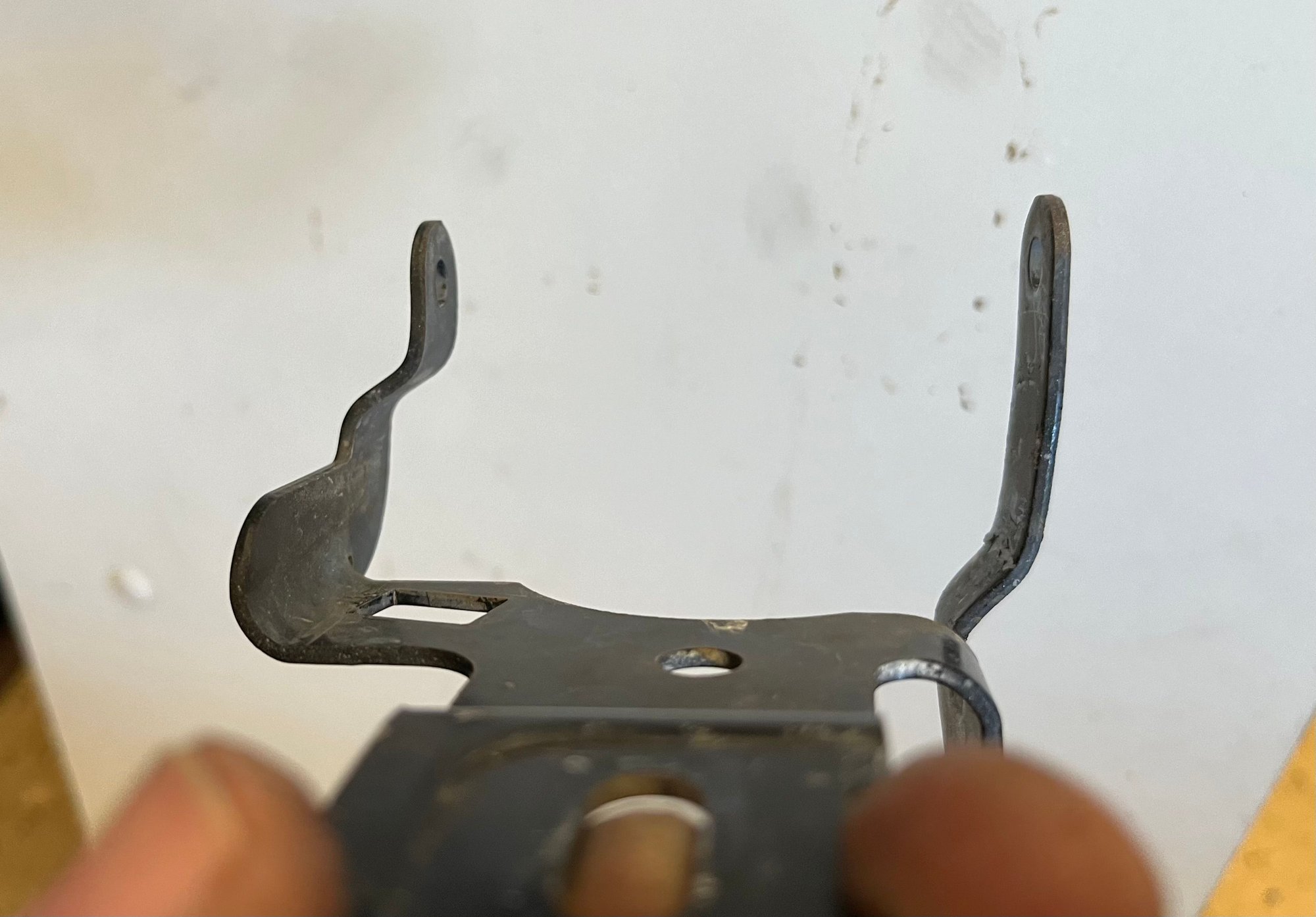

I was planning to make my own bracket, but the fog light mount was easy to modify. I started by making a small “L” bracket with heavy gauge aluminum and used the top mounting point on the light.
The inner arms of the brackets have to be bent out, to make room for the width of these lights. On this pic, the right side was bent out and made parallel to the other side. I debated inserting screws into the side of the light, but the top mount is secure enough to prevent movement. The side arms are snug against the light as well.
With everything assembled, note how the L-bracket I made is angled forward. This is required to have the light sit horizontal to the ground. The small bolt uses an existing hole in the mounting bracket.

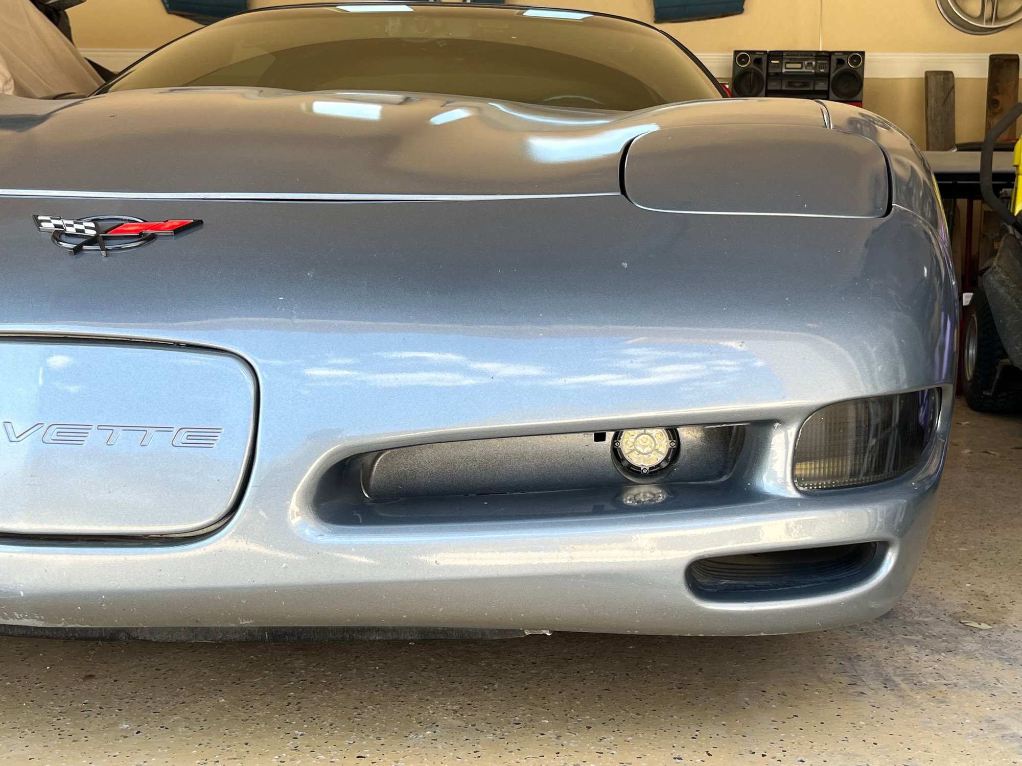

Here is the finished look on the car. The metal screen is supposed to be stainless, but I painted mine, and it can be removed as well. I figured it may help with some larger rocks.
Finally, these are powered by a wiring harness I made, similar to what I did for the headlights. Power from the battery to a junction with a fuse and 10ga wire, then 12ga wire to the relay and the lights. I measured 11.69v to the lights with this setup. The stock high beam wire is the trigger for the relay.
I’ve had these on the car a couple weeks and everything is holding up. The lighting does help, but it’s not the focused light I really would like to have. In a few months, I’ll probably swap out to something different. Right now I’m leaning towards the Hella 998570021 60mm high beam, with a high lumen LED.

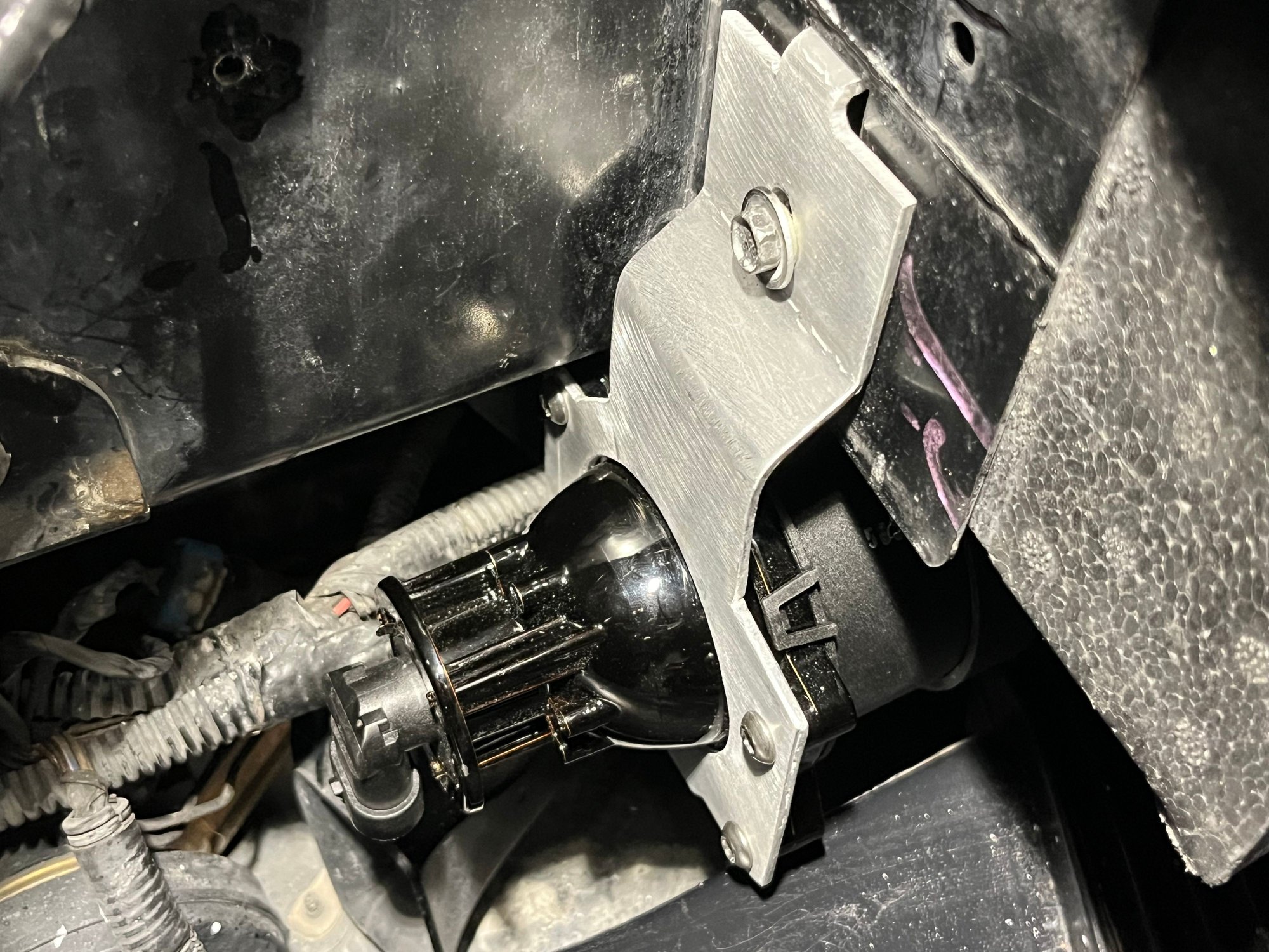

I finally installed the Hella 998570021 60mm high beam lights, in place of the lights shown above. Maybe not a popular thing to do, but I’m very happy with the results. These have added the range and intensity I was looking for, almost as good as what I have in my modern cars. The lights come with 65w Halogen 9005 bulbs, with a yellowish color. I planned on swapping for LEDs and spent a little more than planned , but my night visibility is very good now.
This was a little more work to install, because I had to make mounting brackets for the lights. I drilled a 2.5 inch hole to mount over the back of the assembly and then made a few bends to get the position correct. The top inside corner is cut to clear the frame, and the bottom outside corner is cut to clear the brake duct.
Traditional 9005 bulbs have the 90 degree turn down (pictured), but this does not work on the drivers side, due to interference. The LEDs I purchased (Sealight 2024 X4I) have a wire coming out of the back, so clearance is not an issue.
The first picture is with high beams and the extra lights I originally installed, and the second picture is with the Hellas. You can see how the beam is tighter and the intensity of the Sealights has very good range down the road. Road glare is not an issue with the low mounting point and I’ll keep these on the car for good. Maybe an option for those who want to keep the stock headlights, but want to see better with the high beams.

While I applaud the ingenuity and creative thought, you NEED a projector with a sharp cutoff for this light position. It's simply too close to the ground for even a properly aimed pencil-beam light to be effective without blinding oncoming traffic. I used to use the Hella 60mm high beam projectors in our SLC V1 headlights. There is no way that you can run these at night and not blind every driver looking at your front-end.
