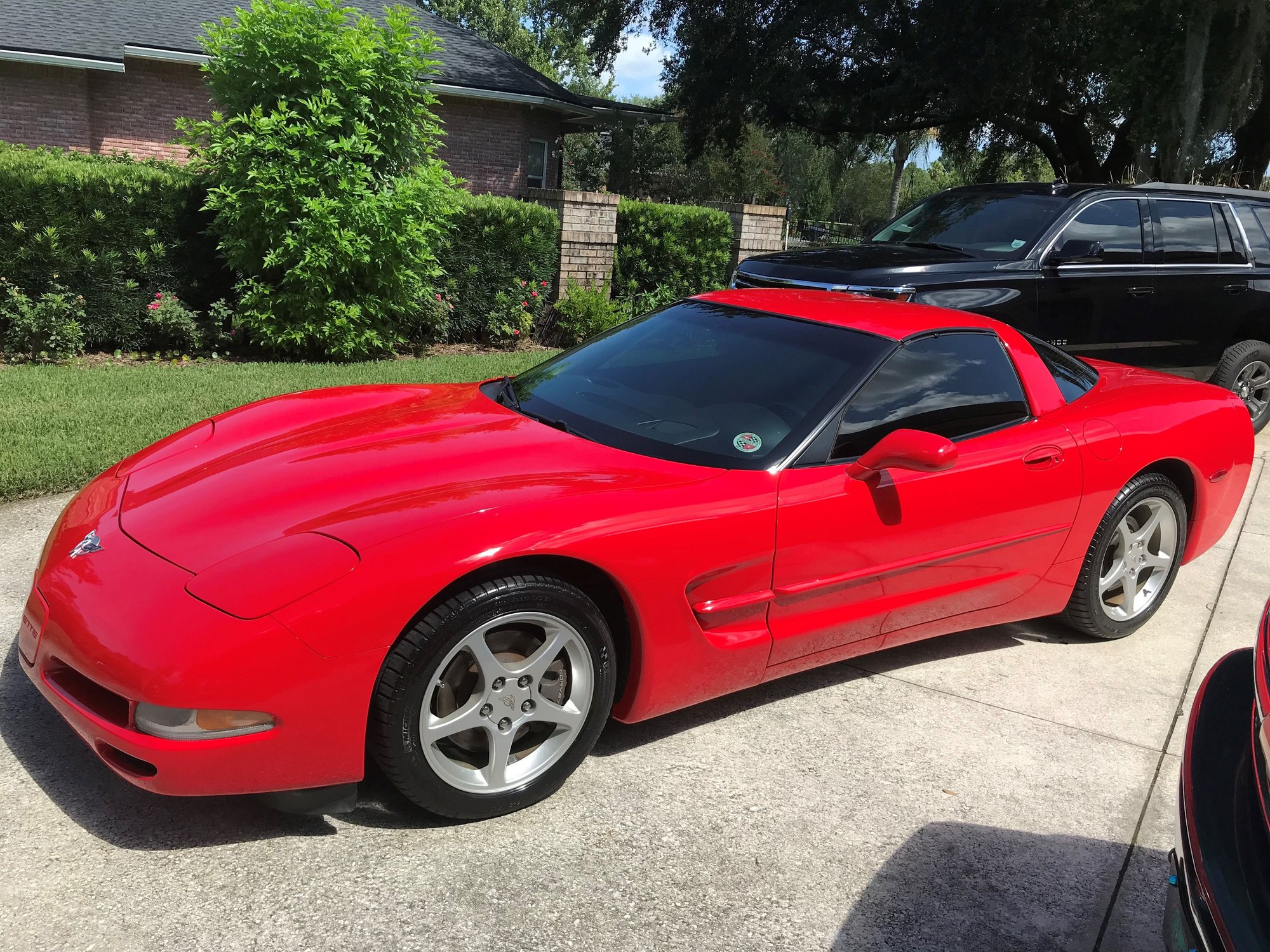

Ive had my C5 Coupe tinted as soon as I got it. No issues in 20+ years. Make sure to go to a shop that is reputable. If they deal with high end cars then you're good to go.
There's a few pics in my garage folder in my profile if you want to check out.

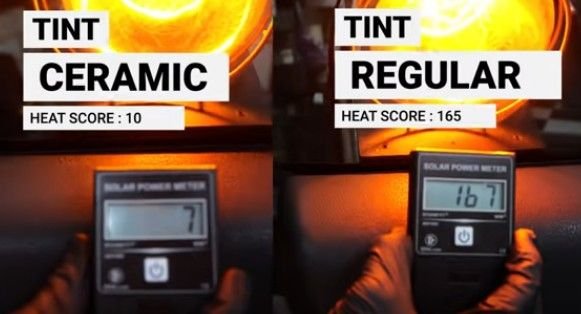

Get it done at a high end shop as suggested. I STRONGLY recommend you get a ceramic tint. When I had my C4 back in the early 2000's, the shop did the rear window using one piece of film.

Yes, get a good ceramic tint

I put ceramic tint on my 1971 Camaro and couldn't believe the difference in the summer.

You baby is gorgeous! I have a millennium yellow vette also. What tint did you get?

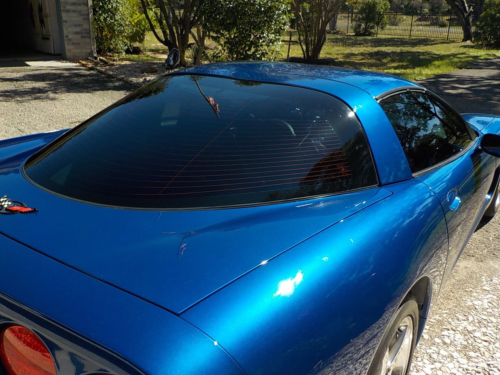

Recommend the same....use a reputable shop for install & ceramic tint.
The good shops will warranty their work if that is important to you.
However, if you want to save a few bucks, some shops will do for less by cash-in-hand & no warranty.
I went a little too dark tint on the hatch...it's ok & I'm fine with it, but with the Lemans Blue it appears a bit too dark esthetics-wise (to me).

I went 20% on the hatch & 30 or 35% on the sides. Remember, the lower the number, the darker the tint.
Like I said, I wish I would have done the hatch the same as the sides just cause it looks a little too dark to me...from the outside, if that makes sense.
Consider that when you have factory tint already in the glass and when one adds a tint film, the result can be darker than what you see from a film sample held in your hand. Some places have tints in different %'s that will allow for that. It's been a while since I went to the tint shop so, not sure what the current offerings are. The ceramic stuff is great for solar heat control....putting clear on the windshield will cut sun heat a bunch.
*One thing else to be aware of is the little dit-dots at the top of the hatch...film doesn't lay down around those little guys very nice. My tint guy said to work on those for a couple days after application in the sun and should be able to close those things up a little....he was correct. Use a wet microfiber and firmly press around each and every one and it will minutely stretch the film closing much of the gaps...not perfect, but better.

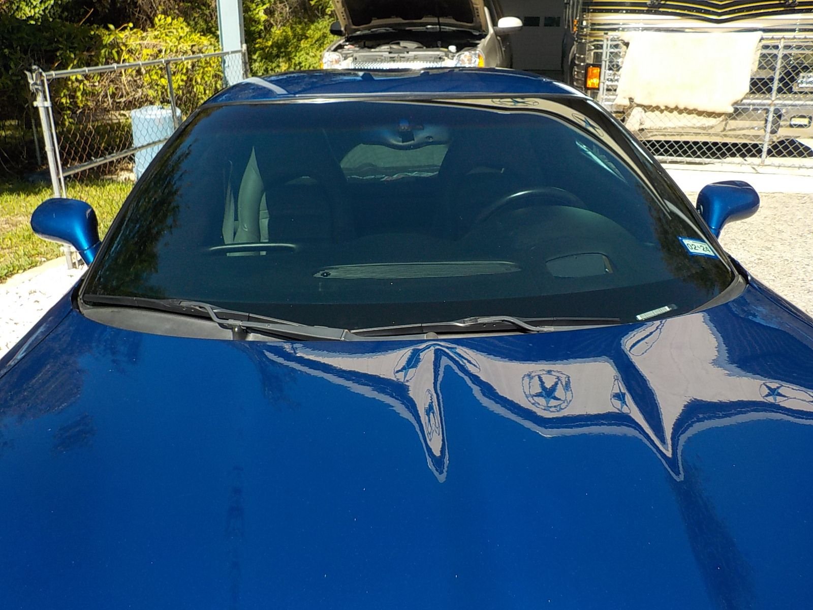

Find a https://www.xpel.com/ dealer installer. Did my C5 in their Prime XR Plus 30% on all glass except windshield. Windshield got Prime XR Plus clear.
