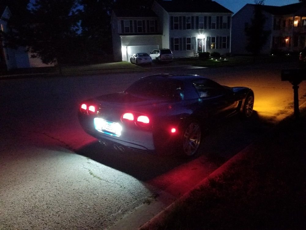

Buy a hyper flash harness that you install underneath your steering column. This will prevent all LEDs from experiencing hyper flash. I updated my corners, side markers, and rear tail lights and do not have hyper flash.
Here's one from Forum Vendor Sharp Light Innovations, aka Radio Flyer. This is the same one I've been running for 10 years.
https://sharplightinnovations.com/sh...rflash-harness
