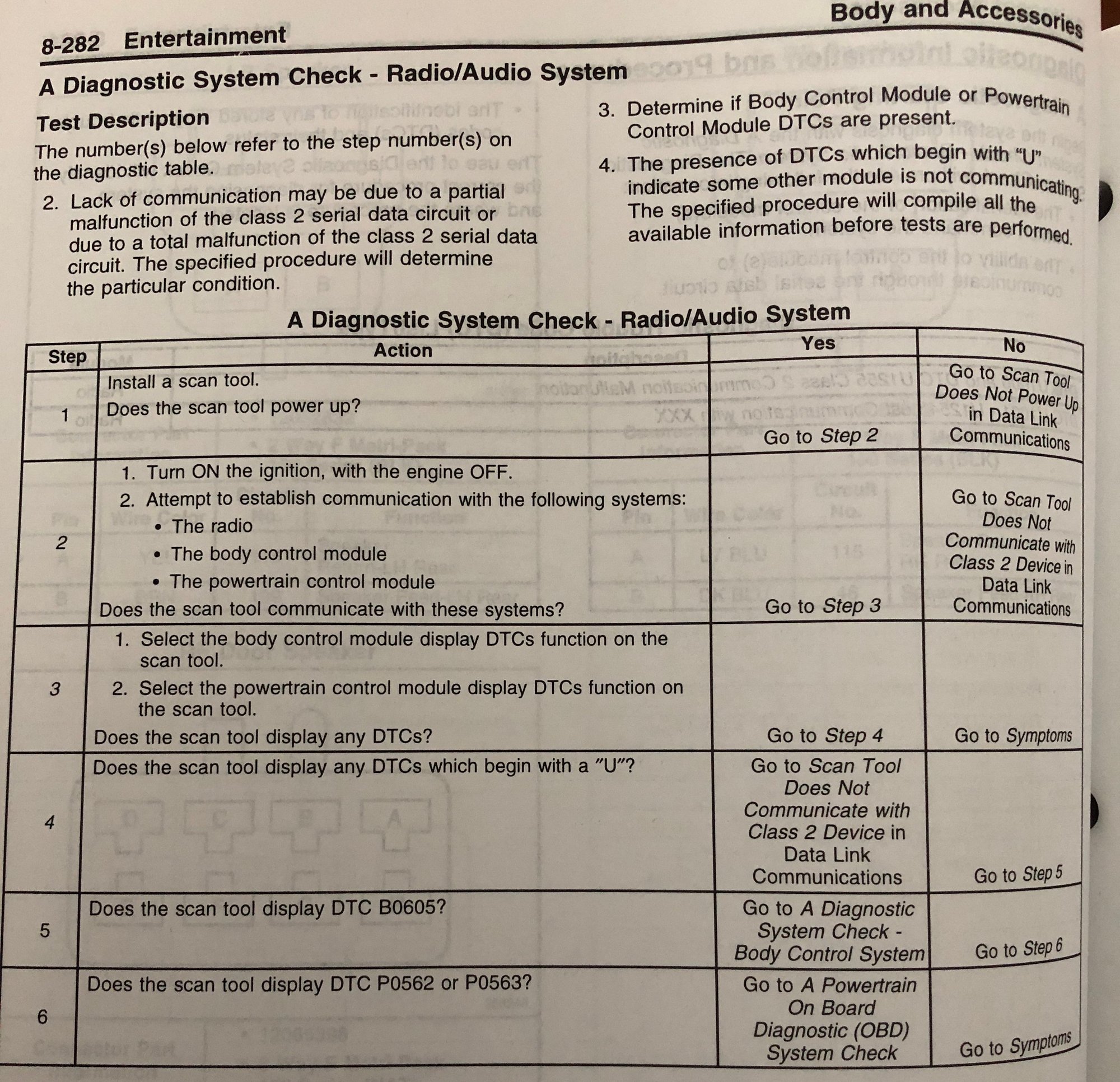

Here is the troubleshooting process from a 2000 model factory service manual. Your 03 might be different but it seems likely a scan tool will be useful.
