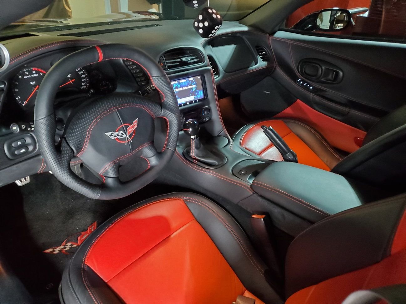

Anyway, here's a few pics of c7 seats-- this is with custom leather and foam from a local uphoslterer to match the rest of the interior I had done, black/red/red stitching

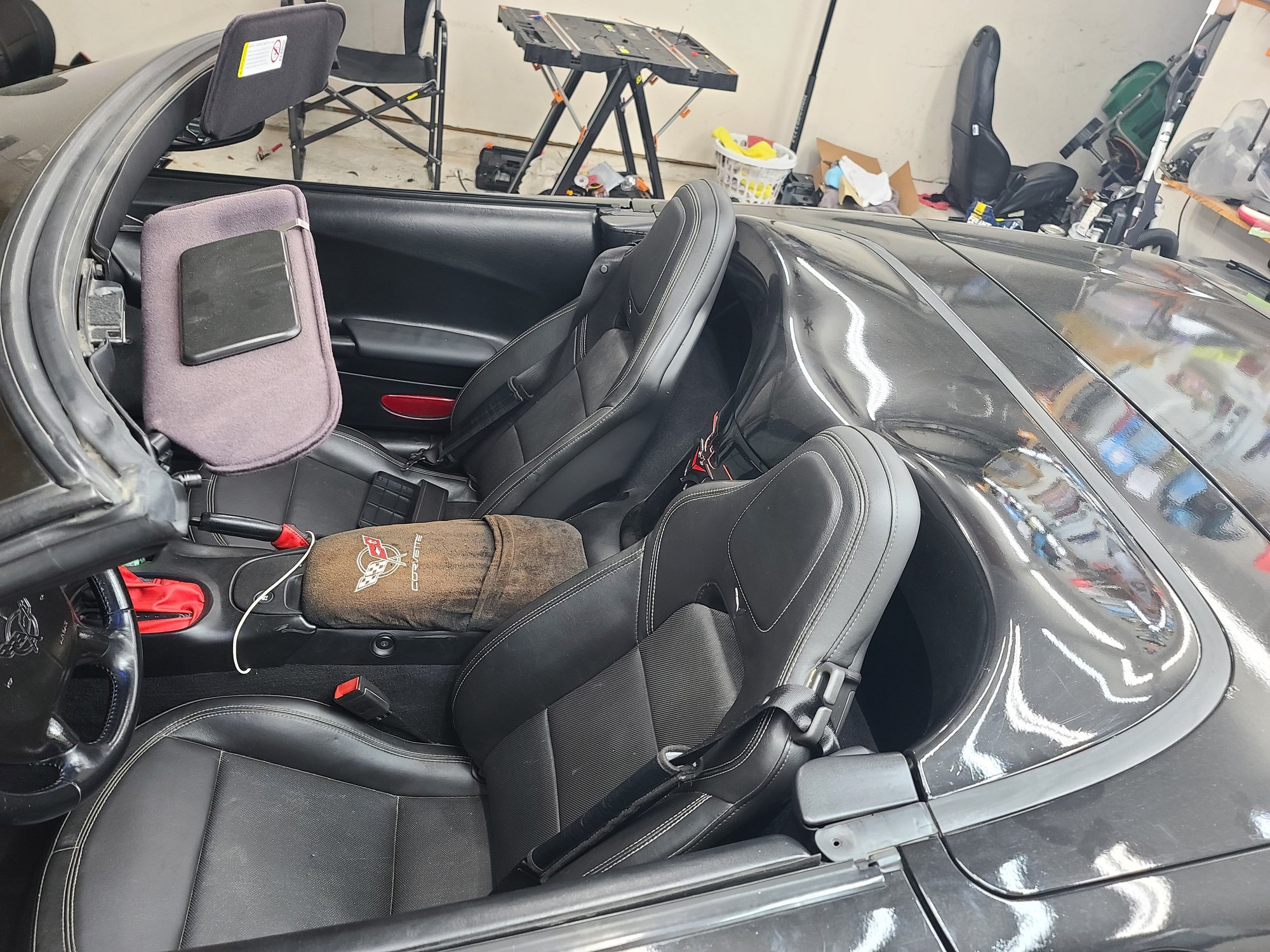

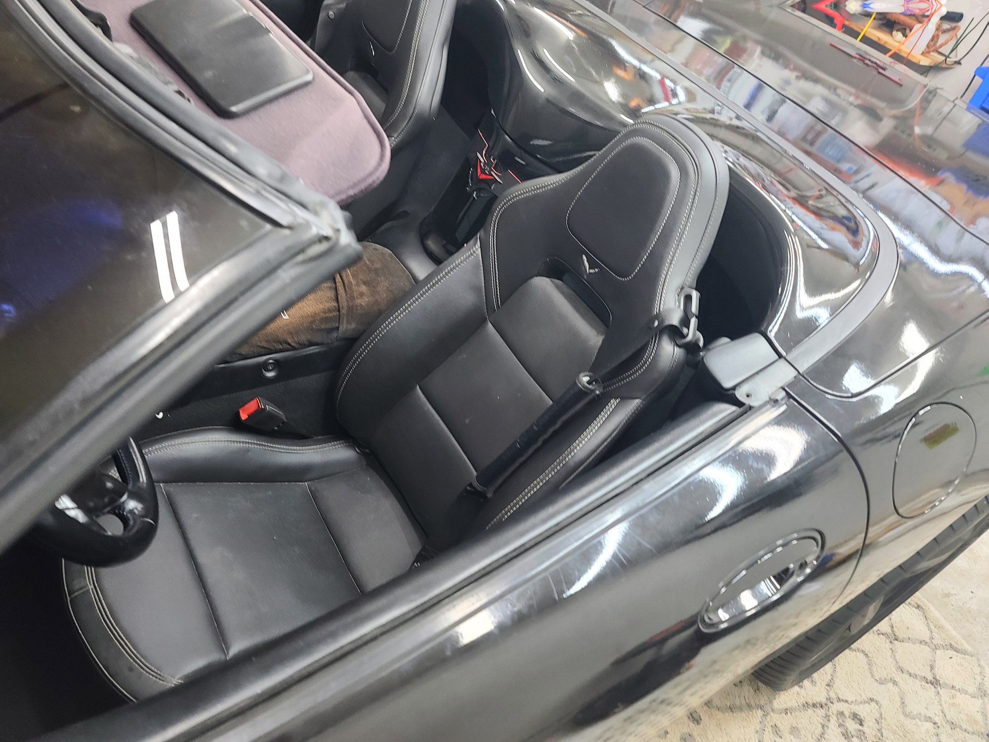

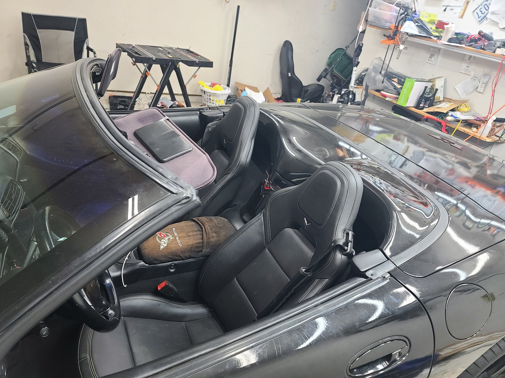

Shop around. I looked at so many online posts for anywhere from $700 to $2000. Patience is your friend. I got these 2016 for $400 from a junk yard 20 miles from my house. They were covered in dirt but once I got them cleaned and installed they have changed the car totally.
It rides so good! My fat *** stays in place and the fans keep the sweat off my back. It adds to the fun at speed too. I do have to fold them both forward to get the roof up and down but I never want to drive it with roof on.

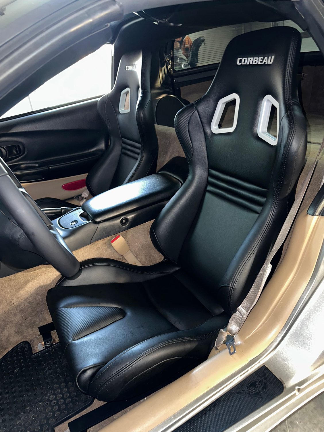

I did the Corbeau Evo-X, and as they say, no regrets.
Went with this same option myself…love ‘em!
