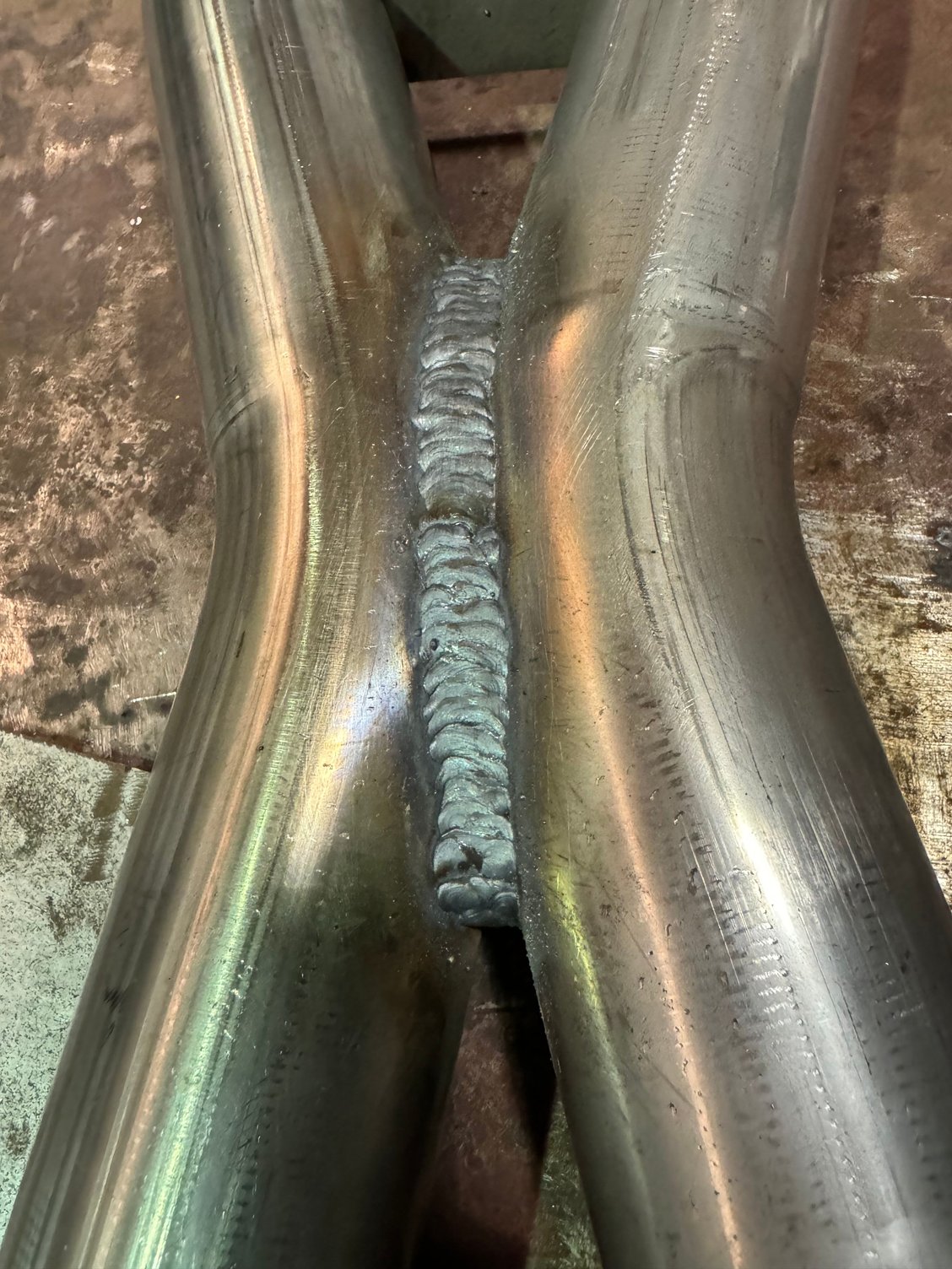

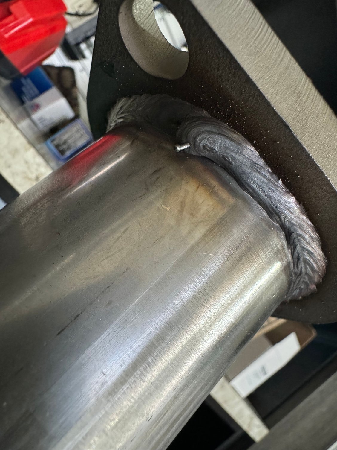

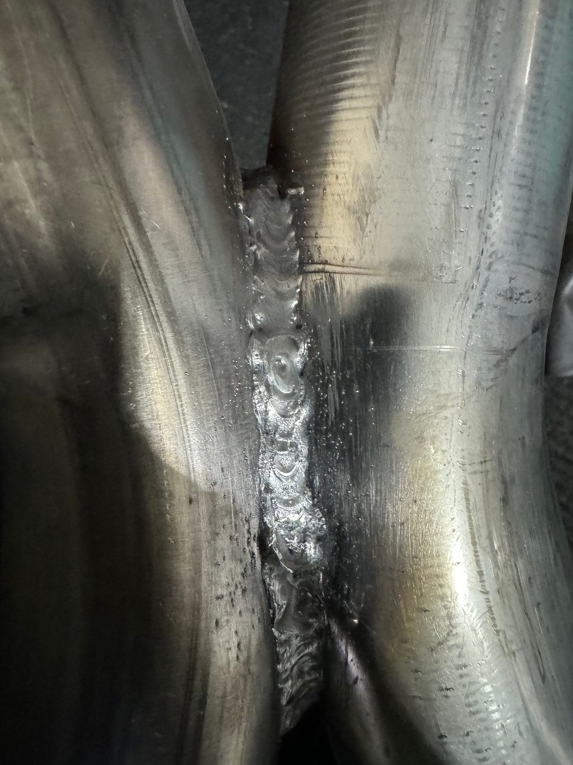

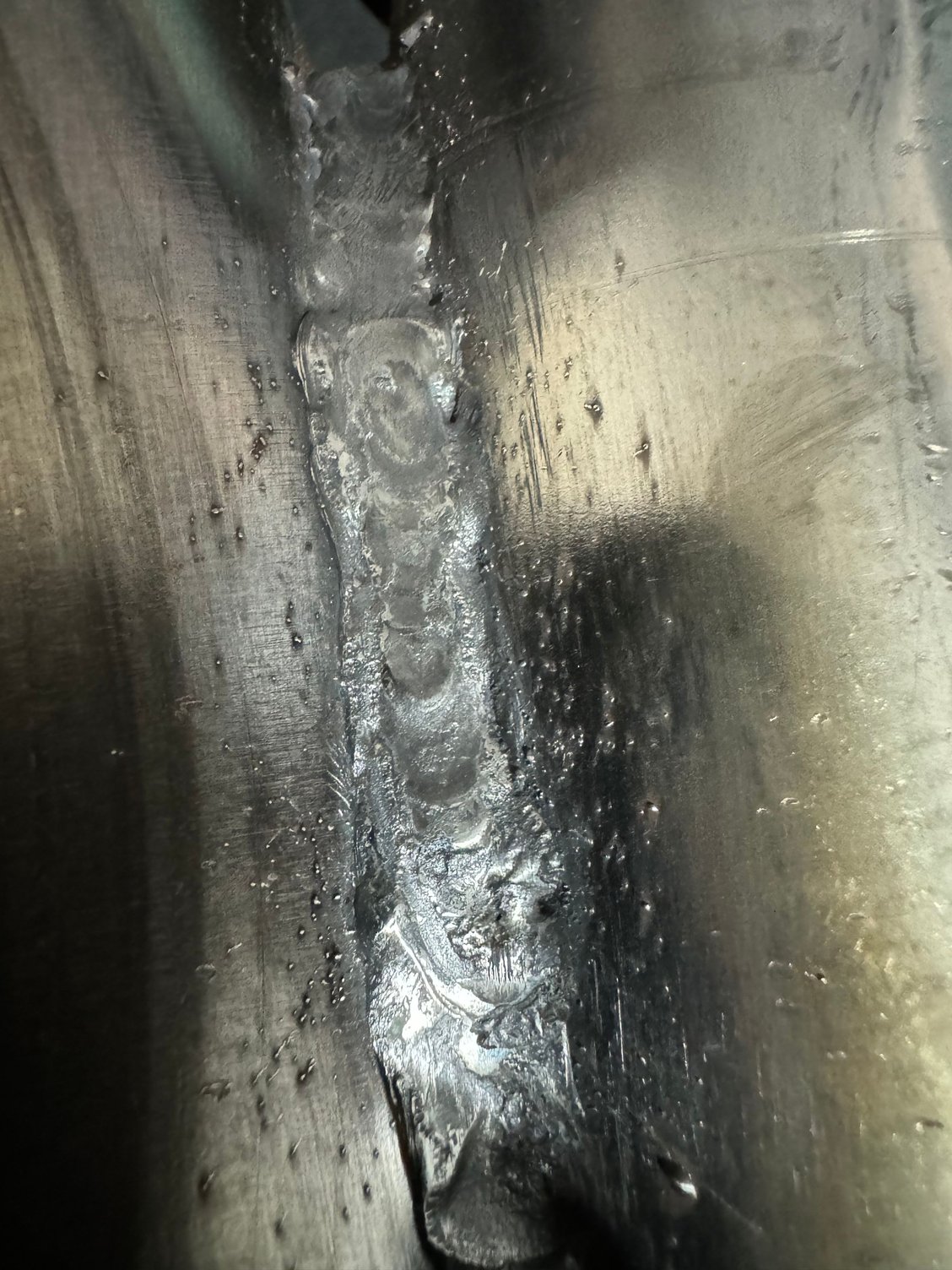

Purchased a brand new X-pipe and the welding is absolutely embarrassing. At least 4 pinholes at the merge that I can see with my naked eye. Nice big weld wire tail sticking out of one of the flanges. Thank god I can weld better than this and will fix it myself. Hesitant to buy an exhaust from them at this point.

That does look like some poor quality welds. Have you contacted Borla about this and given them a chance to assist you with this?

Atypical given my experience with them. I have had 3 different Borla exhausts on my C5s over the years and always been pleased with product quality.
Send em back.

That’s ugly

Just touched it up. Didn’t have time to send it back. I have an inspection on Monday. Not the prettiest thing but atleast it won’t leak.
