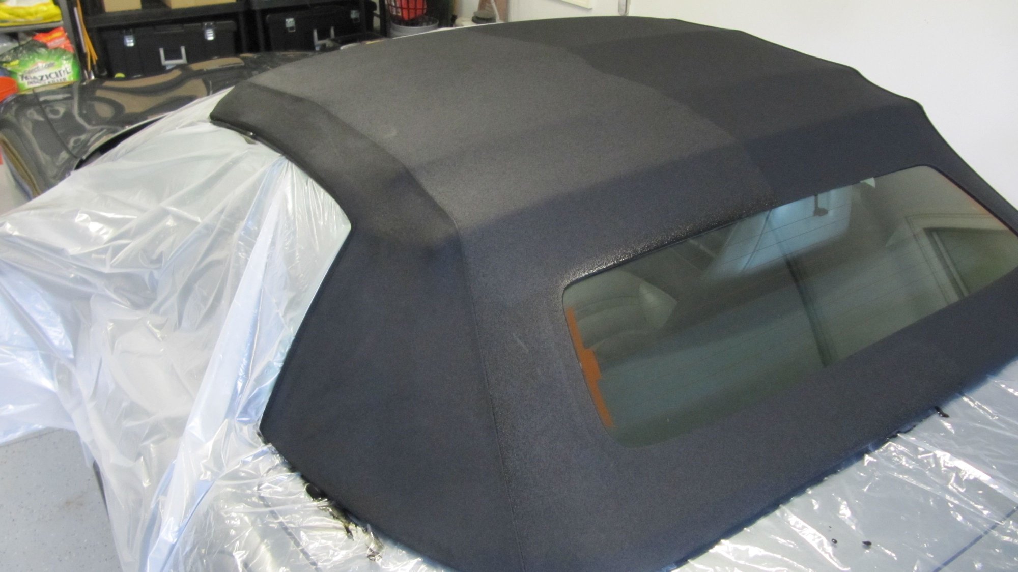

In 2016, I tried Renovo Reviver, which is made in the UK.
The process went well. The top got a little darker, and the color didn't show any brush strokes. It's been nearly 8 years and the coating has not gone sour in any way. It did not, however, get rid of the dreaded "stretch marks". This was when I figured out that the fold marks on a top are the result of losing the velour-like "fur" in those places. The marks aren't discoloration, just a more reflective surface.
If there's a product out there that can solve that, I'm all ears.
Left side done
All done
Dried and fold marks still there
