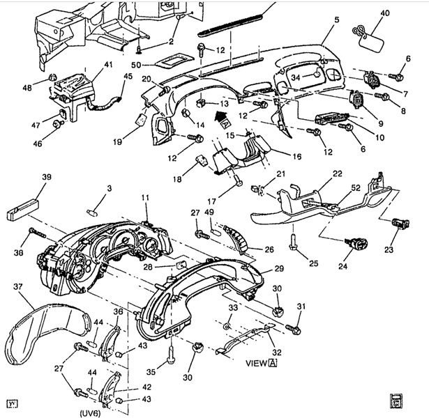

Looks like both of the screws that attach the gauge cluster to the dash hood are missing. The whole cluster is loose.
Could someone possibly pull one of these and take a pic of it and give me some dimensions? Or, does anyone have a part number?

Almost (but not quite) all parts are identified for the looking in the C5 Parts Manual.pdf, which a fellow member recently reminded the location:
https://shelor.net/Z/CorvetteForum/Docs/C5-PartsManual/
It's a bit of a tomb, and does not work well on a cell phone, clearly laid out for a full PC or laptop.
Anyway, the top screws going up through the IPC into the dash are GM 11515439, SCREW, PAN HD W/WA, TORX, M4.2X1.41X20, NO (INST CSTR LENS)
Thank you VERY much. Apparently it's the same screw as used for the cluster bezel in a Pontiac Aztec. Who knew!
Found a pack on eBay.
