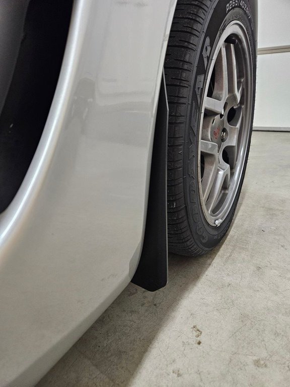

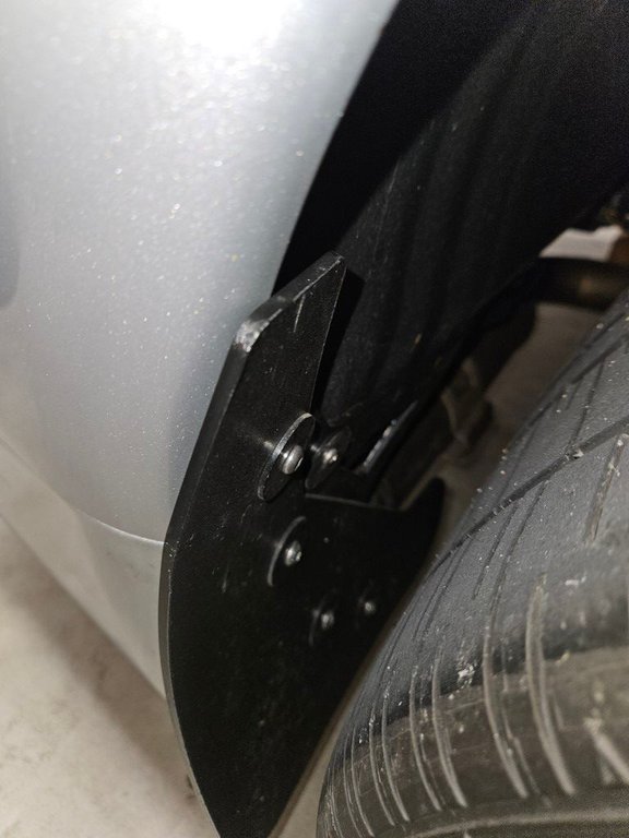

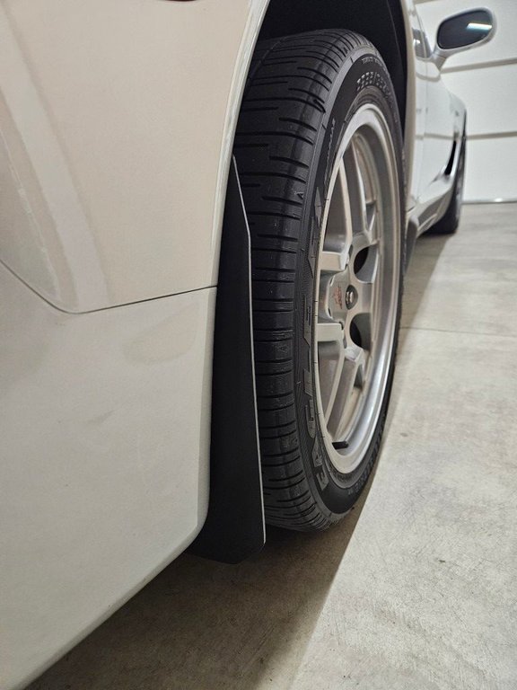

RokBlokz
I have these no drill on a Jeep and they did good so bought the C5 version.
I like no drill and minimalist design. If you look for them they are there but blend in well enough for me. I wanted protection on the lower portions of the vehicle.
The bolts and screws are either using factory locations or are mounted to a sub-assembly supplied with the kit that allows the actual flap to sandwich to the curvature of the rear body panel lip.
The last picture is the front using factory screw locations.

Thanks.....Yes the Rears do have 2 screws and looks like this kit , utilizes the 2 attechment Screws in the Rear to attach an Additional Bracket to allow for attachment points to be added. Do you have to remove the plastic liner in the Rear in the wheel well to attach the secondary bracket?

You do not have to remove the inner fender liner but will need to remove the wheels to get good room to work. At least in the rear fronts you can just turn.

The Rockbloks bolt to the fender wells to existing hardware. They give you stainless screws that are longer to fit the flap.
The rear they give you a mount to bolt to existing bolts to hang the flap from.
Many no drill flaps take a spring clip with teeth that digs into the fender and can shift on you.

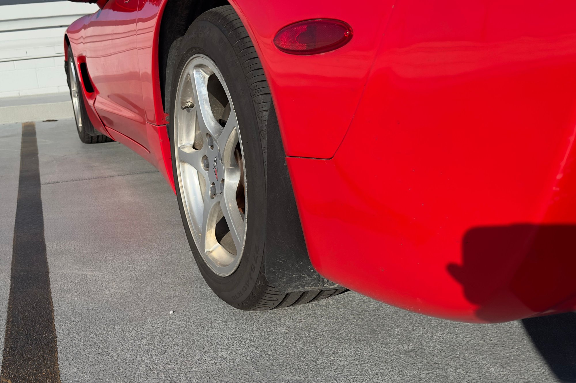

Default Love these Rockblokz
Love these Rockblokz! No drilling, look steathy, and keep the mud off the car.
