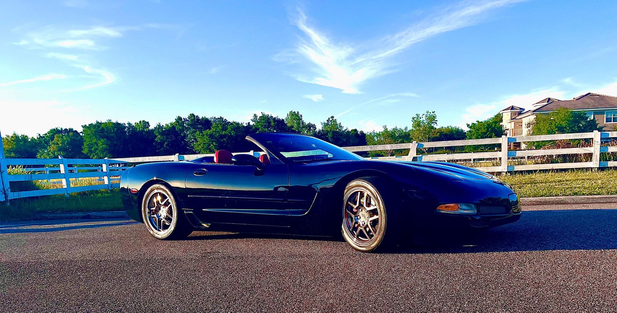

Hello, new to the forum and just got my first C5. Just wanted to drop a few pic of her. I do have a question. My steering wheel locked light cam one and the 10 second warning as well. What's the difference between the LMc5 bypass and the top flight bypass except 50 bucks!
