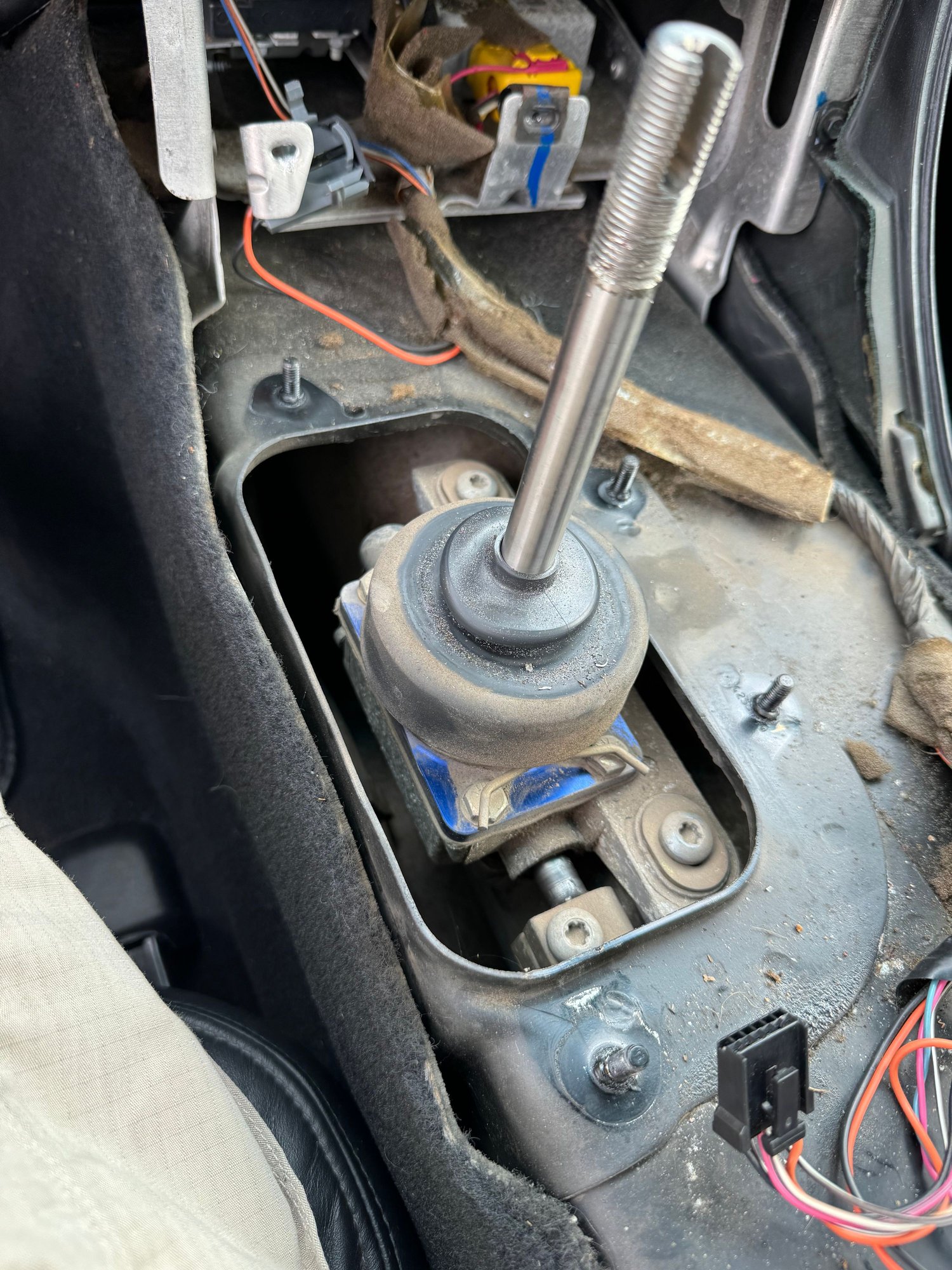

Hi all,
In the pursuit of learning more about my Z06, I here to see if anyone can shed any light on this.
the previous owner said that car has a Hurst shifter, but it doesn't look like any of the Hurst shifters i see for sale. So, let me know what you think...
Is this a Hurst shifter?

No............

Looks like a B&M Ripper to me.

Yeah, it has a goofy boot over it to dampen some of the noise and vibration, that's why it looks odd. If you send me your box to upgrade along with the pivot bushing it will feel 10000X better and it won't rattle or vibrate near as much. This is the best possible option for that shifter.
I agree!

B&M
If you like it, cool. If not, we have suggestions.

And since you've declared a perspective.... B&M is my least favorite of all shifters for the C5 including stock.

the photo you are showing is one of the older MGW shifters. I have that same shifter with a TMod tub in my 2002 and could not be happier. It did take a little learning curve on my part since it was so different than the stock C5 shifter and tub.
Once you develop a feel for how short and precise the throws are you will wonder why everyone does not make this modification.

Just a FYI I have the same shifter on my 04. It was pretty bad when I first got my car. I thought that's just how they shift. So when I was changing the radio over to a double din I found that the tunnel cover was ripped and that I had an aftermarket shifter. So I removed the shifter and found that there was litte to no grease on the shaft inside shifter box. So I greased it up and shifting became much better. After that I did the anti-venom mod. That really made it shift much nicer. It's now very easy to shift especially if you let it Rev up a little and don't try and shft at 1200rpm. Those two things are very easy to do and cheap. If you don't mind spending $500 bucks or more just get the shifter and a new box.
