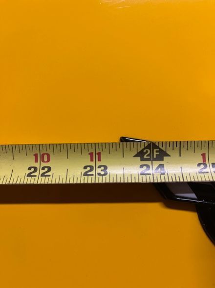

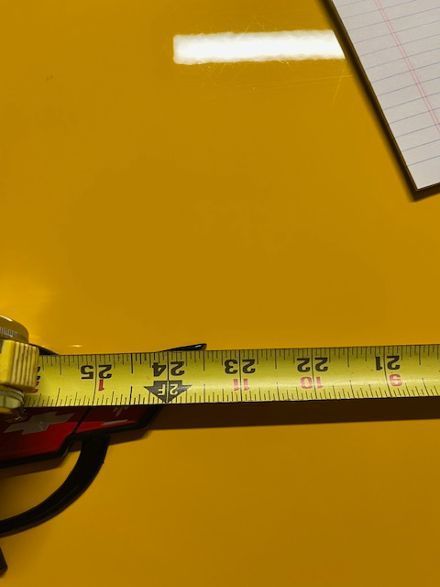

I am having the trunk panel on my '99 convertible painted. Can anyone give me the measurements for applying the corvette emblem in the factory correct location for this panel? I would assume the C5 Z06 and fixed roof models would also have the same emblem placement if any of those owners can help. Thank you!

23.5 from trunk edge to top corner of flag on both sides and 1.5 inches from trunk lip to bottom of flag post.

Excellent job of showing the emblem position.
