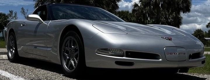

these are the stock two sizes and are polished aluminum, and add these, a z06 sway bar up front and in the back, and z06 shocks all around, leave your base springs and you will be all smiles. you would have to do something really crazy to get the car sideways with these on there. now you have to choose the tires, i run summer tires and i can feel the difference when the roads start getting cold so balance that in to the equation. i have all season michelin super sports on the base polished rims and summer tires on the z06 wheels
i also run non-run flats and have a GTO space saver in the trunk

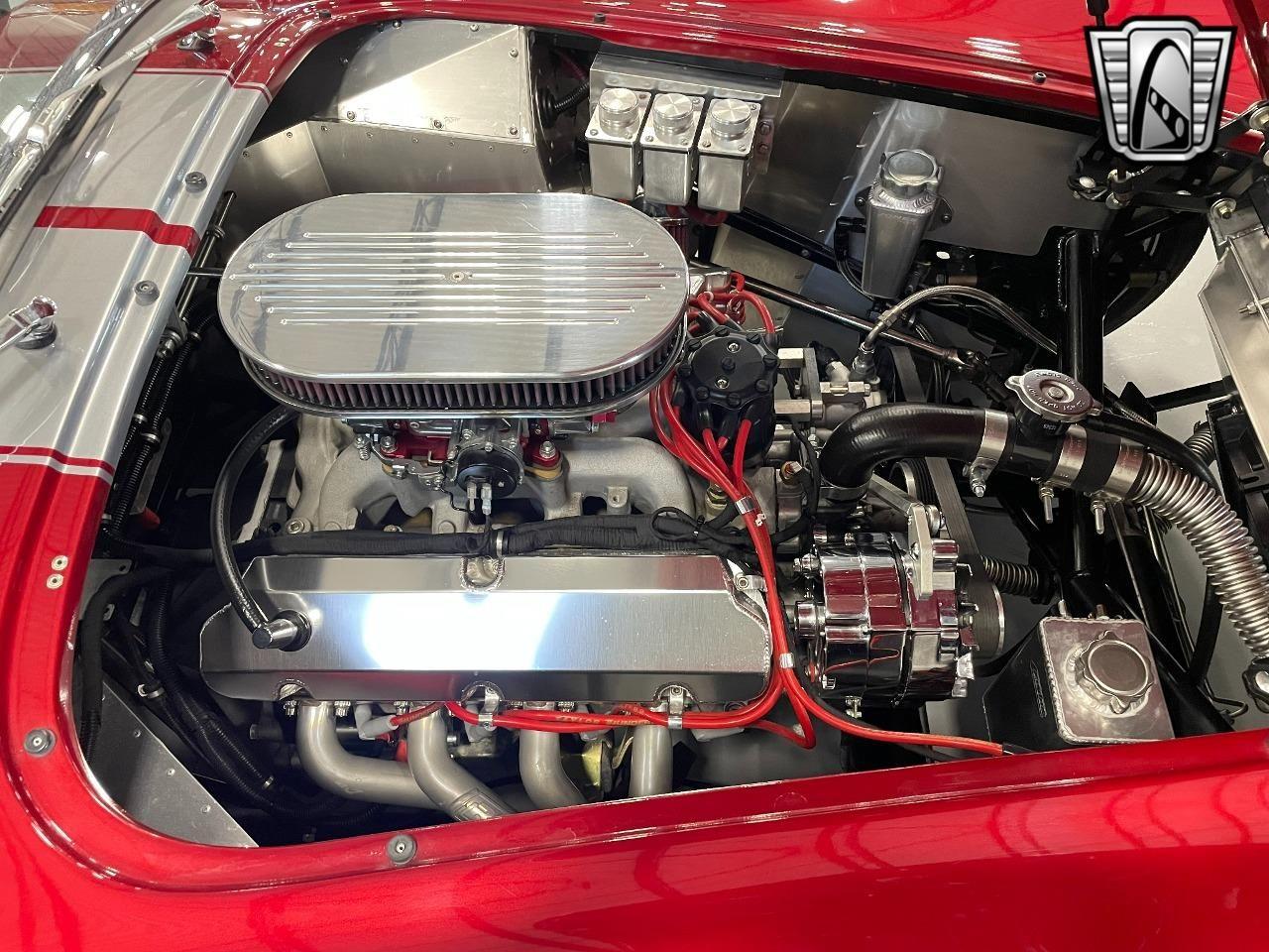

post a picture of what you got, I like the cobra too
