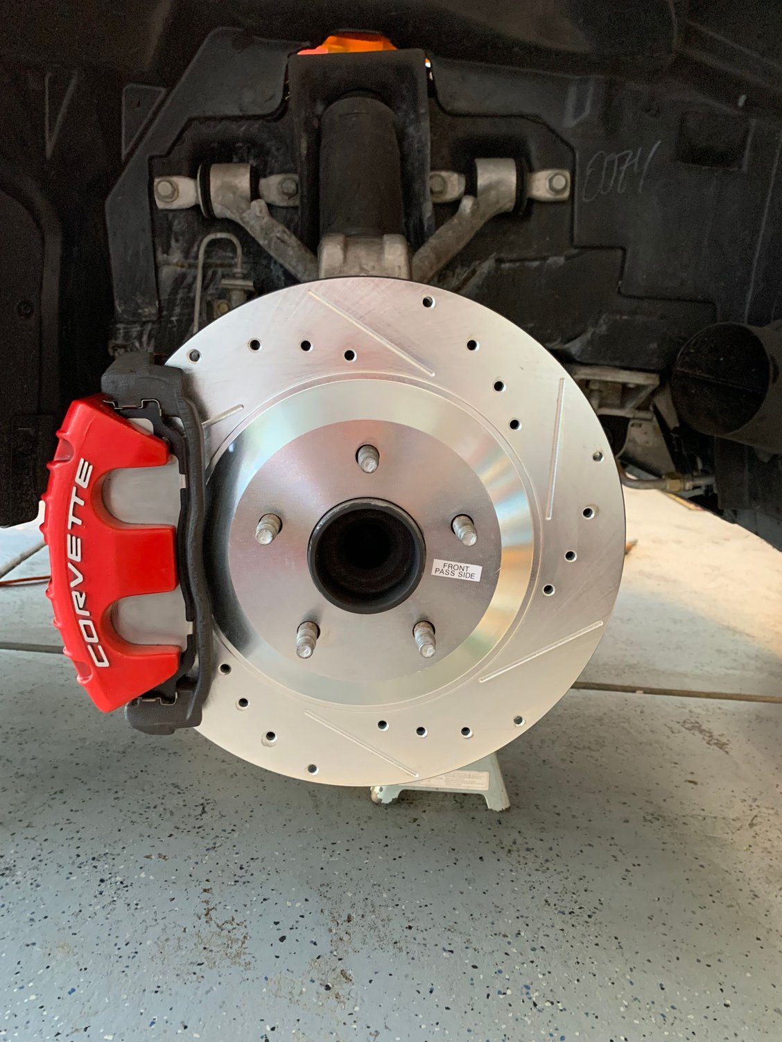

Greetings,
I am looking to replace the brake disc rotors on my 2004 C5 base model. I want to install slotted and drilled rotors, but I want to retain the original calipers. I am looking for a set of rotors that are coated were the center hub will not rust. Any suggestions as to a decent set of drilled and slotted replacement rotors?
Thanks,
Larry
