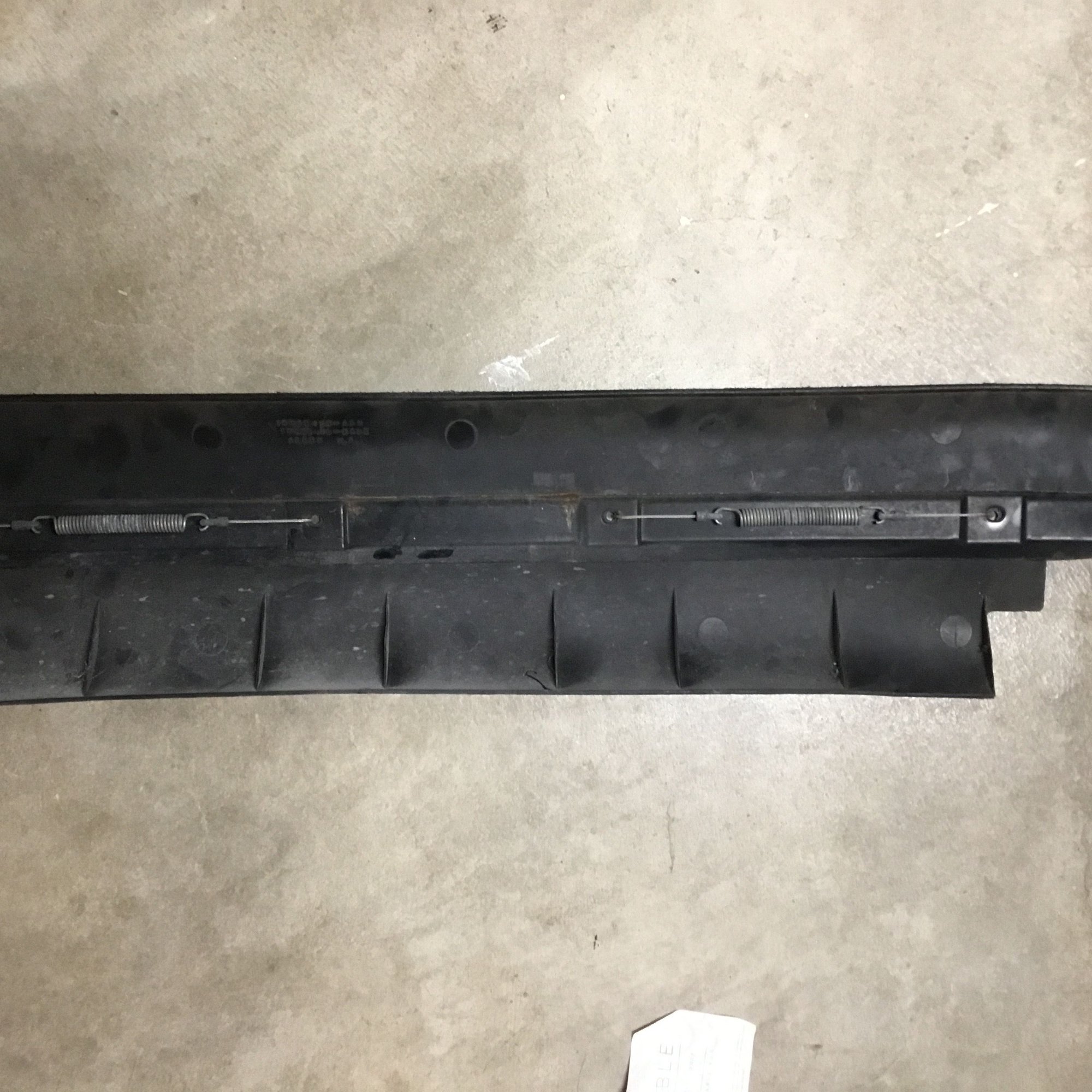

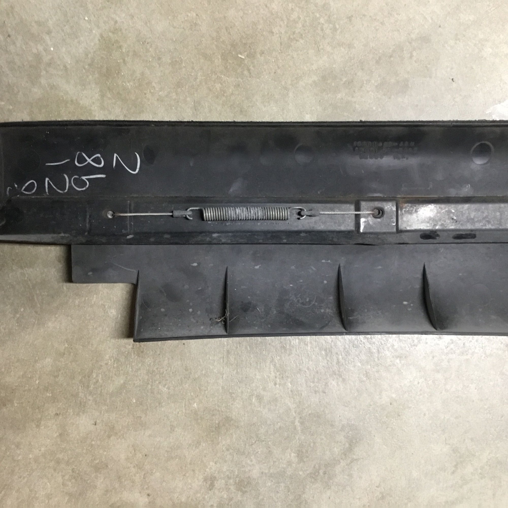

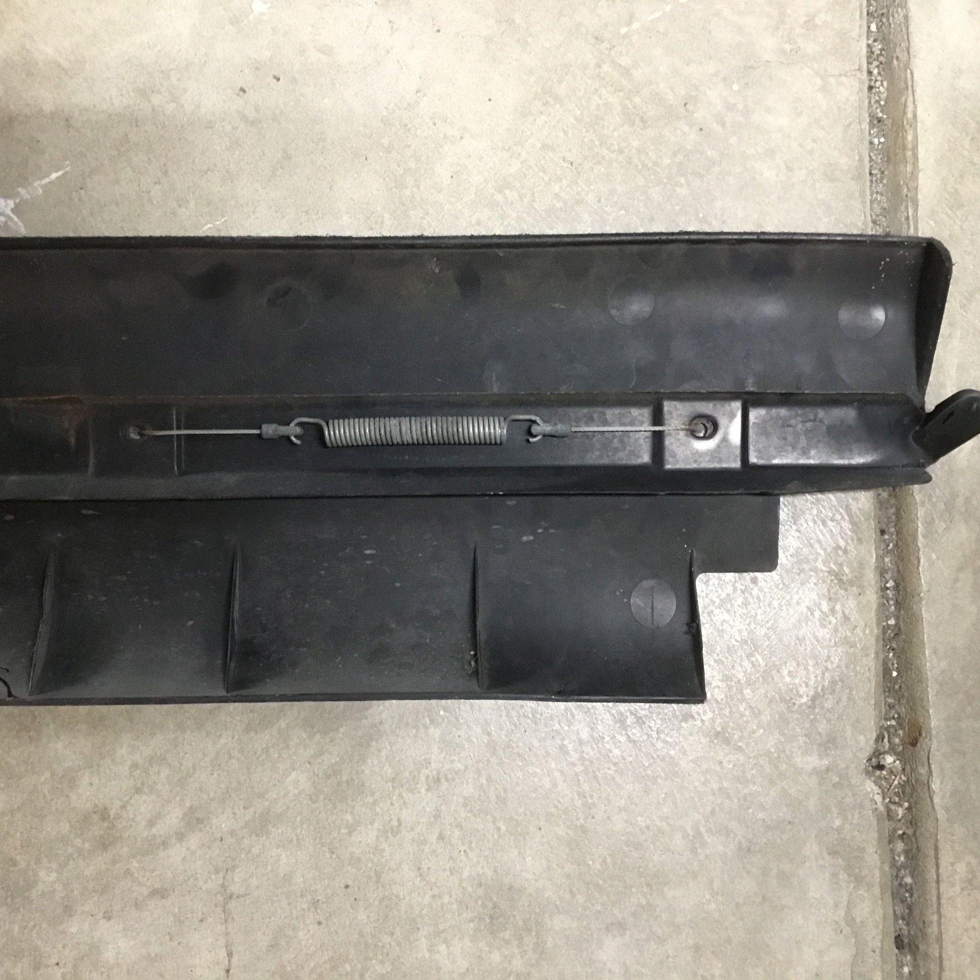

Old Jul 28, 2024 | 06:24 PM
bookyoh's Avatar
bookyoh
Joined: Dec 2014
Posts: 683
Likes: 275
From: Cincinnati Ohio
Old Jul 28, 2024 | 10:22 PM
helphos's Avatar
helphos
Joined: Nov 2009
Posts: 828
Likes: 103
From: Olney MD
Thanks, Bookyoh! I know where I can buy some springs like that, and I have some thin steel cable in my garage. I can fabricate a solution based on the pictures you sent. That's much better than resorting to bolting the air dam to the backup bar and praying I never run over anything to tear the bolts out!

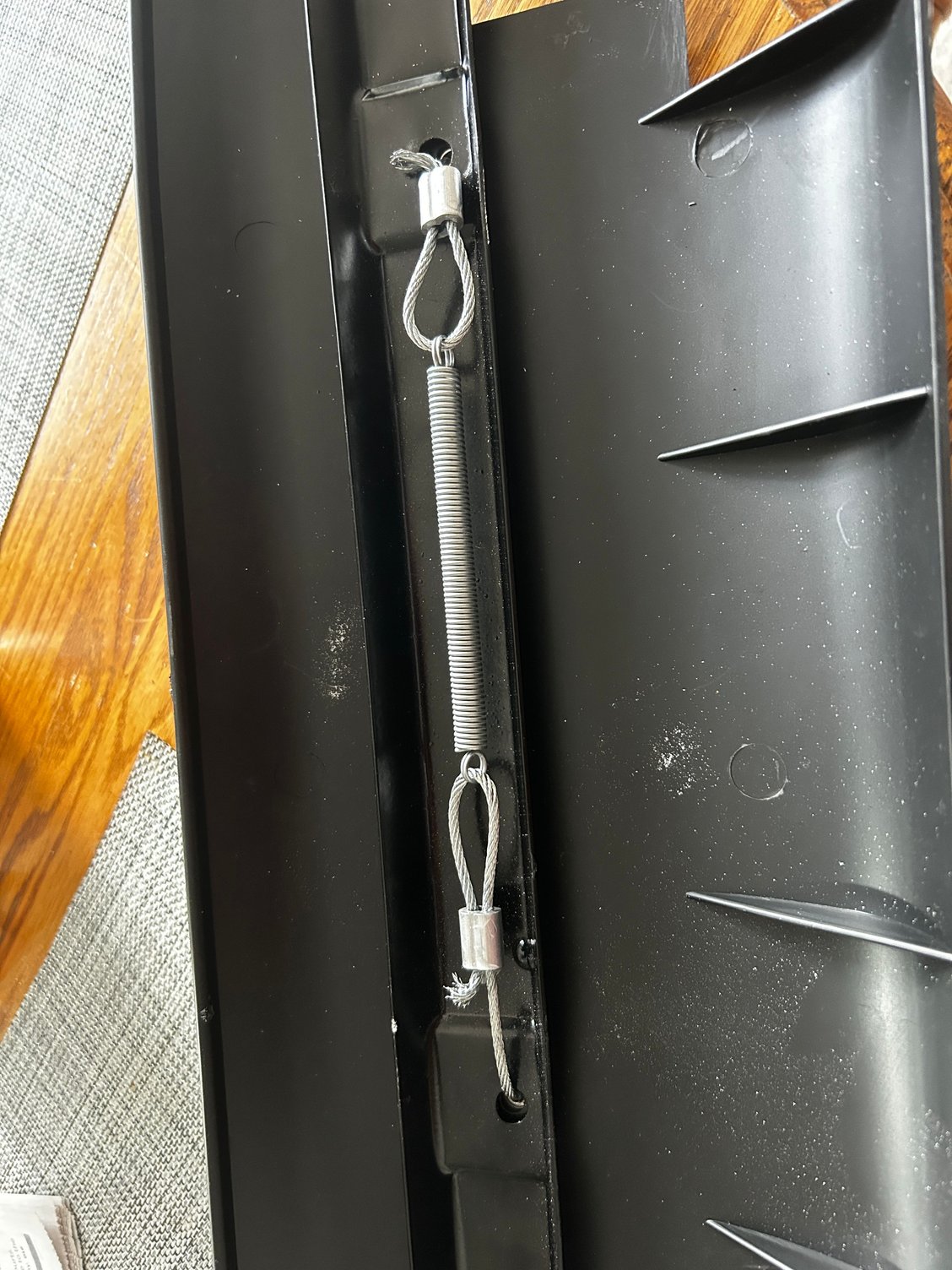

Thanks! Now that I have a clear picture of how the old springs worked, I fabricated a new set out of hardware store parts that are easily obtained. Here's one side completed.
Thanks to everyone for the helpful responses! And don't tell NCRS!

LOL. My side pieces on the air dam do the same! It used to make me cringe when I pulled out of the driveway. I'm used to it now, and the set I bought comes with new side sections.
My new air dam was advertised as having the complete hardware kit, but the package arrived damaged and I suspect the hardware package fell out somewhere along the way. My original airdam was held on by Zip ties, and I wanted to get a little closer to the stock configuration with the replacement, and I was stuck with nothing to copy and no hardware kit.
When I removed the old nasty air dam, it turned out that one side was held on my a M6-1 bolt, while the other side was held in place by a self threading bolt. Not surprsing since this Corvette had been through several owners, some of them good, and others, not so good. I bought a new M6-1 bolt just to make sure both sides matched.
I'm pleased with how my jerry-rigged spring assembly worked out. It's totally invisible from the front, but it works like it's supposed to. Once more, thanks to the forum members for pitching in with ideas.
