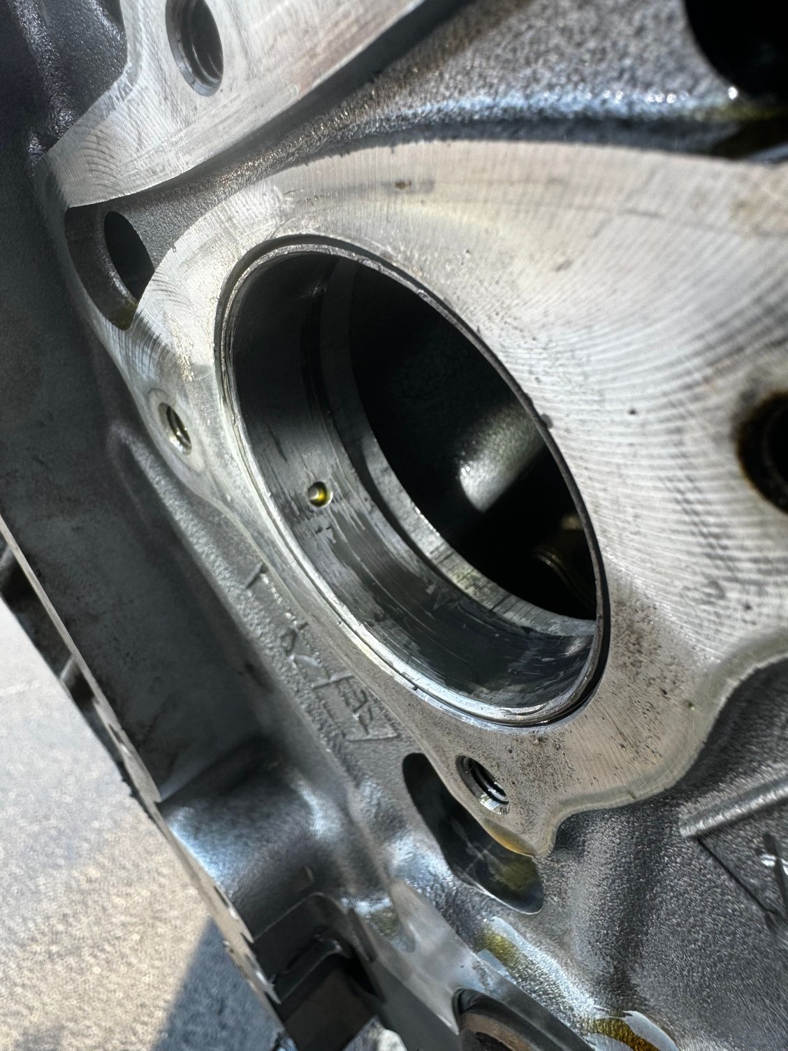

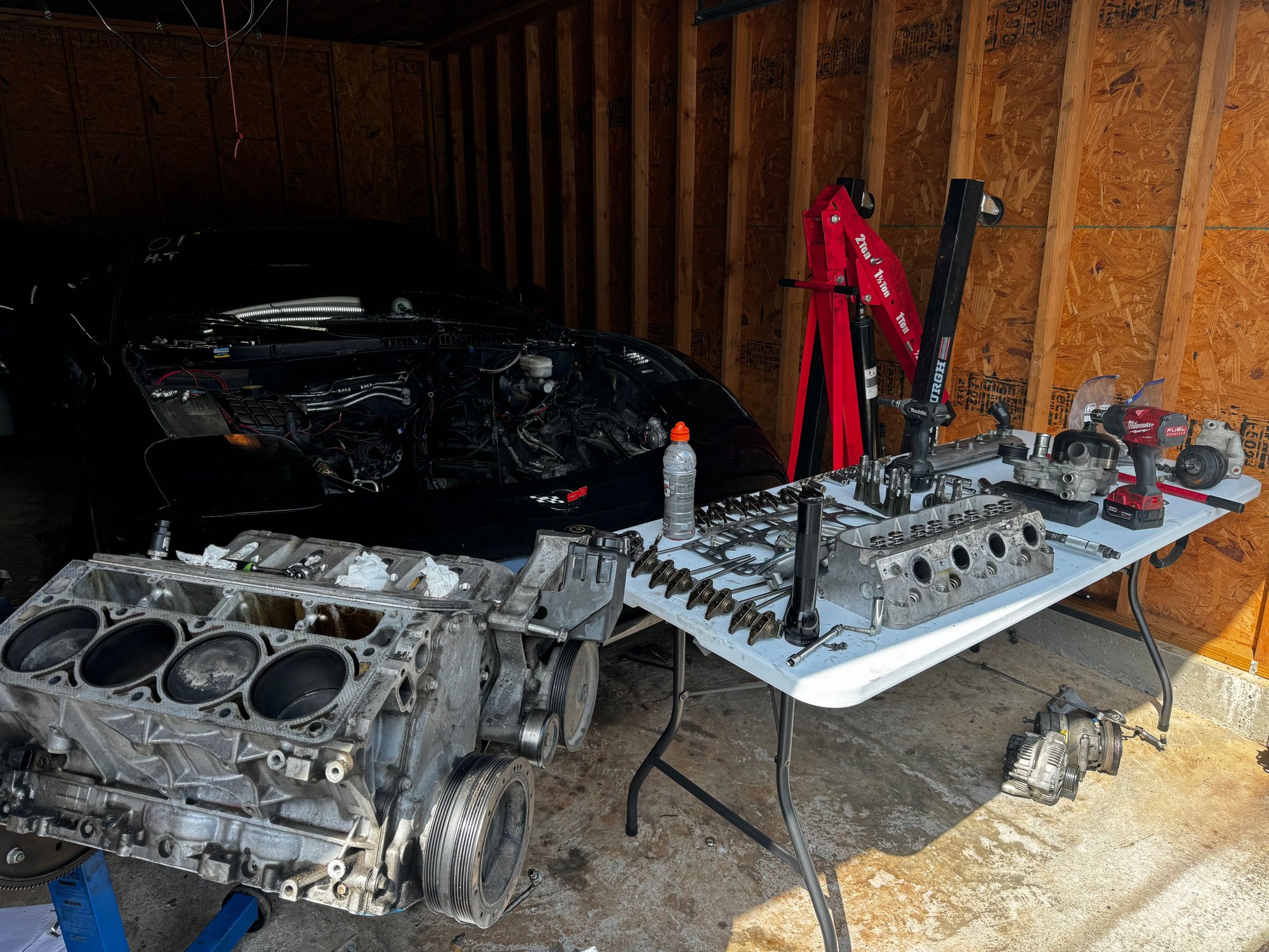

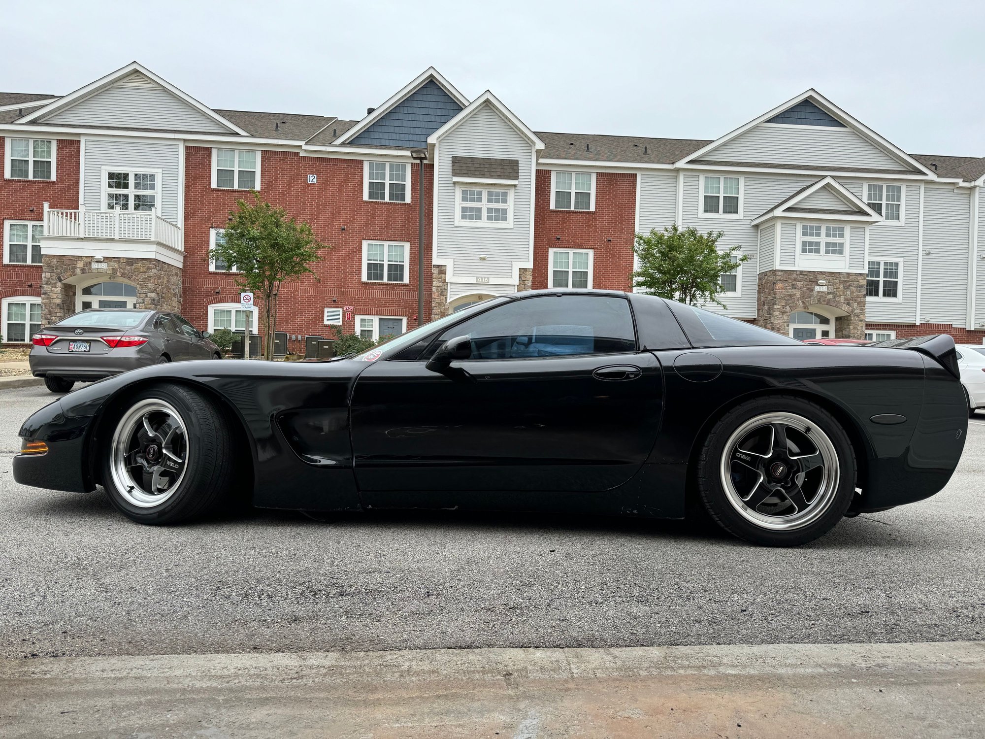

Hey I’m new to the forum & had a couple questions.
Long story short my motor is in the machine shop getting cleaned & was looking at some weight savings on the front end. I saw Strange has a front kit for the C5 and was wondering how it does street wise???
The Vette isn’t my daily but do drive it to the track & some times cruise on the weekend. Just trying to shave some ET down some in the 1/8th & figured I had the motor out why not lol.
Mods:
LS1 w/ BTR 218/224 weekend warrior cam on E85
2500 ProTorque Converter
3.15 Rear End
Nitto 300 TW Radials
Fastest ET I’ve managed to get: 1.69 60ft, 7.72 @ 89
