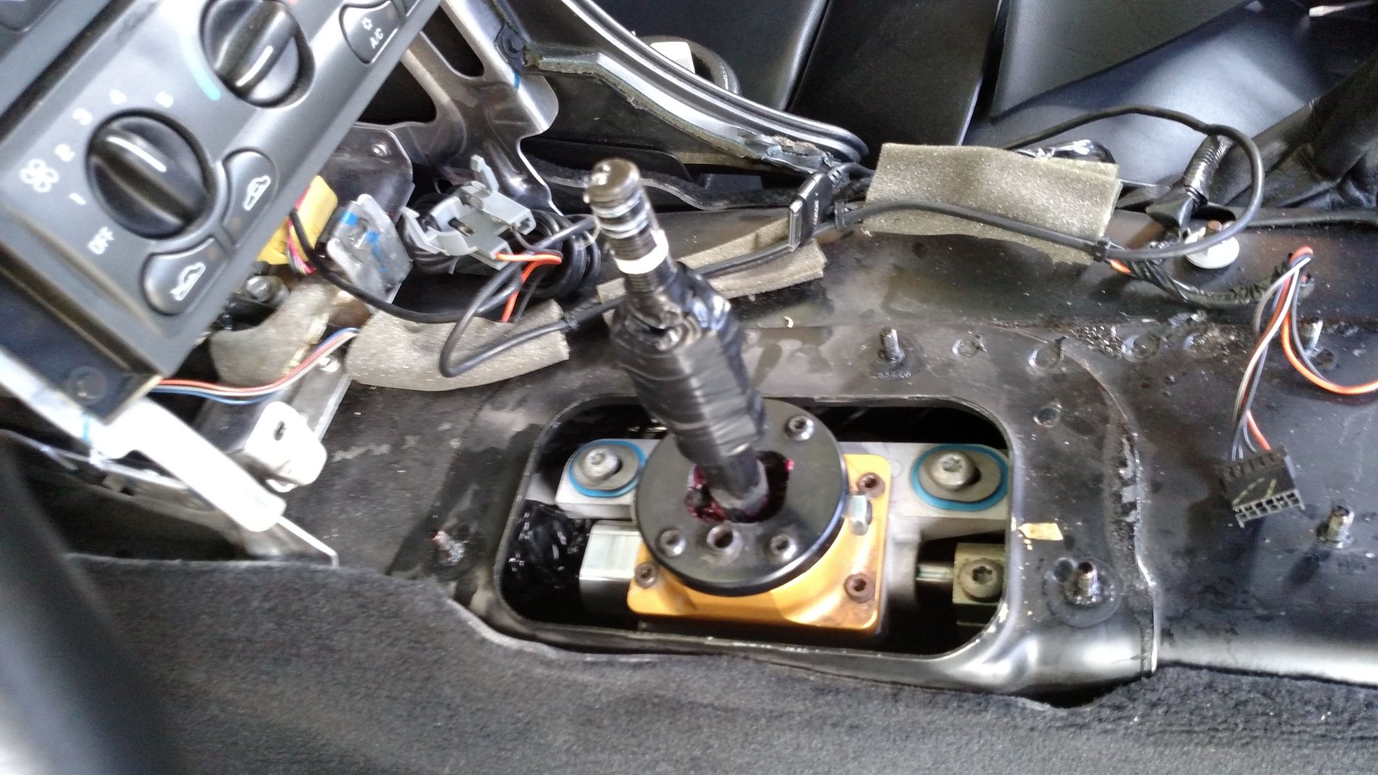

I have an older Hurst shifter, installed by the PO back in 2009. The shifter **** is a Hurst billiard ball units - no rattles, but the upper stick has some old lead weights taped wrapped to it - sort of mass dampening, hidden from view by the outer shifter boot. I did the anti venom mod which helps, but what really brought the whole setup together for me at least was the TMOD modified lower factory box. If the shifter you select does not come with a replacement lower box like the MGW, then make sure you get the TMOD lower box. Don't forget to replace the pivot ball cup bushing if your shifter is designed to incorporate the factory bushing. I got mine from Core Shifters;
https://core-shifters.com/collection...39310230683766
Yes you need to match sure you get the neutral center location set and dialed in. If your shifter has positive throw stops, those must also be properly adjusted. Lastly if you shifter has adjustable side to side bias assist for helping to more easily locating the center 3-4 gate, that needs to be done / set / adjusted / dialed in to your individual tastes.

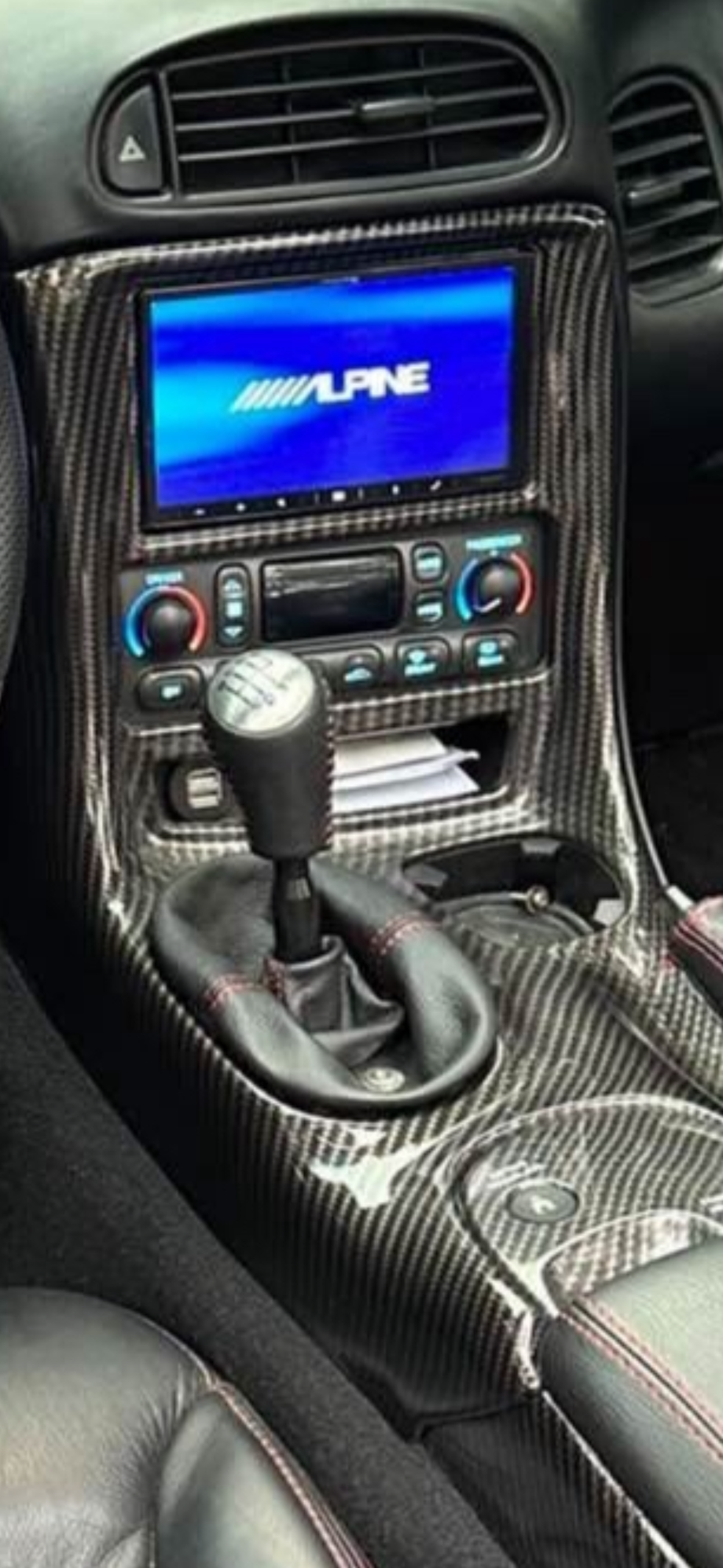

Big fan of the Tick shifter with a C6 **** and the anti-venom mod.
