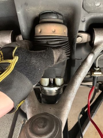

Does your car have the F55 Magnetic Ride shocks? If so, have you checked to see if the dealer blocks were left in the shocks?
https://www.corvetteforum.com/forums...ck-blocks.html
This was a problem when the cars were new and just could be no one ever took the blocks out. Hard to believe after this long it could happen, but worth checking.

Yes obviously yours is the latest but we still sometimes see these cars 20+ years old and never had the blocks out. Especially since it was a dealer job to do, not the factory. Takes a few mins to check.

Yes back in the day they can be left in place but most were removed as there was no suspension travel. Yours are likely gone unless you car is really low mile like 50.
How many miles on the car? You said it shifted to the side over bumps. That is Bump Steer and often that is a sign of a worn bushing or something in the steering or suspension is worn out. Often the rear will toe out on a bump and shift the car side ways.
I would get under the car and look over every bushing, ball joint and tie rod to see if there is any give or wear. Also check for codes on the suspension to make sure it is working right.
Corvettes will be firm but they should not bump steer.
Might even have the alignment checked.

Check for blocks mine where in for ten years

Check for blocks. Mine still had them when I bought my 2003 in October 2019. (16 years)

I see it and I believe you but the previous owner had to be a complete idiot not to have had something done. That belongs on just rolled in.

I just saw a car that still had the blocks, yesterday. It happens more often than people think.
