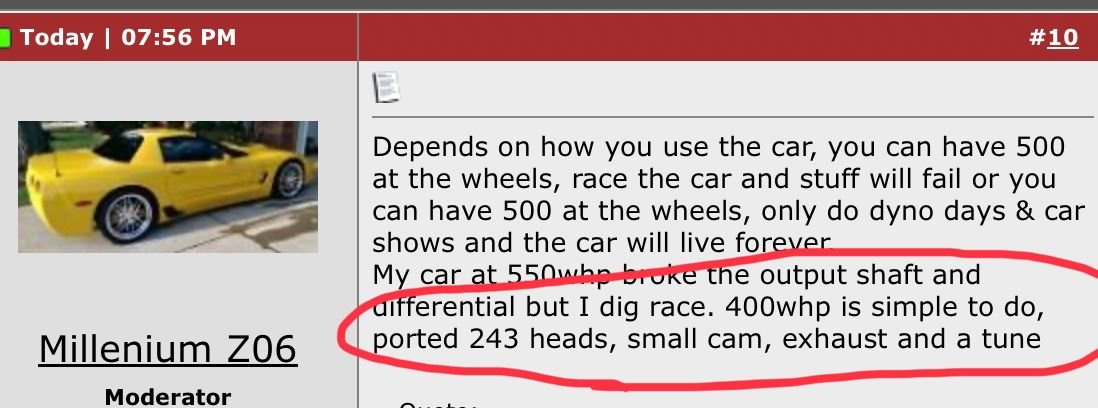

Depends on how you use the car, you can have 500 at the wheels, race the car and stuff will fail or you can have 500 at the wheels, only do dyno days & car shows and the car will live forever.
My car at 550whp broke the output shaft and differential but I dig race. 400whp is simple to do, ported 243 heads, small cam, exhaust and a tune
