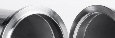

Exhaust tubes ? Switch to V-bands. No more gaskets. Use the locator style with insert ring for even more rigid gasketlessness

only 1 gets the locator flange. I dont think you can use two of them, im pretty sure it wouldn't work they would just butt ends
The trick to getting the locators to work is where and how they are used. Typically there needs to be some flexibility in one of the two sides, like a moveable rubber mounting so the pipe can wiggle, for example right off the engine there is very little flexibility so if you tried to connect both right and left exhaust manifolds together you'd need a flexible joint somewhere or it would be too rigid, possible cracking when it heats up or something.
In the long exhaust under a car, there is more flexibility in movement because of the hangers. However you'd still only want to use 1 of those rigid locator ring style v-bands in a line, not two, generally I place them closer to the engine because they will not permit exhaust leaking or movement, and make sure there is plenty of flexibility down stream. There are non-rigid V-bands without the isolation rings, but they can slip around over time which is good for comfort, longevity, flexibility, but also can have small leaks over time, especially when the clamps are re-used over and over. What I do is keep a supply of spare clamps for when the old clamps look beat up, or I detect leaking with my hand, that usually cures it. Also there is a technique to getting them sealed and lined up, a little anti-seize, a little oil, to help them slide around a bit as you tighten the clamp, and then don't make the clamp very tight, it should be kind of loose and the exhaust will still seal up nice when it can slide into a comfortable position, and even if they leak a little when cold that could still stop when it warms up so I check them warm.

I understand you have flanges. What we are discussing is whether or not it is a good idea to use these instead, you can switch to this, and it may really speed you up and make life easy for you. With a little practice these V-bands are very user friendly even the cheap ones from ebay work really well. Its a potentially low hanging fruit of exhaust mess simplified and I can tell by what you wrote that you've never had the pleasure of using one before or you probably would have already done it and never made this thread.

Poster child for v-bands statement, this tells me right away a V-band can make your life easier immediately, I hope this info will help
they are pretty much toast now
seal design is important. All gaskets are not same, and all seal designs are not same. its all about design of how to tackle that seal, not what gasket is made of. Sometimes no gasket is better.
I bought a cpl of Walker gaskets, but definitely not thick enough, have a small leak,
variation in aftermarket or even replacement specifications. Different gaskets for the same seal, some are wrong. V-band has no paper or rubber gasket
have adjusted, loosened,
twisted and tightened, no chance
You will do this with a v-band also. However, the v-band is a single easy to reach well lubricated locating nuton an easy and cheap to replace metal band. Think of it as a disposable gasket, except that its a giant metal band which partially acts as a gasket.
think of doubling up the cheap ones.. not sure if that will work either..
any opinions are welcome..
Do you see the little lip that sticks out on the left pipe, and it matches the valley on the other pipe so they are forced to fit tightly together like a slip-joint, and the band goes around the outside to lock it tightly together. You can get v-band with or without these little flange lips. They don't need to be tight either - I tighted my Vband almost completely by hand, but then the last couple turns with a wrench you know good and snug, its easy to over-tighten these they don't take much, once the pipes feel solid you can smack and pull at it, and it acts like a single pipe, its good.
