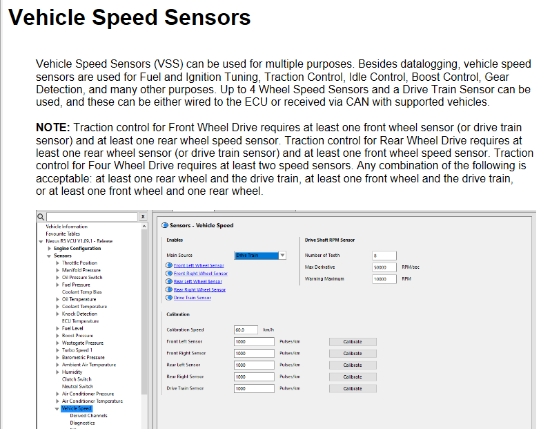

The thread about the best tires for street traction got me thinking, what is the approx HP limit without resorting to spinfest? While 800 hp sounds great spinning at 60 into a ditch doesn't sound so great. I would like to keep the power manageable with a 305 rear tire and an auto equipped with 3.73 gears. I understand it has a lot to do with throttle modulation but from experience, I know there are a LOT of high HP cars here, what are some opinions on max HP based on a good performance street radial.
The way in which you approach this problem is everything.
If I tune cars with unlimited power 2k+ rwhp and the owners want to drive around with basic 555 not even DR,
They must have front wheel speed sensor with which to compare driveshaft speed for torque management.
Otherwise your traction control is 'open loop' and that is you going sideways at 120mph with too much power

Power is only a part of potential problem, low gearing and tall tires traction vector becomes manageable at any power but the engine has to work at those specific load and frequency well in an application.
Most rapid simplified way to start doing traction control algorithm is Haltech Nexus and Hall effect wheel speed sensor
imo 600dynojet is easily dailyable, that is acceptable for decent tires 3L to 6L 2800-3800lbs ranges. Traction control at that level as safety feature, not necessary for normal tires to do well in typical street settings unless the vehicle is grossly mis-geared or the tires are bad. It isn't magic, bad tires will still cause a wreck eventually. It isn't meant to be a bandaid for poor tire quality. It is a small boost to safety and a potential performance optimizer for an already well stuck combo. Boost by gear and Torque management strategies should blend, improve transmission lifespan and traction together.
