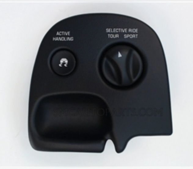

I am in the same boat. 2004 new owner with a unit in need of new shocks. Heck I am still trying to figure out whether I have MRC - LOL. Is there an in-expensive OEM option that doesnt take all of the computer deletes, etc ?
Do you have this switch on your center console?

Smoken1 - Yes, exactly that switch.
