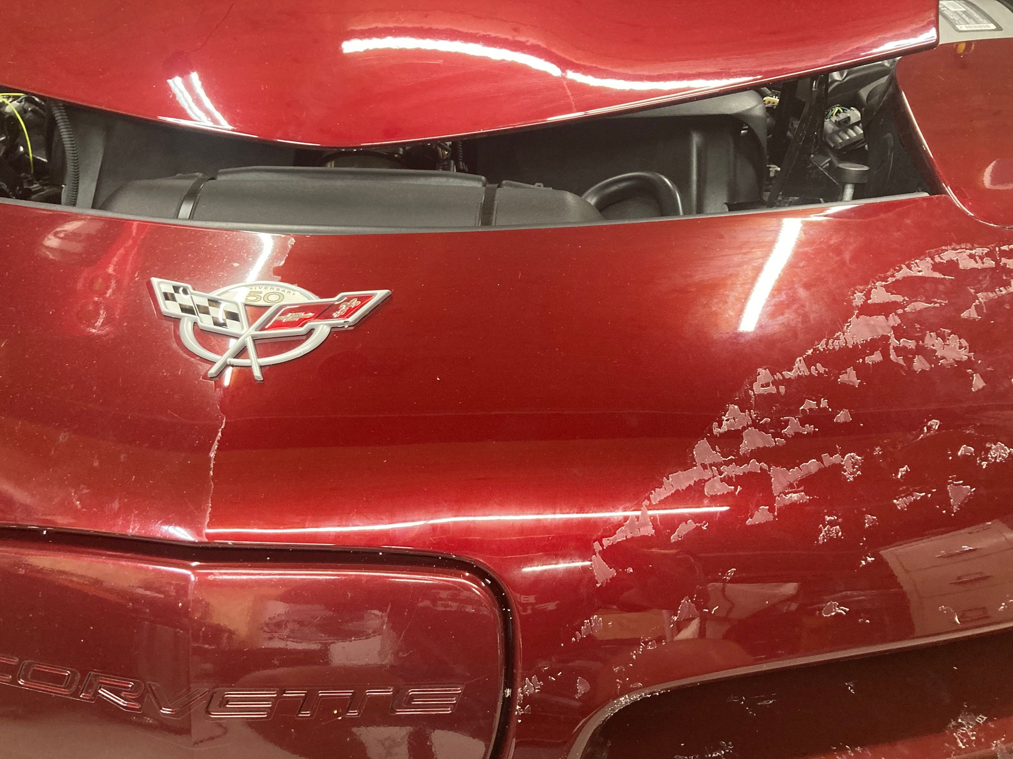

Hello, has anyone had any experience with PPF replacement on the C5 Corvette? I have a C5 I’m looking at buying, but it has peeling front end PPF. Some PPF places I contacted said the paint might come off with it, others said it won’t. Has anyone had experience with this issue? Thanks in advance.

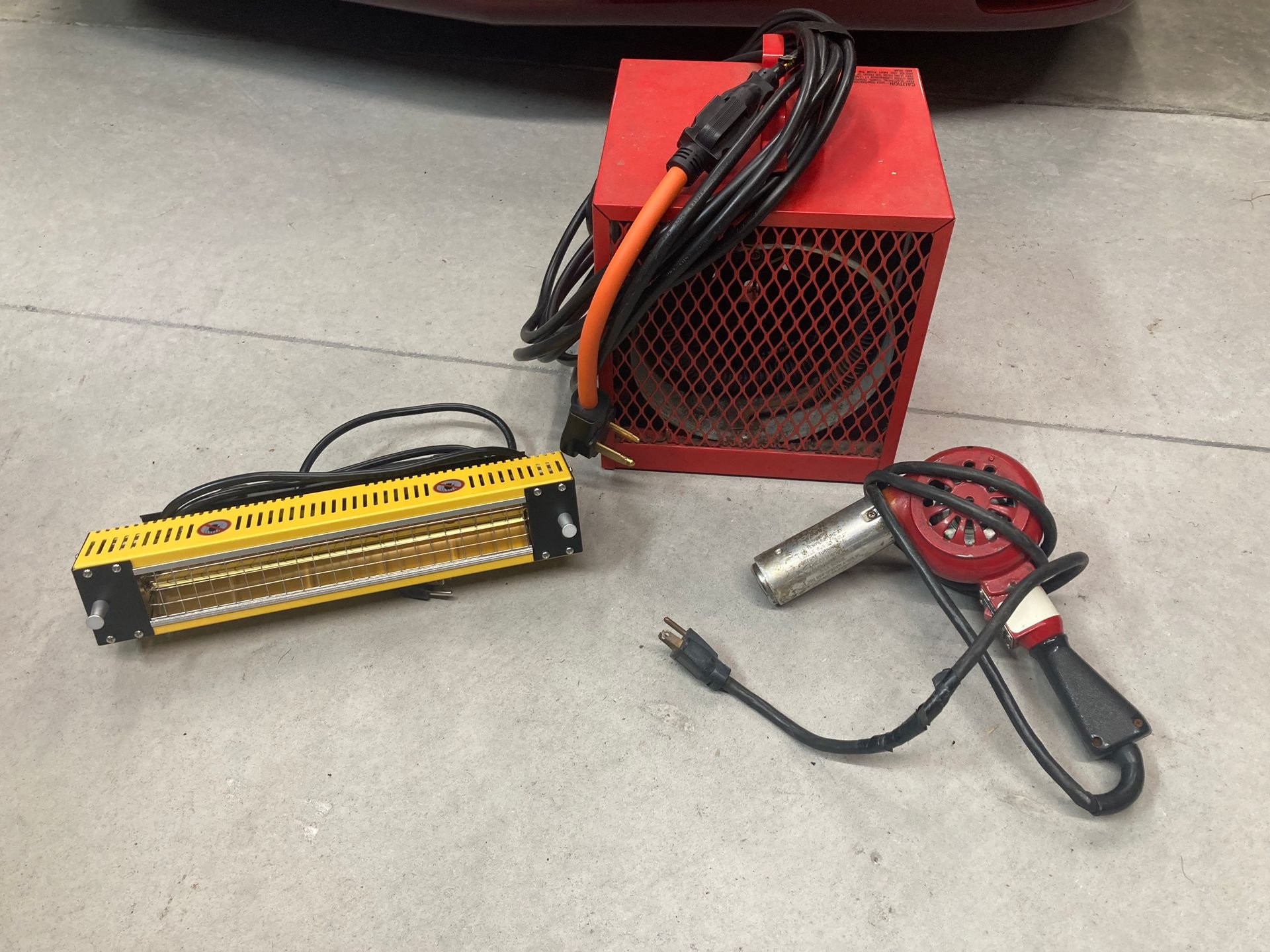

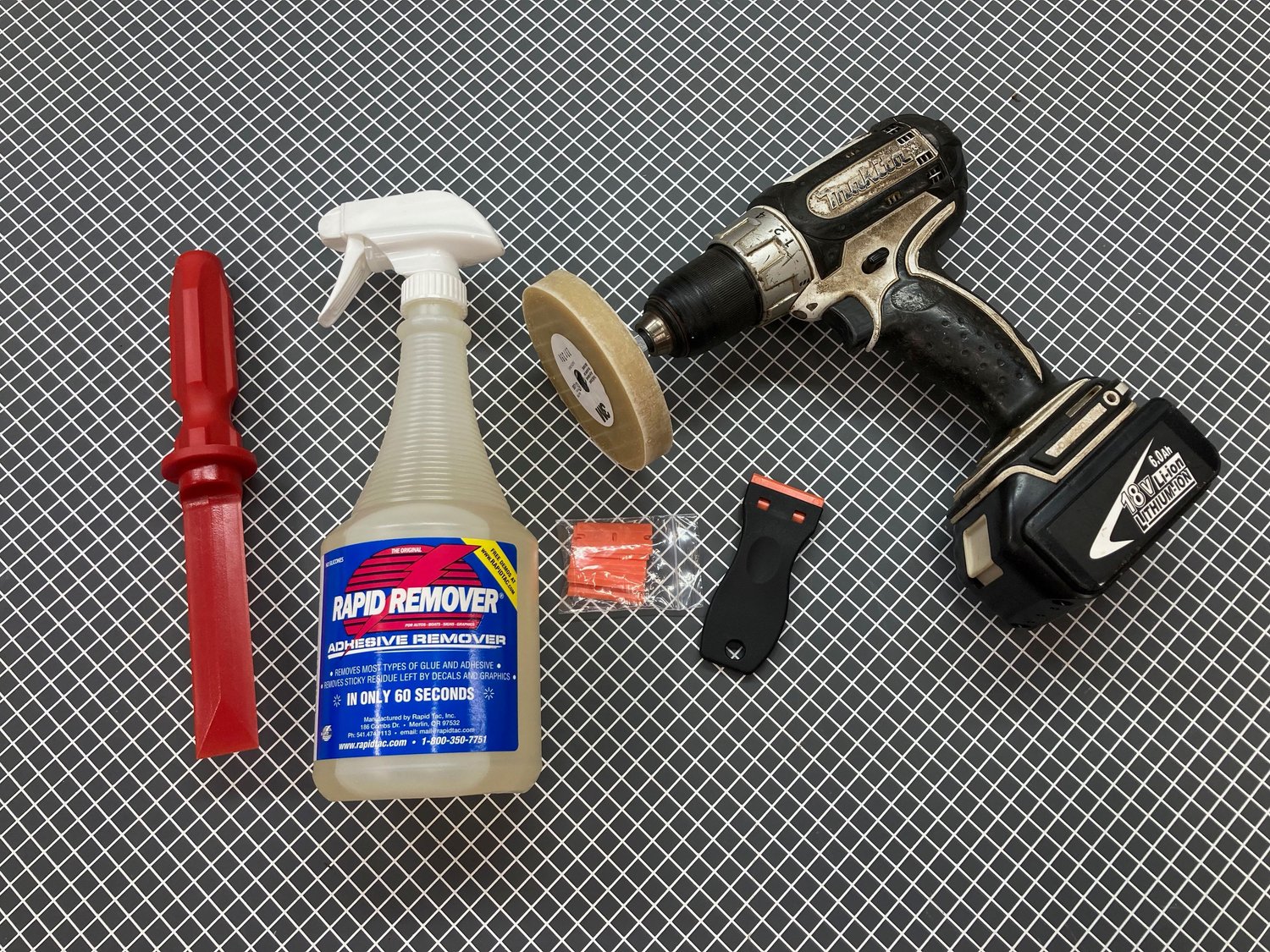

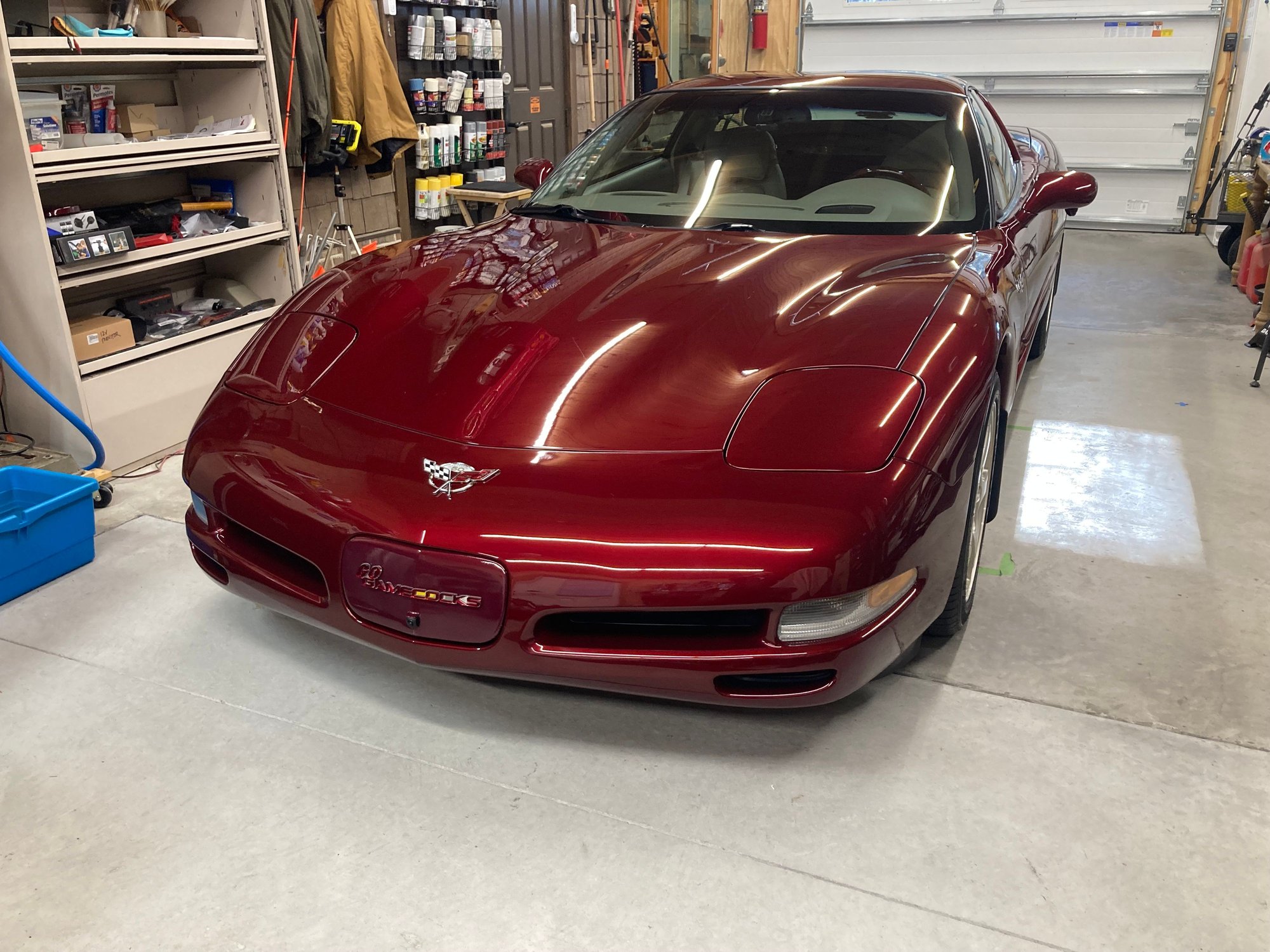

I took off all the 20 or so yr old sectional PPF (front bumper, rear of fenders and rockers) on my AE last year. Trying several methods (steam, infrared, rubber wheel, forced air heater and heat gun) the heat gun worked best, small section by small section with plastic razor blades. I'd get lucky and some bigger pieces would come off but it was a PITFA! Cleaning the residue was easy using "Rapid-Remover" (like a charm). Here's a few photos I had poster last year, good luck.

All done
All done
Heaters
Heaters
Plastic razors, Rapid-Remover & 3M wheel
