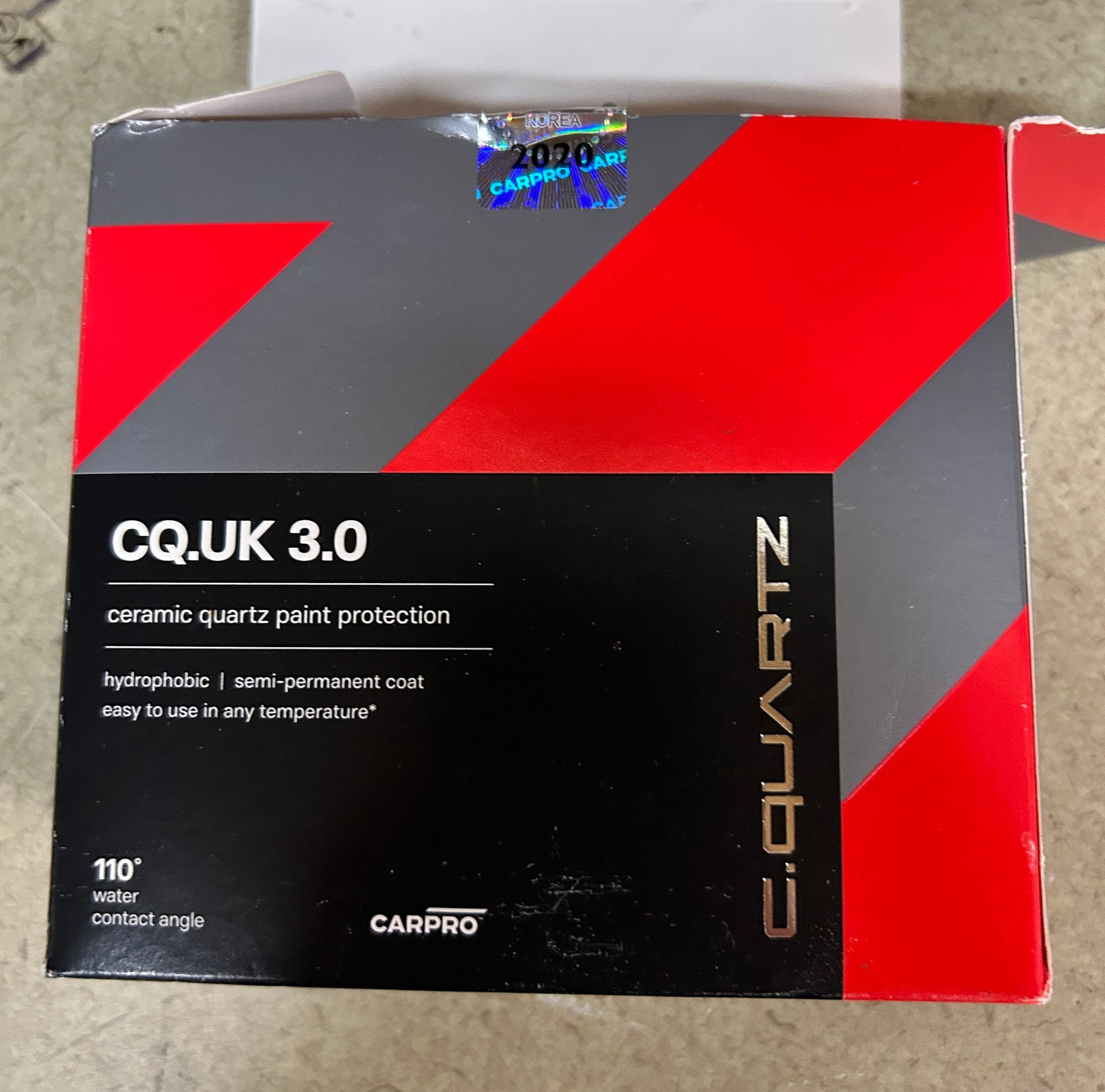

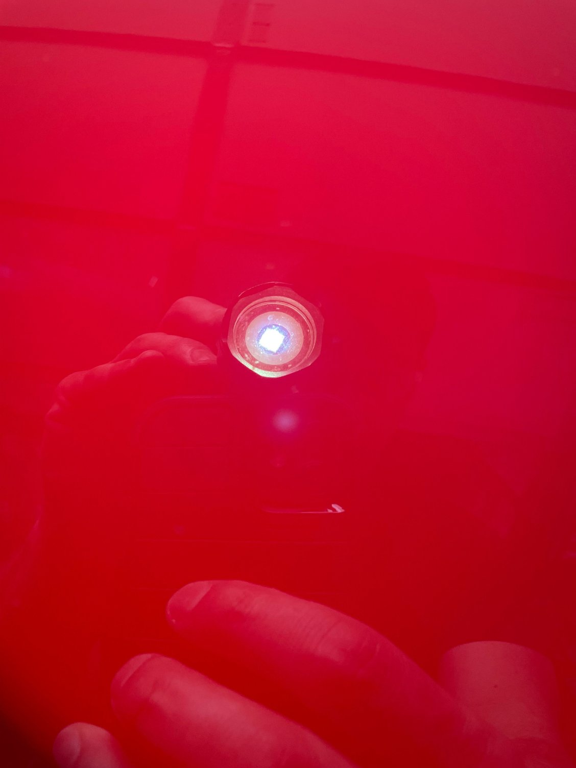

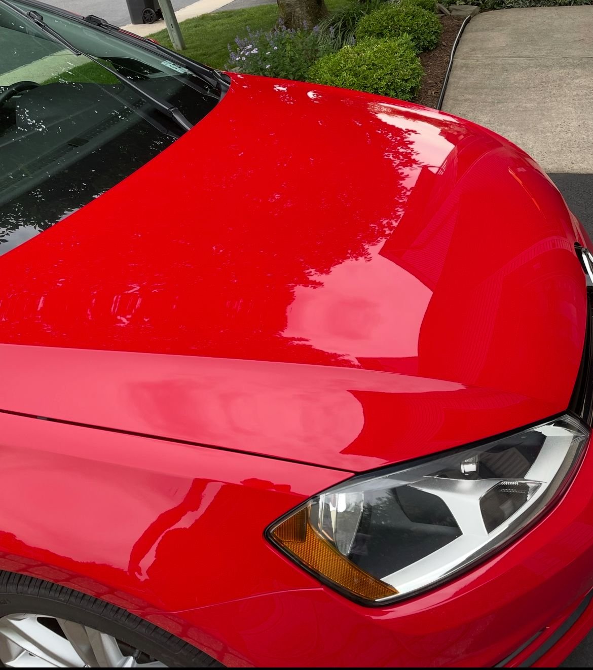

I ceramic coated my former TDI. The prep was definitely the bulk of the work. I spent 4 days working through my kid’s then 3-hr nap to wash/clay/polish/prep the paint before applying the coating. Applying the coating was easy enough but I was nervous because if you put too much on in one area during the application you will notice a “high spot.” I had a cpl high spots in hard to notice areas of the car but was happy with the results; especially since it was my first time doing it. At some point, I’ll find the time to do this to the z.
What I used. Worked decent enough
Before
Before
After but not done
After but not done
Done
Done

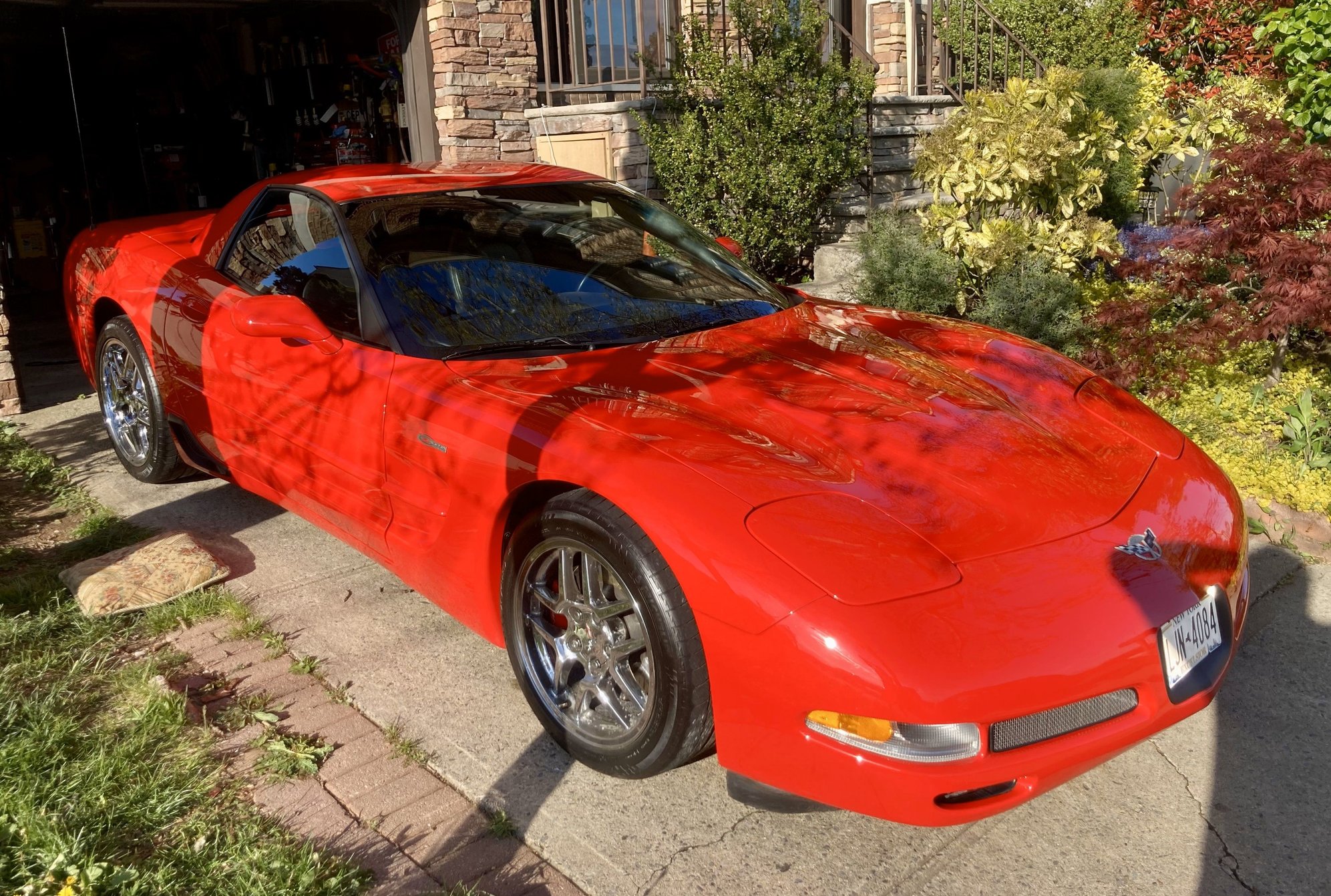

I did a light paint correction and used the GTechiq CSL coating. Not hard to do but like another member said, the prep is where it counts. I was doing some paint work which involved wetsanding, cutting and buffing anyway so it made sense to do it.
LINK
Results were pretty amazing
