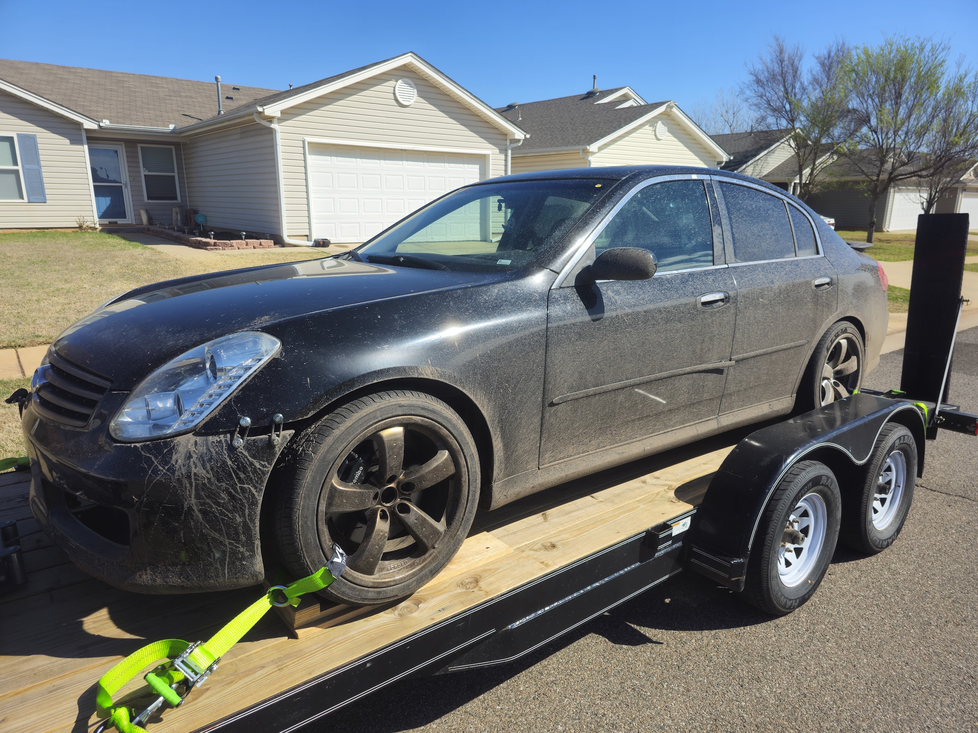

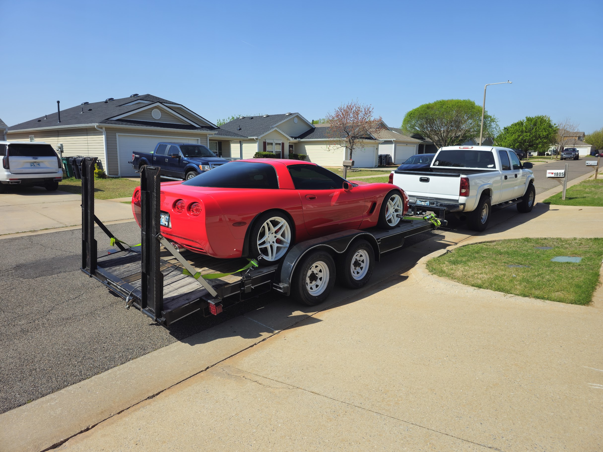

I have a set of ramps that is too short and is also 2-3" below the level of the dovetail on my trailer so I have a set of wood planks I use to soften the approach angle of my ramps and extend it further out. I also have a set of blocks I made to let the car bridge the gap at the top of the ramps. Since I have a wood floor I can screw in some small ramps at the front to stop the nose of my drift car from being impaled on my winch and it also raises the nose of my drift car JUST enough to let the doors open... Unfortunately my Corvette is not so lucky so I exit and enter through the hatch.
I don't tow my Corvette almost ever so my trailer is setup for the drift car but it works. I can't recommend enough installing wheel stops/chocks/whatever at the front of your trailer after you figure out where they should go. It gives you SO much more confidence loading solo ESPECIALLY in the dark. Look under the front wheel here and you can see. I started with just a wheel stop and then realized if I added another 3/4" of height the front doors would clear the fenders

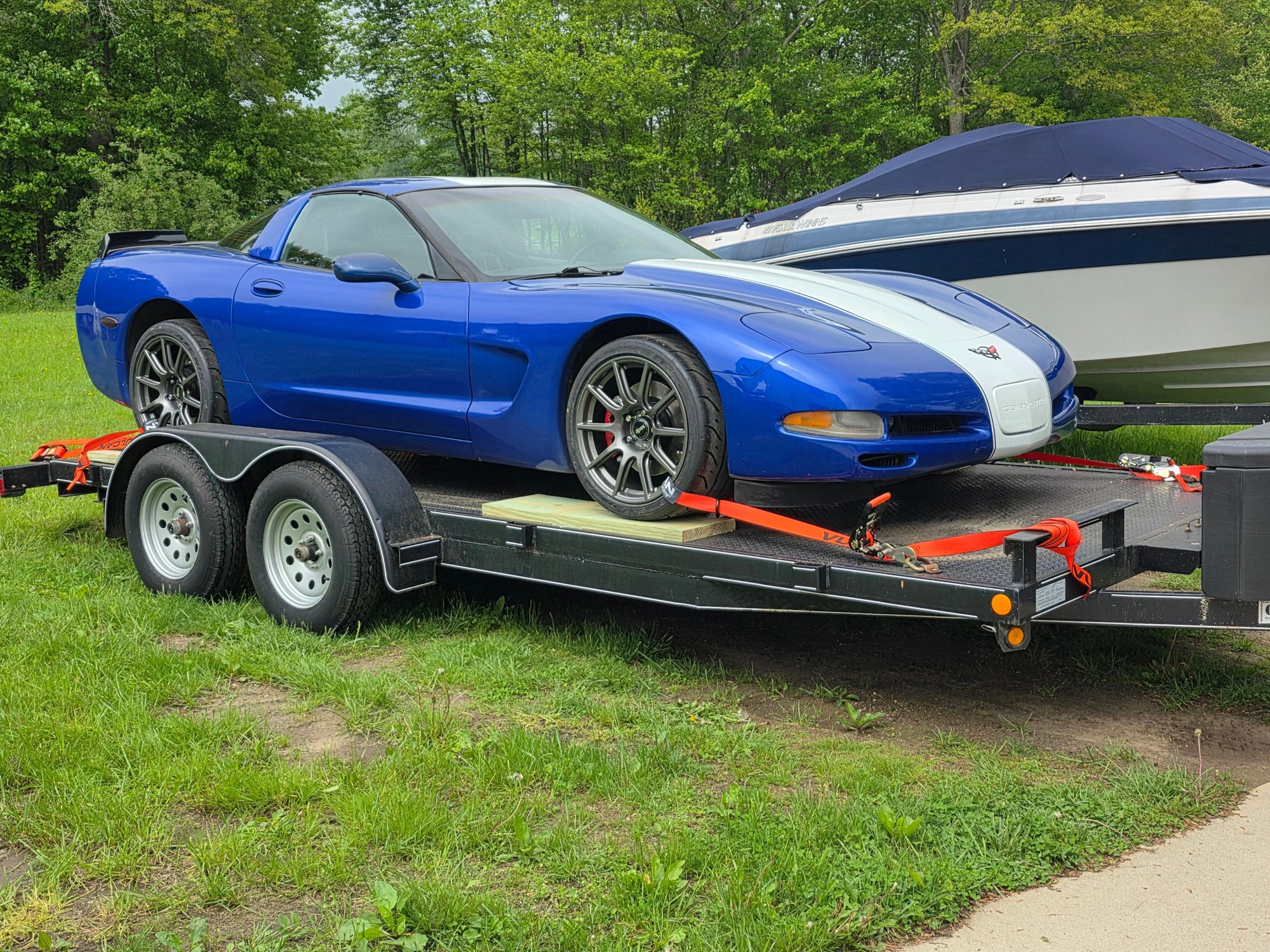

well it was pretty uneventful. I started with the rear of the tow rig on rhino ramps but once the car was up the trailer ramps they went flat to the ground and actually made the bumper crash into the beaver tail. Got rid of those and it went right up. Just had to make 2x12 pads to get the door over the fender.
But as you can see my car is not slammed.
