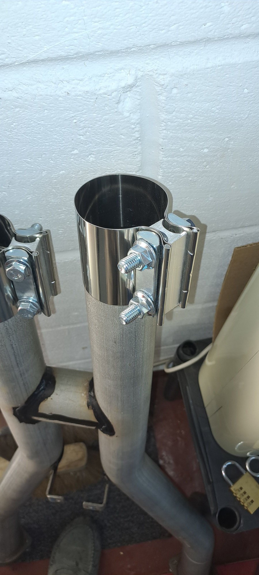

I decide to purchase an X pipe for the C5Z to go with the Atak system. So I cut out the H pipe and fit the X. Man it throws the left over the axle pipe so far off that I had to force the muffler onto the hanger studs in the rear chassis.
Now this really sucks and the sound was crap to my ears. So off comes the X and I have now reattached my H pipe using couplers.
Such a shame to have needlessly cut an original H pipe really and for nothing.

One thing I did learn though was that when I looked into my H pipe The hole in the pipe linking the exhausts was full size and not the size of a dime as reported on here by so many others. See the picture for evidence! Its a 2001 BTW.
So that was a win at least

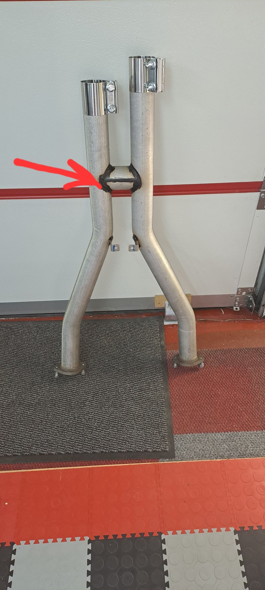

The H pipe not fitting is due to the fact you need to cut the pipe more. Look at the photo and you can see the H pipe is shorter than the X pipe. It will push the mufflers back too far and the rail pipes out too far. But it is best to cut too long as you have a second chance.
I had to make a number of adjustments when my converters went out. I went to a Magna Flow and it was shorter than the X pipe I had on. I had to splice in too shorter pipes to make it fit. Also Magna Flow pipes need pried apart as they were welded to where they narrowed. But mixing pipes will cause that.
As for the H pipe small hole. H pipes are just for pressure balancing not flow. The hole is large enough to balance the pressure on both pipes. Many miss understand and think they are like X pipes that are made to cross the flow and balance.
No exhaust is perfect. And it is clear the X pipe was not cut right if it pushed things back too far.

But if you want to use the X pipe you may want to measure. You cut the pipe on the car too long. Shorten it up and it will move everything forward. Trust me I did the same thing.
As for the H pipe they all have a large hole where you showed it, The small hole I believe is in the crossover pipe if I recall. Again it is not a flow pipe just a pressure pipe. It balances out the pressure. Now an X pipe will balance flow so fix you cut and remeasure and you will have a much better fit.
The photo you have shows the H pipe you cut is shorter. It should be about the same length. You will be much happier with the X pipe. Just don't cut too much on the head pipe.

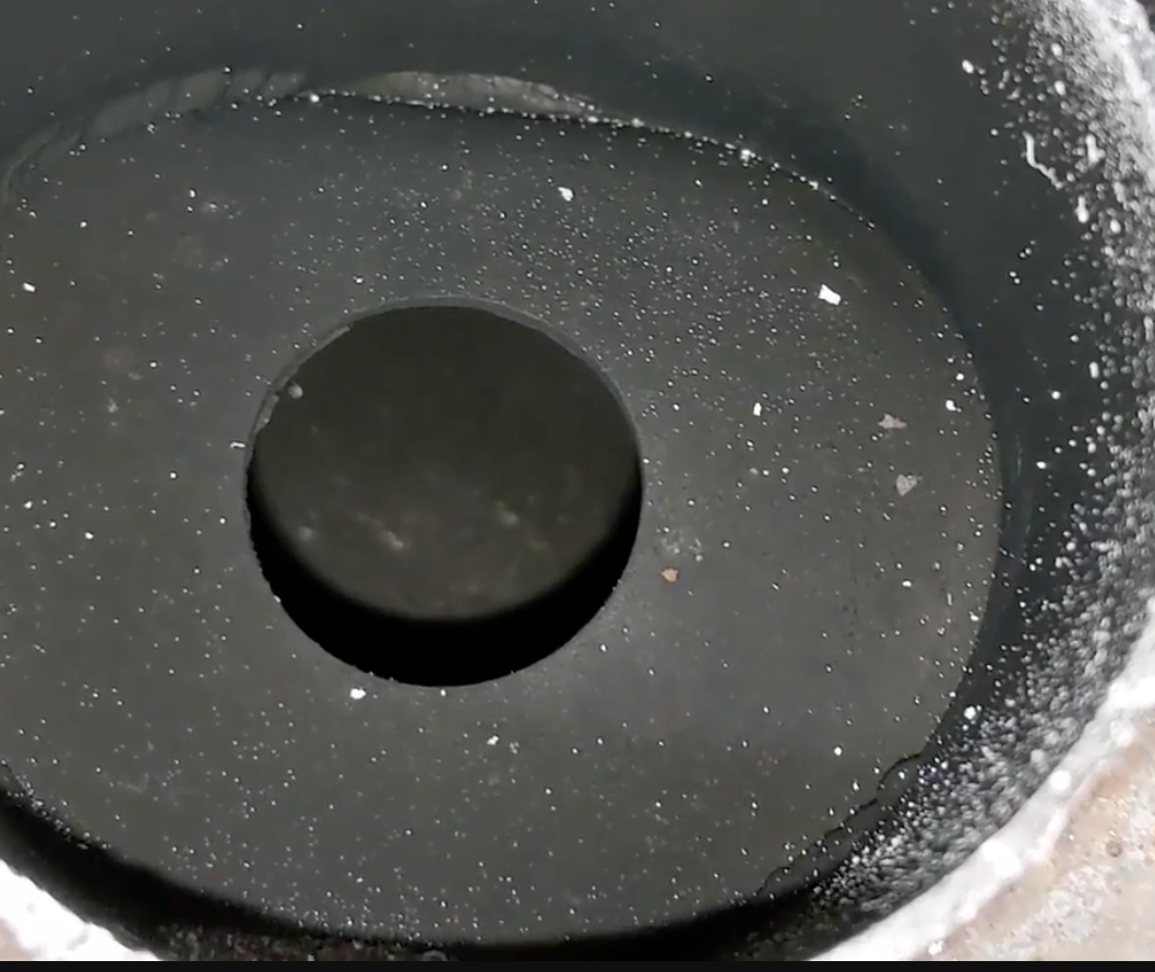

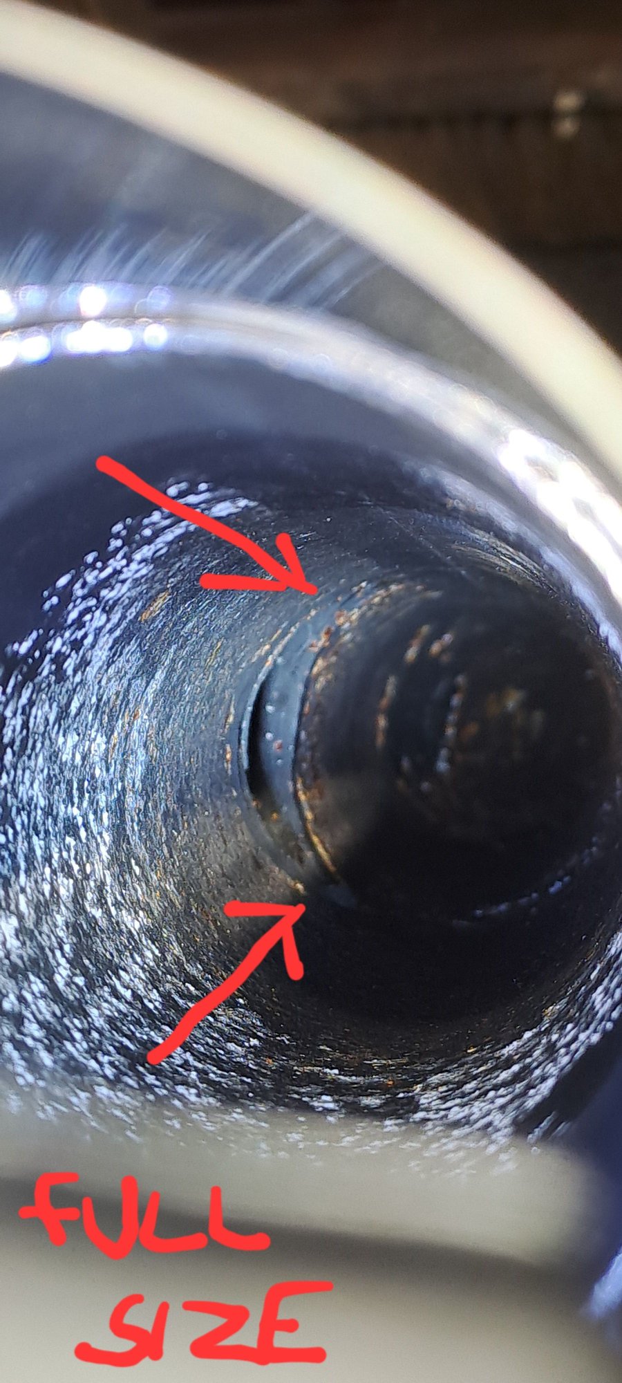

Originally Posted by alex04vette
My picture was taken down the bore of the exhaust. I managed to get a picture of the opening in the pipe with out sawing it open and thus separating the two halves of the H. The position of the internal holes is indicated in the picture below.
Mines a 2001 Z ....maybe something different on the early models but that H section is deffo cut and welded full diameter and not a dime.
Size still does not matter. Pressures balance even with the small hole. The exhaust flow will not easily make a 90 degree turn if there is an easier way out. Do not mix up what an X pipe does vs H.

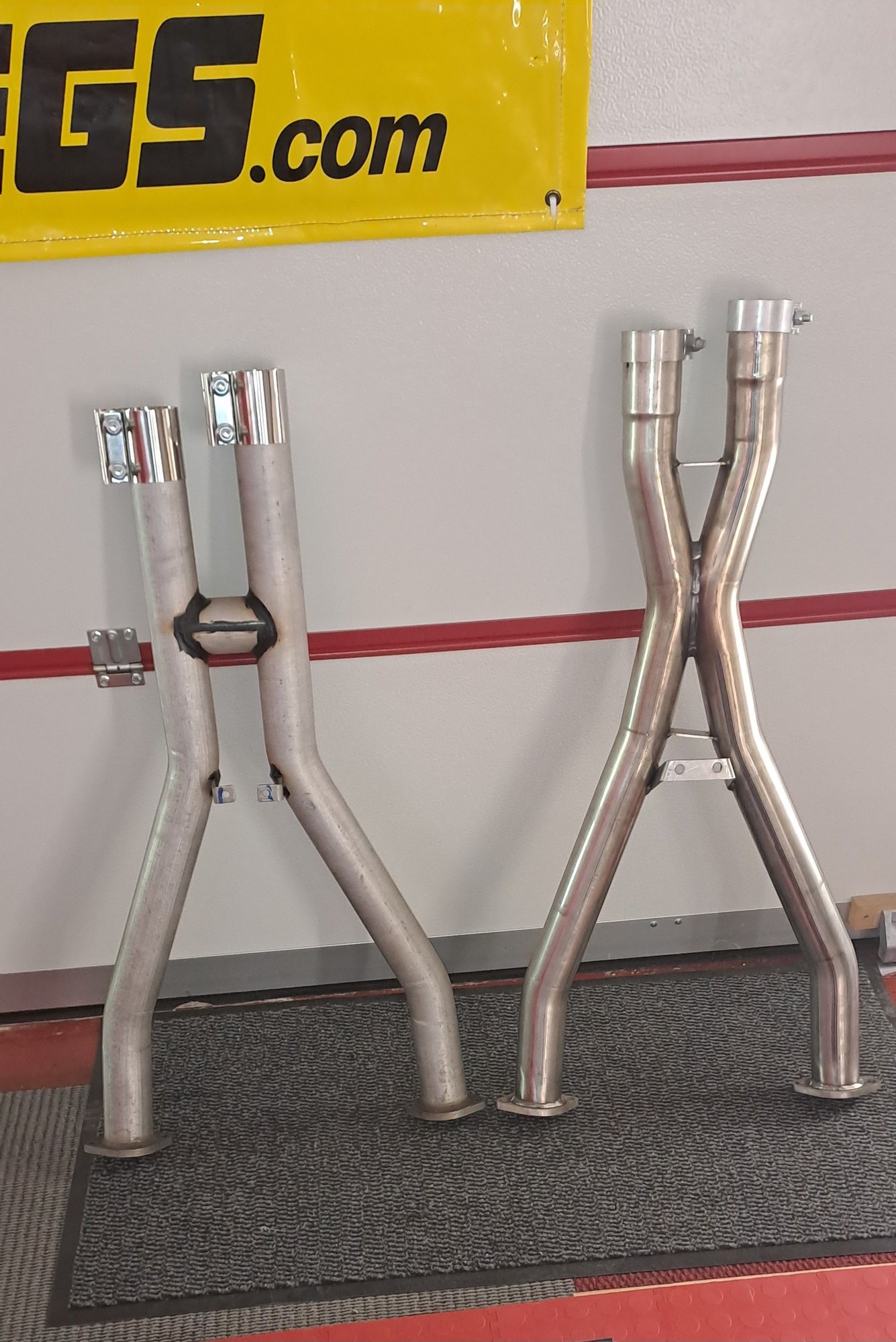

Based on your x pipe and h pipe photo the h pipe was cut too long. Or short depending on how you look at it. You needed to cut more off the pipes from the converter. That moved the x pipe forward and it moves the over the axle forward.
I would not say this with out your photo.
Just to clear up a point here guys. I cut the H under the car to the EXACT Borla dimensions as outlined in their instructions.
My photo shows the stainless steel couplers mounted on the H before I refitted it after I discovered the X was not for me.
This gives the impression that it is longer which it is not.
I had fitment issues on two systems for two different cars which is unfortunate. No errors on my part what so ever.
No offense Meant. In the photo they do not look to be the same length.
Even if they are the same you should still have enough room to clear the axle and move it forward an inch or two with trimming on the converter pipe. They give a lot of room over the axles.
Most exhaust may need some tweaking.

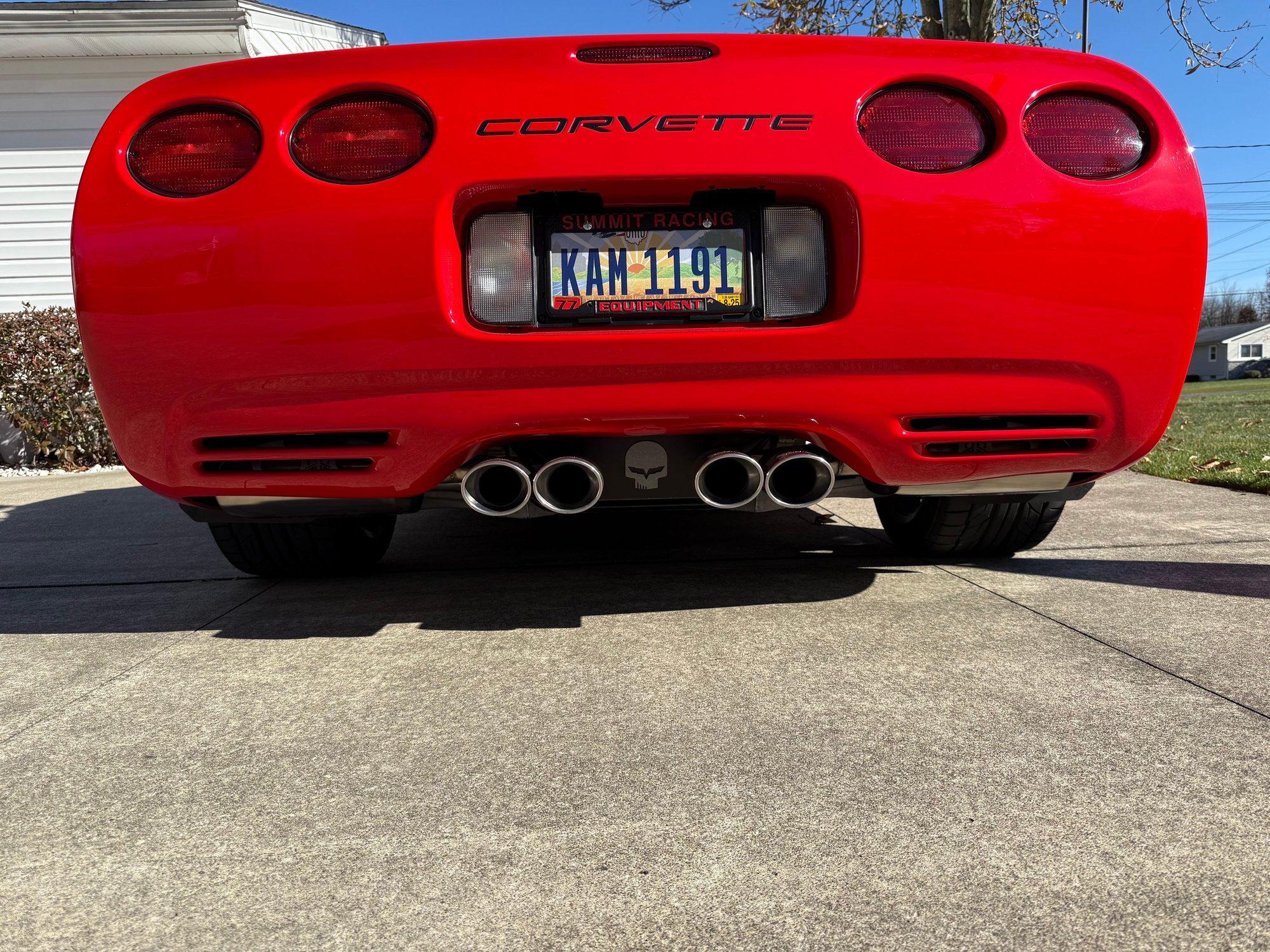

I recently installed Borla Attak #140428 on my 2004 coupe and it fit great on the stock H-pipe. I love the sound from it as well. I have recently been experiencing the deceleration jingle related to TSB #04-06-05-006. I was debating on the Borla X-pipe or the following H-pipe (see link below). I really like the sound from the current setup and afraid the x-pipe will ruin it for me.
