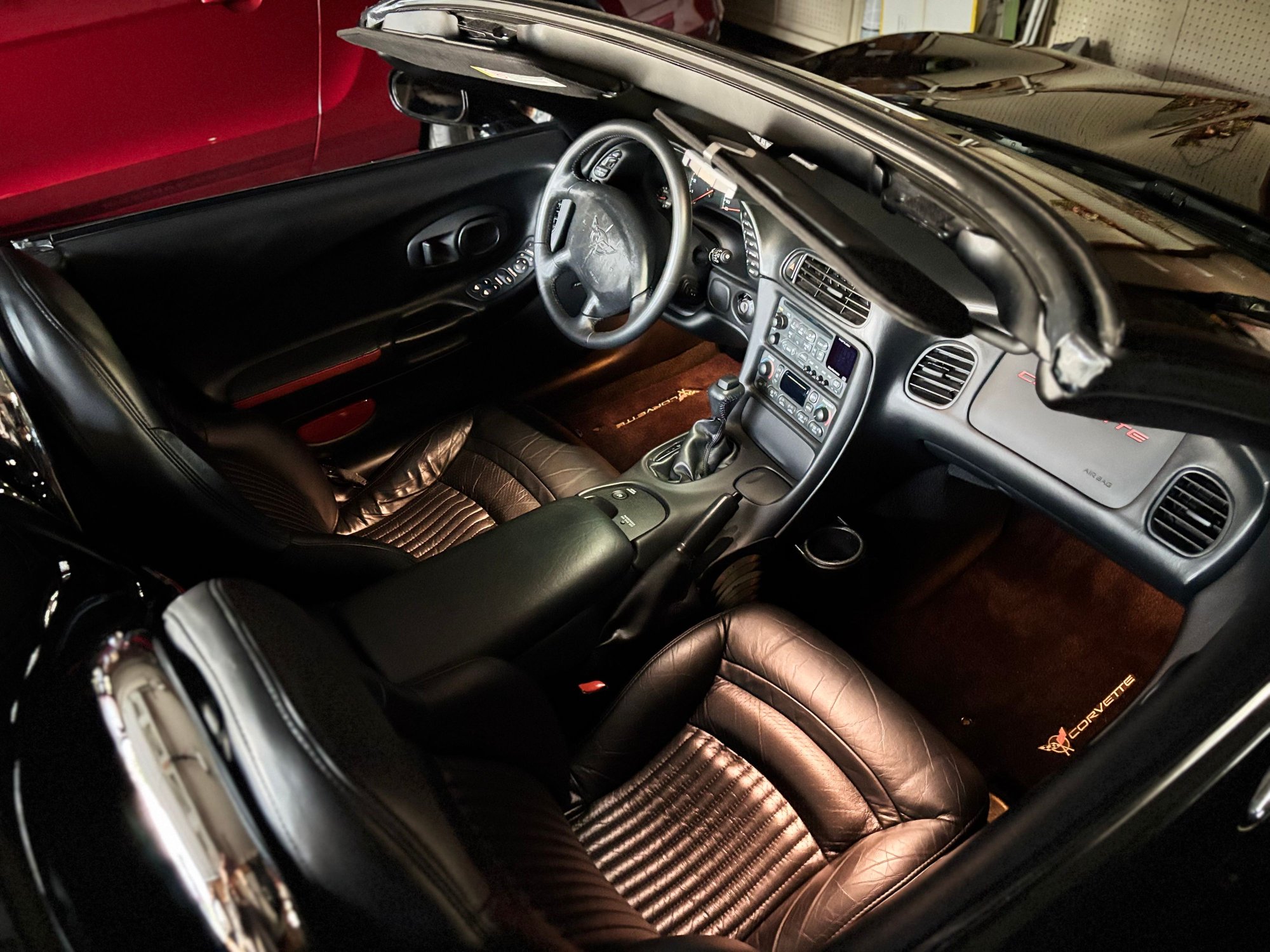

It’s half full…I’m debating whether to drain the gas or take my chances with mixing new fuel in. I drove it for 20 miles after changing the battery (before I knew the possible maintenance pitfalls) and it didn’t exhibit any signs of old gas like rough
idle. It does feel under power, but Im also used to driving a c8z so I can’t really tell what’s normal or not.
on a positive note the interior looks pretty good : )
