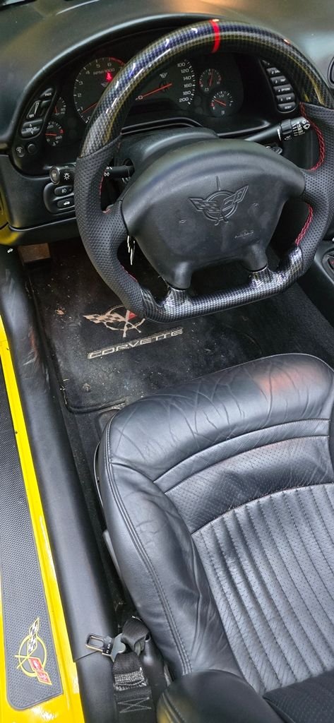

Well, I couldn't stand to wait...
I had the new wheel, had the tools lined up, I couldn't stand to wait...
INSTALL DONE!!!
Took a little over an hour with all the fooling around with the video shoot while also doing the R&R.
As to getting the old wheel off, I was leary of that wheel puller, but I was careful, went slow, held the head of the ratchet to keep the puller straight, and I turned the screw slowly, bit by bit, and suddenly, just like you've seen in other videos, POP! And suddenly it was loose, turned out to not be a big deal.
Just have to be careful, make sure you have the puller adapters engaged in the wheel correctly, make sure you keep the puller straight, turn slowly while supporting it, and it will work.
Here's a crappy pic, I did video of the whole R&R, but will need a lot of editing to get it like I want it, so will be a while.
Need to do some clean up, will get some better pics, maybe tomorrow, skeeters were chewing on me, I had enough and gave up.

Little better pic of the finished install, pulled off the video.

An even better view lifted from the video...
