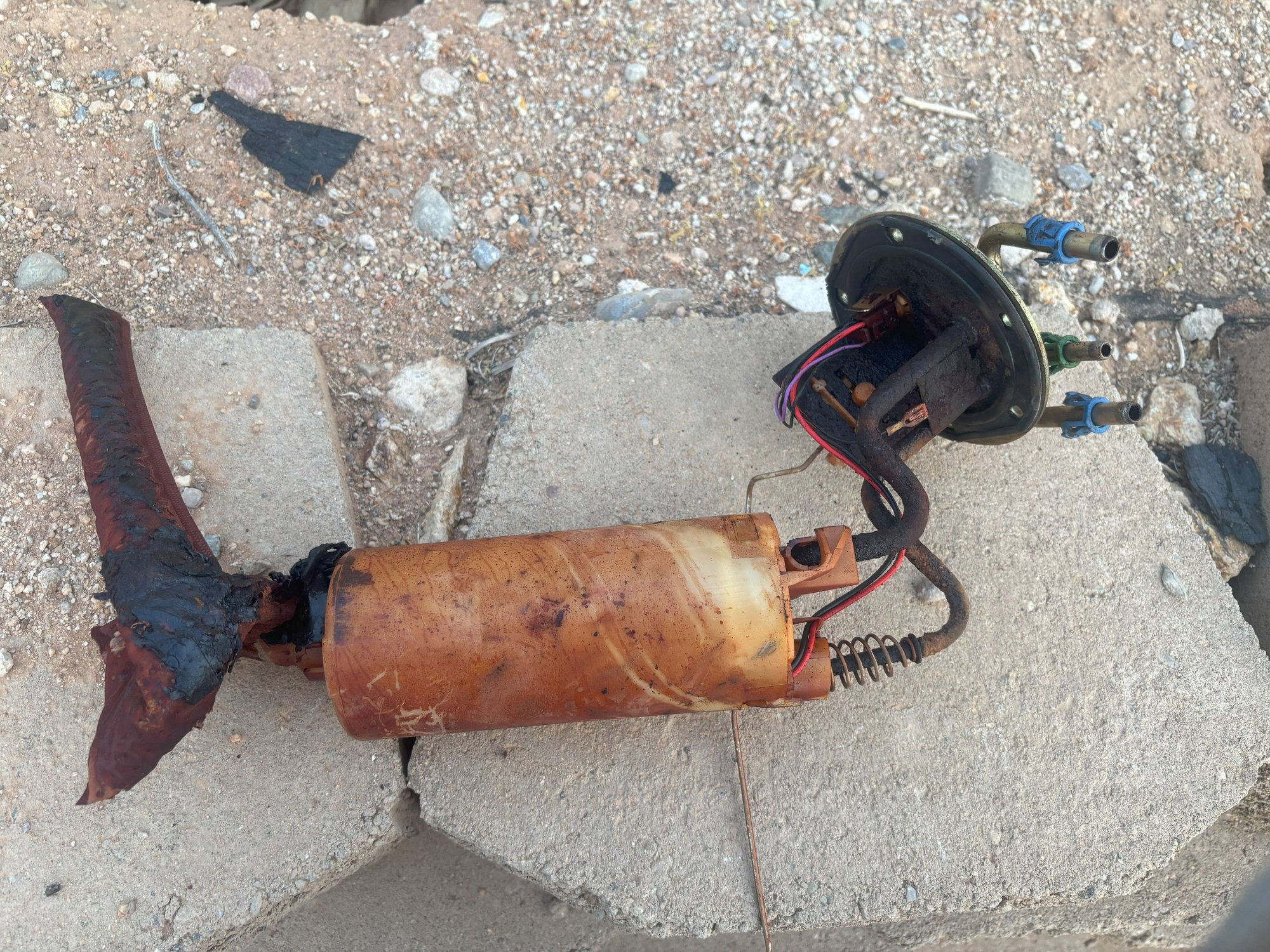

Little update. Tried applying power directly to fuel pump, no response. Took this monster out.

That doesn't look great

Yeah. I have had some high miles C5s and never have I seen a pail anything other than bright white or pretty bright white with a sock of a dinghy whitish yellow and all of the metal pieces of course being still pristine.
What happened to the car again?

Since your here with the pump out, You might want to replace the hose coupling between the 2 tanks And clean both of them !

Wow! That looks like someone poured a bunch of garbage(sugar maybe?) in the fuel tanks, I would sure pull the other side out too, and the tanks to get them flushed out or replaced.
