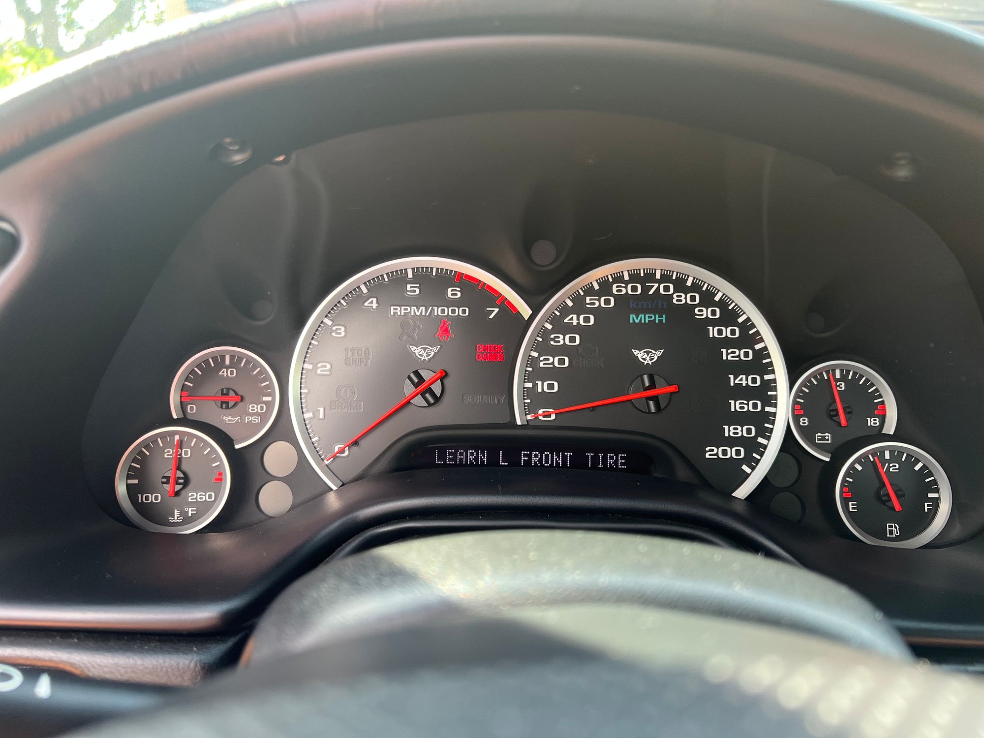

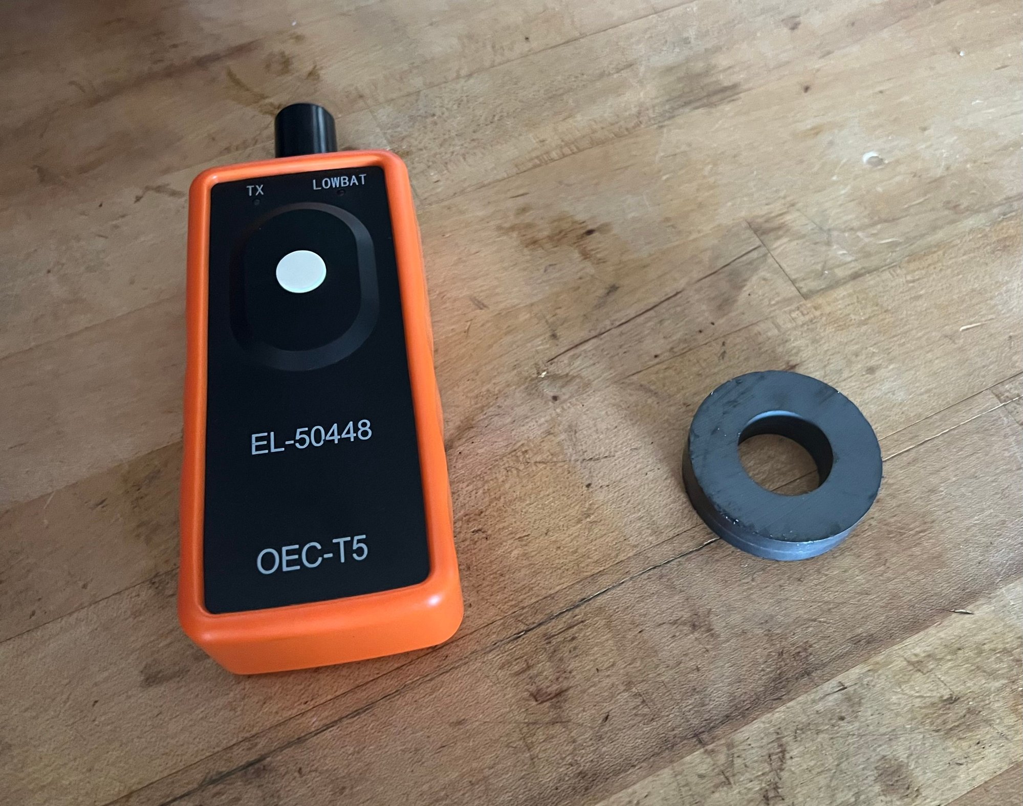

The car has been in the shop for a few weeks due to the SC install, tune and oil cooler installation. Prior to the shop all the tire sensors were working but now my RF and LR tire sensors are not registering. I know the DIC relearn process and tried using both a magnet and the GM tool I bought off Amazon for $10. I even disconnected the negative battery cable for one hour to try and reset everything but still nothing.
What's weird is that the working LF tire sensor is not registering and I'm not receiving the horn beep. With the TPMS re-learn, you start with the LF (Driver's side) tire and work around the car clockwise to the LR tire but I can't get past the first tire to get to the non-working RF sensor.
Is there another trick I'm not thinking of?

How old are your sensors? It is possible they are starting to go maybe and it just happen to correspond to your upgrade? I mean it is a pretty easy process and you have both the magnet and the RF tickler!

They are GM sensors and were mounted back in 2019 when I purchased new tires so they are at least 6 years old depending on how long they were on the shelf at the dealership. I accept that they may have died, however why can't I at least get the working LF sensor to register since it is the first sensor in the learning cycle? Do dead sensors prevent the start of the learning process cycle?

I can't remember the exact timing, if the LF which is first in the process won't register, the computer sits there and eventually times out. I forget how long you have in between each one as you work your way around, but there is a timeout that will stop the process if not completed within a specified time period.

You have 45 seconds between each wheel. Not sure if that’s longer for the first wheel (Front Driver) but I can’t get that one to register or confirm with the horn beep and wonder since because it is working that I can’t get it to re-register or re-confirm which prevents me from moving on to the Front Passenger sensor which is not working.

If you have OEM sensors, they should be triggered by a magnet I believe. Perhaps try a different magnet.

Yes, that is correct. I too think that if the first sensor will not sync, no other will either.

You don't actually need to switch the wheels. Just go to the RF first like it's the LF. If the learn process starts working, you know the LF sensor is dead.
