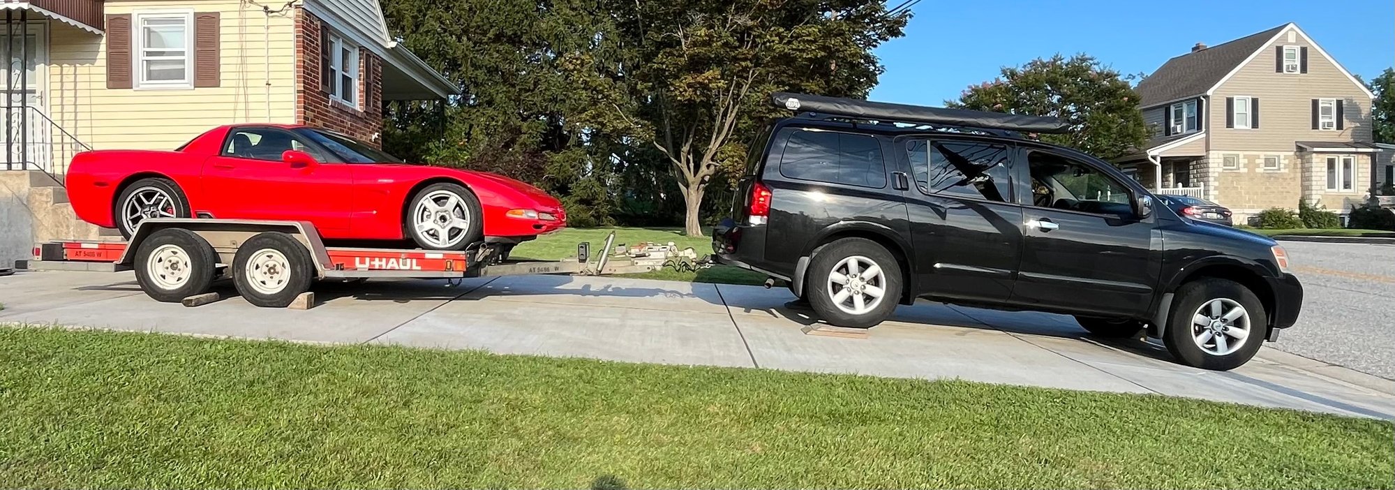

I rent a U haul to take my car to the track. I have an assortment of 2x12s that make it easier. Most important are the pieces that fit in the front wheel area of the trailer. This get the air dam over the front edge of the trailer. Then I have a shorter piece with a bevel cut on it that I place down to get the tires onto the first piece I mentioned. Less important but helpful is a double stack that I drive my SUV onto to raise the tongue/lower the rear. This last time I also placed an identical double stack under the U-Haul ramps. This really made getting my car on there much smoother. Here it is from 2 weeks ago. You can see the boards under the truck tires.

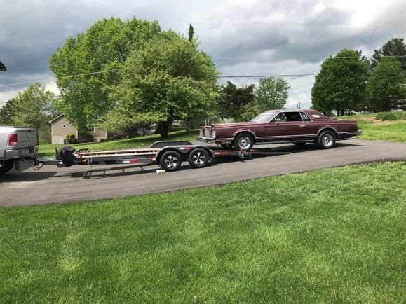

@schaumi
If you just pulled truck & trailer out into the street, and extended ramps to the driveway, you could literally drive straight onto it.
The angle of of the driveway is making the angle even worse. Here is a pic demonstrating how to use the terrain to your advantage for loading/unloading. That's my old trailer, and my Lincoln.
Yes, carry the blocks for use at the track, but best thing to do is find a curb to drive up onto, OR back the trailer/ramps up to; to change the whole angle of the dangle.

Originally Posted by Sydwayz
@schaumi
This is exactly what I was talking about how to use a driveway or a curb to decrease the angle of driving up on to the trailer. Good example.
@schaumi
Uhh, what?! You want me to completely block my two way street with my truck and a trailer while I load my car onto it?! That’s a FANTASTIC idea!! Sure, all the people trying to get where they are going will be happy to wait 10 minutes while I load up my car and hook it up.
No thanks. I’ll use my wood blocks and take my sweet time without the stress of getting honked at or worse.
A good driver could jackknife it, leaving the trailer on the lower part of the driveway and the truck parallel to the curb so it's not blocking the whole street.
It would take 5 minutes tops to pop the car on, set the emergency brake and chock a tire; and then gently back the rig into the driveway to tie it down.
I'm just expressing and demonstrating there is another way. Keep this in mind whenever/where ever you are loading/unloading; look at the topography and use it your advantage.
You don't have to get upset. You and your neighbors must not be very neighborly.
