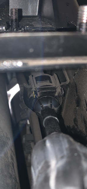

Here is what the bracket looks like looking down from the top. 2003.5 convertible.

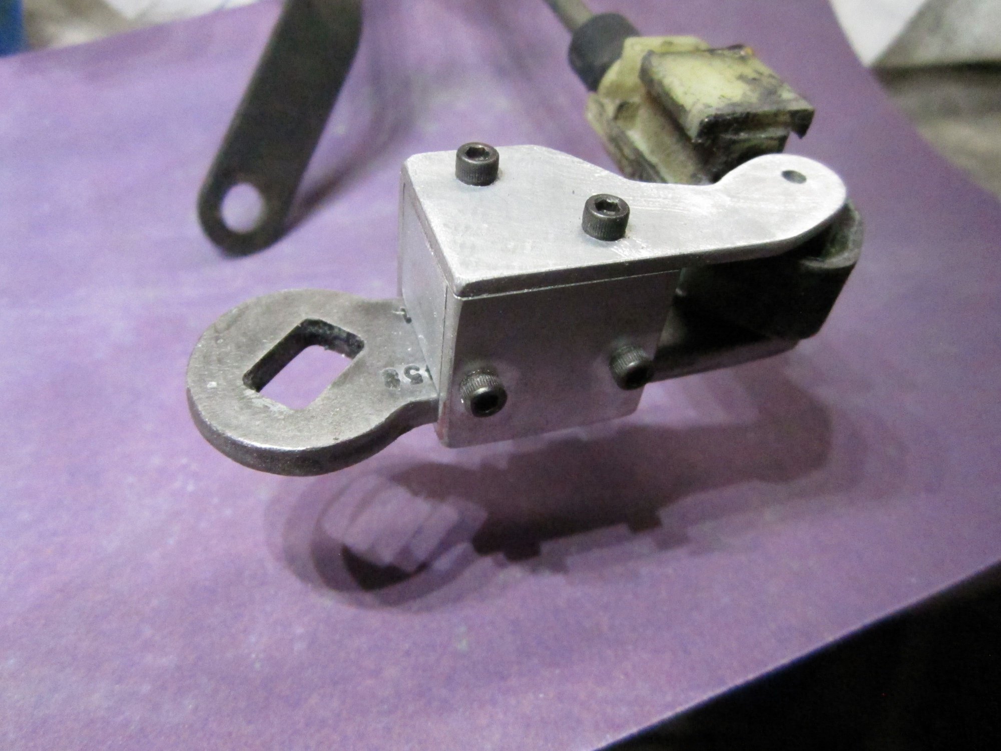

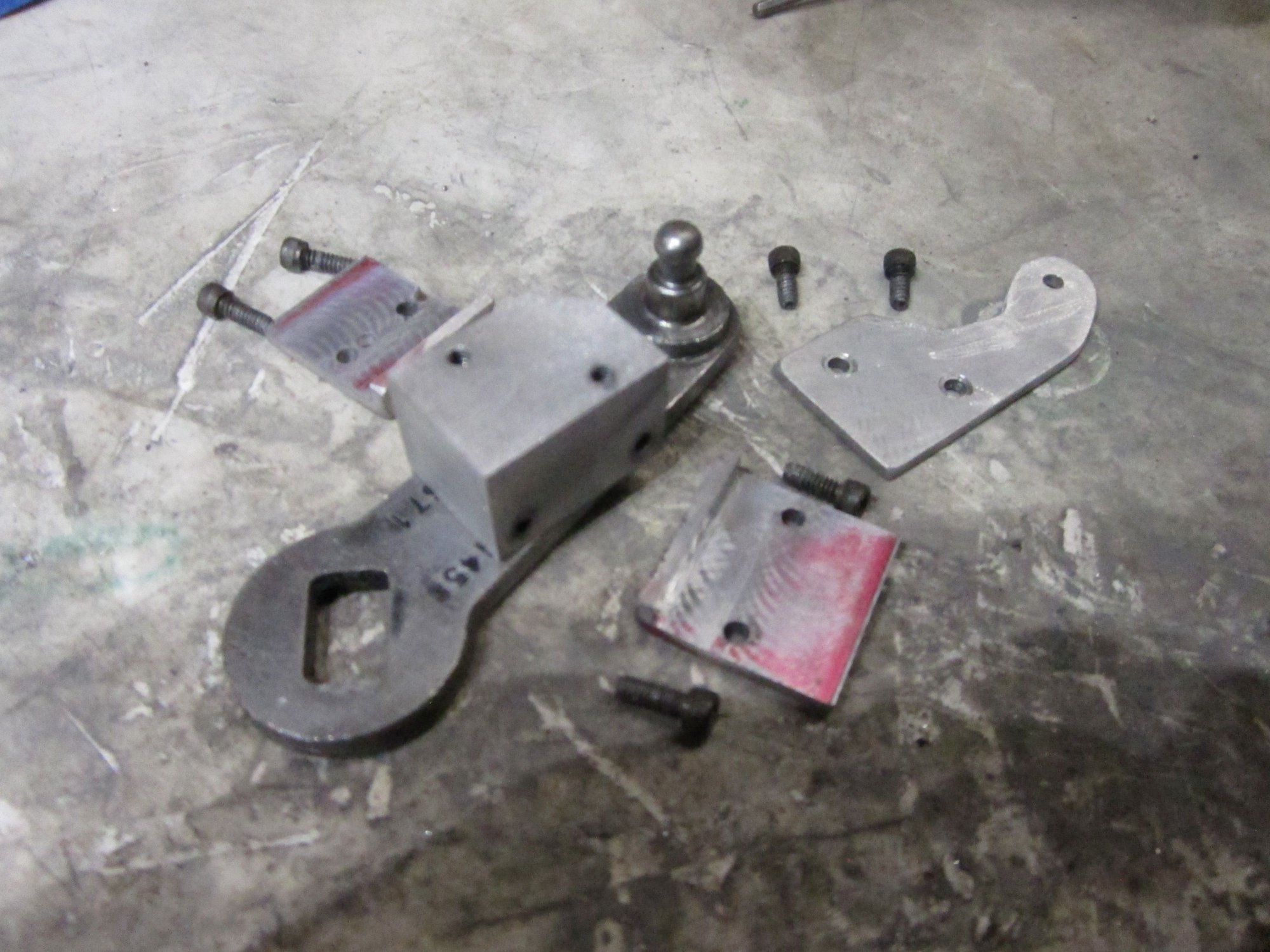

If the front end of the cable pops off, the car can be shifted and driven after the shifter is removed which isn't that difficult. It's a big problem if the back end of the cable pops off. I made a retainer that clamps on the transmission shift arm so if the grommet ever fails, the cable end can't come off so the car can be started and driven. The steel shift arm is hardened so drilling through it with normal drill bits won't work that's why the block is held on by the two sides that clamp to the arm. In case anyone wants to make one, here's what it looks like assembled:
And apart:
