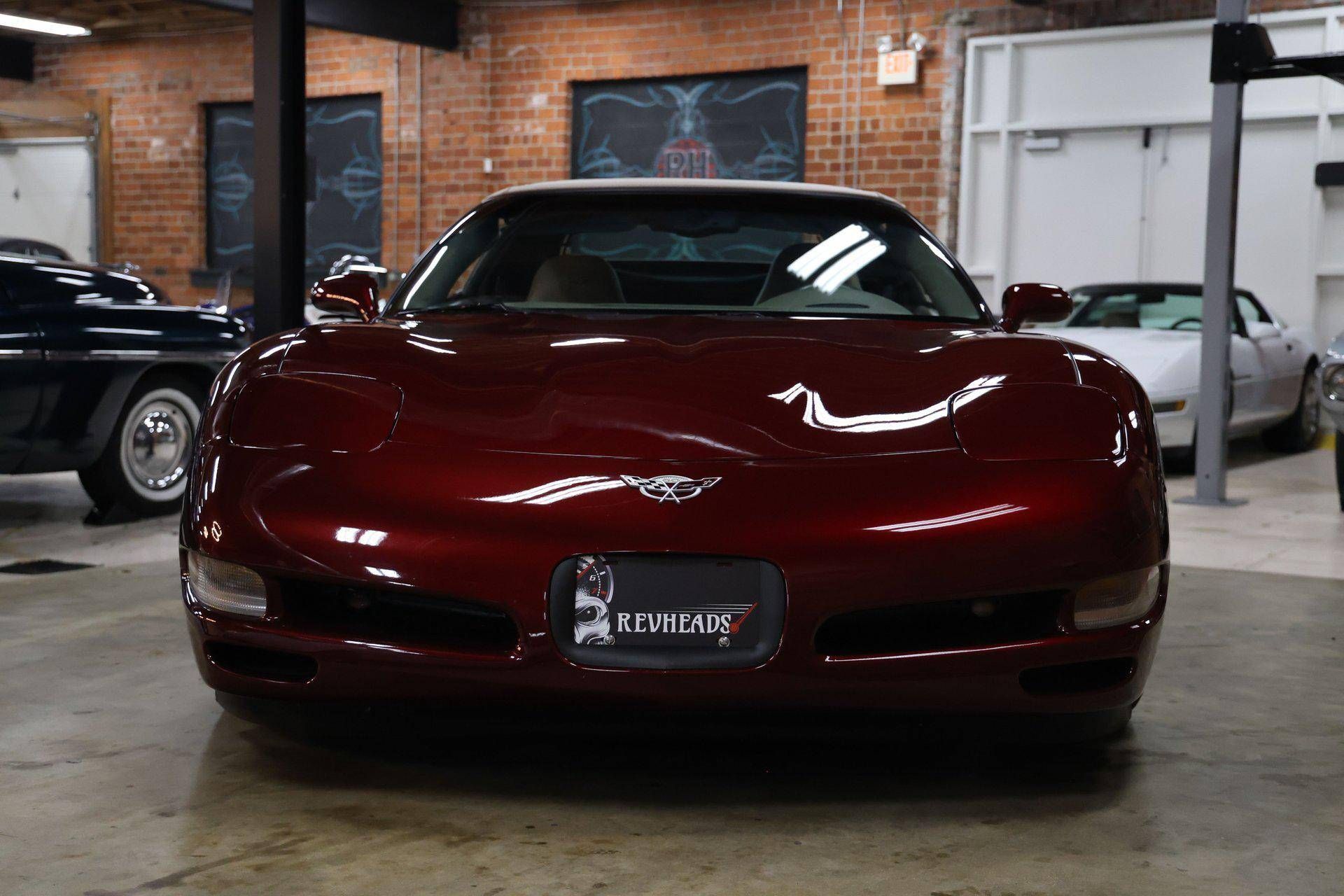

Well I would think he got replacement badges as I bought a set Of Original OEM badges and I'm telling you only an idiot like myself would pay what I did. And the thing is right from GM they only are simply painted silver, nothing special. I have some parts put aside for future use, and if I were in need to replace mine, I would most important spray them with a coat of clear. Also if you have your car detailed, you have to instruct the shop to use some masking tape on the badgers as a buffing wheel with definitely remove the silver paint. it's not a big deal and they most likely appreciate, this is just a picture of the badges on the front of a C5 2003.
the advice.

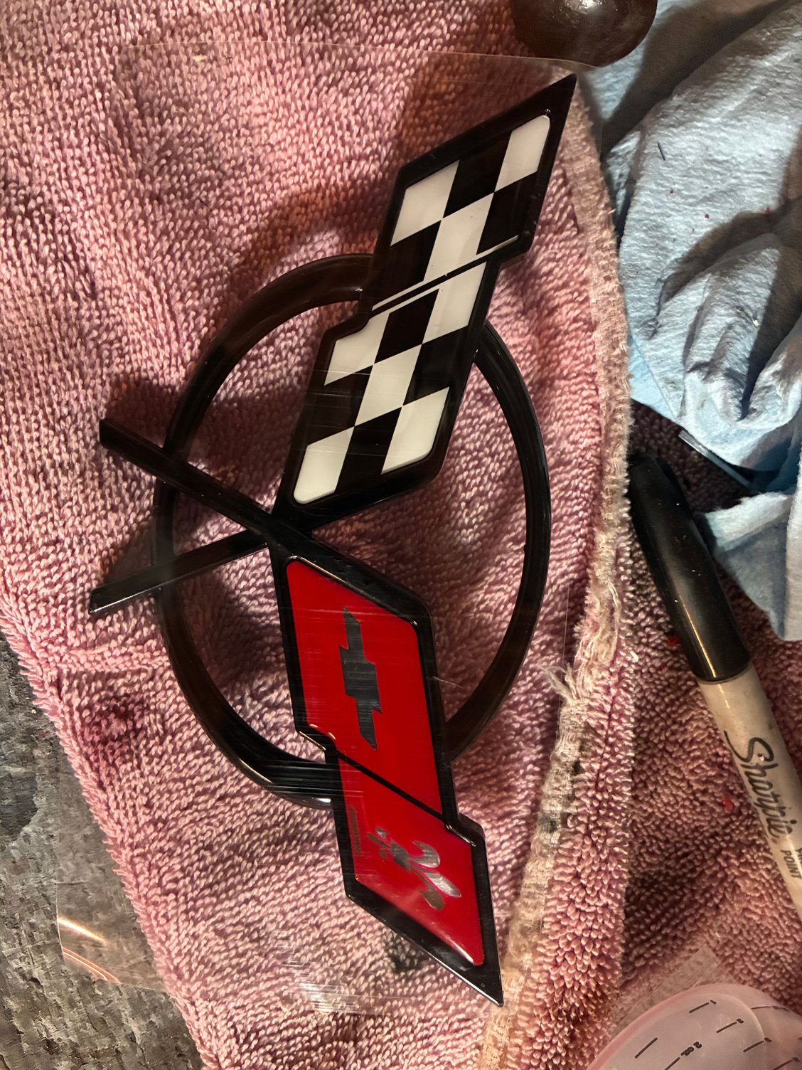

This is the badge im talking about. Should i sand before clear?

I sprayed mine without sanding, I think there’s enough porosity in the plastic. Just do a good job cleaning it to remove any oils. If you want to scuff it, try a gray scuff pad instead of sand paper.
