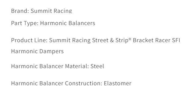

Originally Posted by hyperv6
Not two piece
If it's not two piece why does it have bolts and an elastomer?
Old Sep 7, 2025 | 11:06 AM
hyperv6's Avatar
hyperv6
Joined: Mar 2023
Posts: 2,917
Likes: 1,675
From: North Coast
It is one piece because it is bolted together as one unit not one just stuck together with a rubber ring,.
The bottom line is it is not just relying on the rubber to hold it together as the bolt prevent it slipping, turning and wobbling.
In other words will not fail in the same way the factory one does.
You can nit pick things but it is the best for the money and they failure rate is near zero,
Actually, the summit racing piece is a multi-piece part, it is just like the factory elastomer balancer, except it has a retainer ring that bolts on, that keeps it from coming apart, keeps the outer ring from slipping off the inner part.
The Summit one is great. Not two piece so it will not fail and it will not cost as much as other good units.
PB and stock will fail again.
Summit is ABSOLUTELY 2 pieces - you just cannot see the elastomer behind the screw in plate. Proof is in this video - I actually take the plate off so you can see.
All balancers are 2 pieces joined in some way by rubber to dampen the vibrations - except maybe Fluidampr.
Toys
https://youtu.be/ruCESs_UAUg
Toys
Look the unit is several parts bolted as one and not just bonded This is why it seldom fails. I may have explained it poorly but the point is it is a bolted one unit vs just a ring held on with a rubber ring only.
What is better the SFI unit or the stock or PB non SFI unit? I know you know the correct answer here, If you use the Summit one it is one and done.
