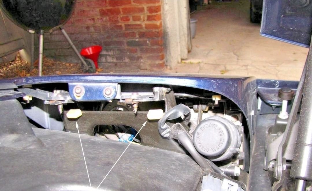

Did you check the bump stops on the back of the light bucket to see if one fell off or is damaged? You can just remove them and flip them around to the flat side if one side is damaged.

There's also a third bump stop inside. This one stops it on the way down. If it is missing or damaged it could also cause issues. Remove the bezel and you can see it down in there. It looks just like the ones on the back. A metal arm strikes it on the way down to tell the motor it is in the correct closed position. If it is excessively worn or missing. The motor won't get the right message that it is in closed position so it thinks it should stay open. If the bumper is there, try pulling it off, flip it an press it back on. The hopefully unworn side will cause it to work. These things are plastic and wear out. You can get new ones for about $10 a pair. There's three per housing but the back ones don't get nearly the abuse as the internal one.
