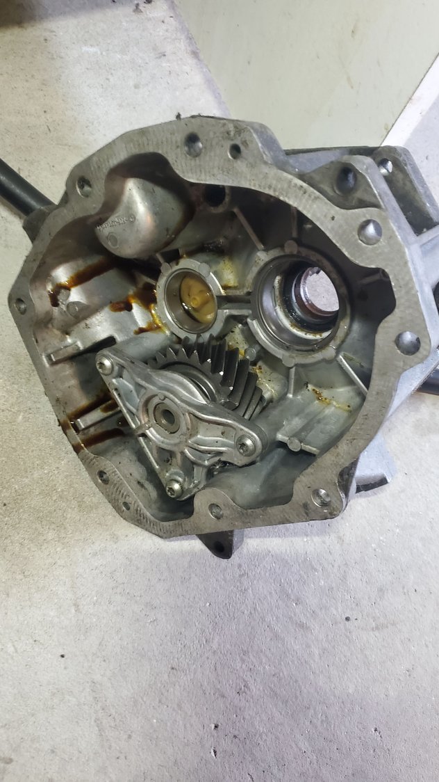

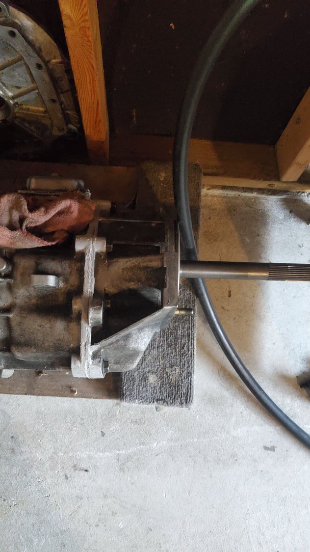

No you have to go into the rear of the trams and take out the reverse fork and modify. I have a trans out. Ill take pictures and show you what to do. You have to take out trans for this.

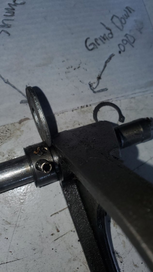

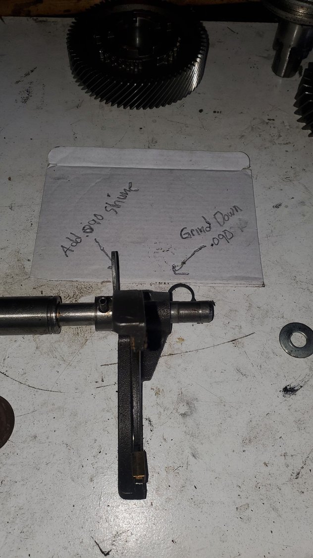

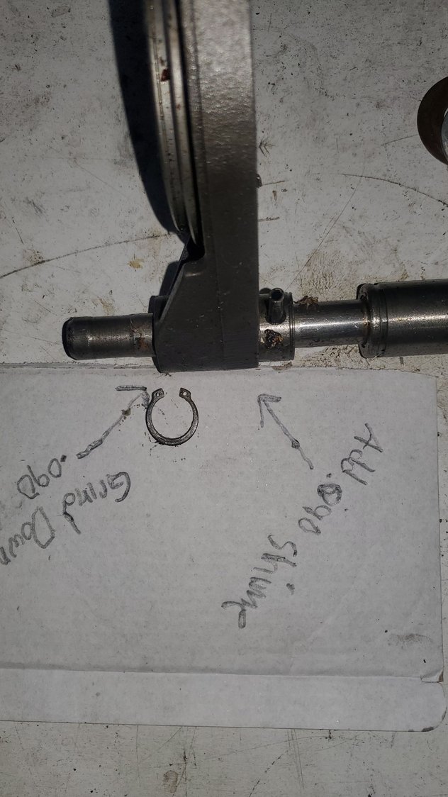

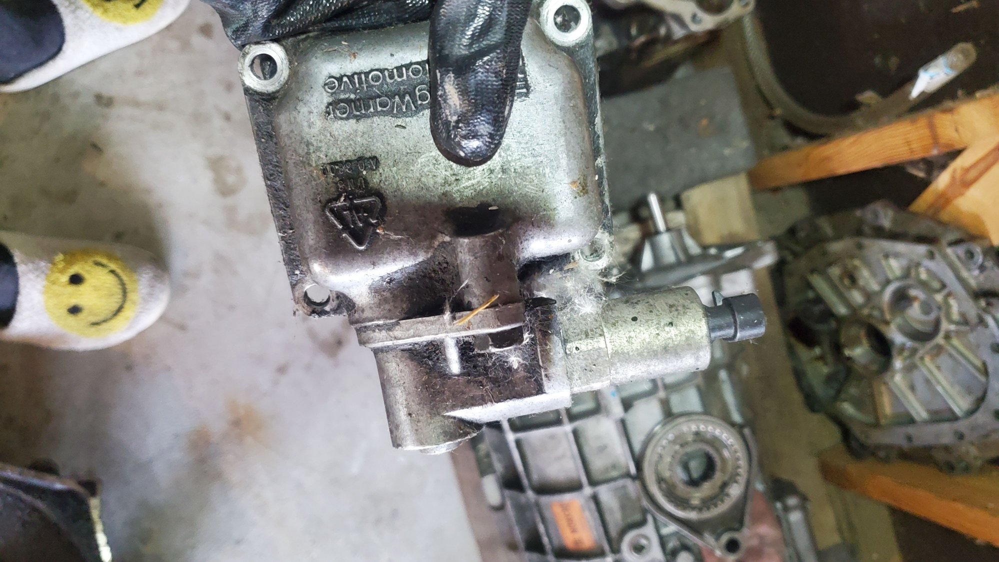

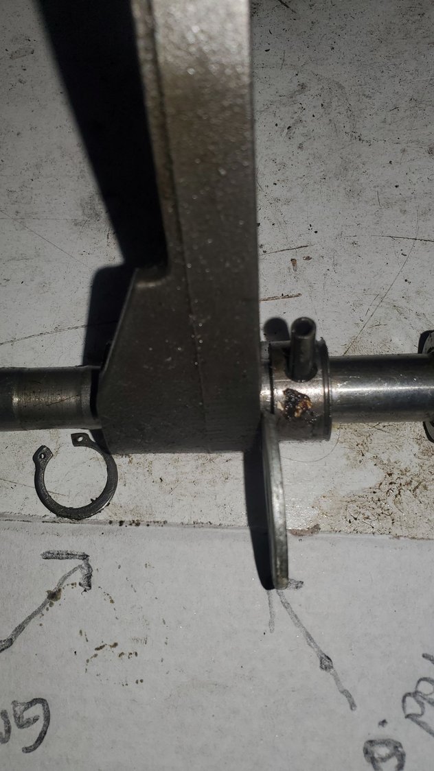

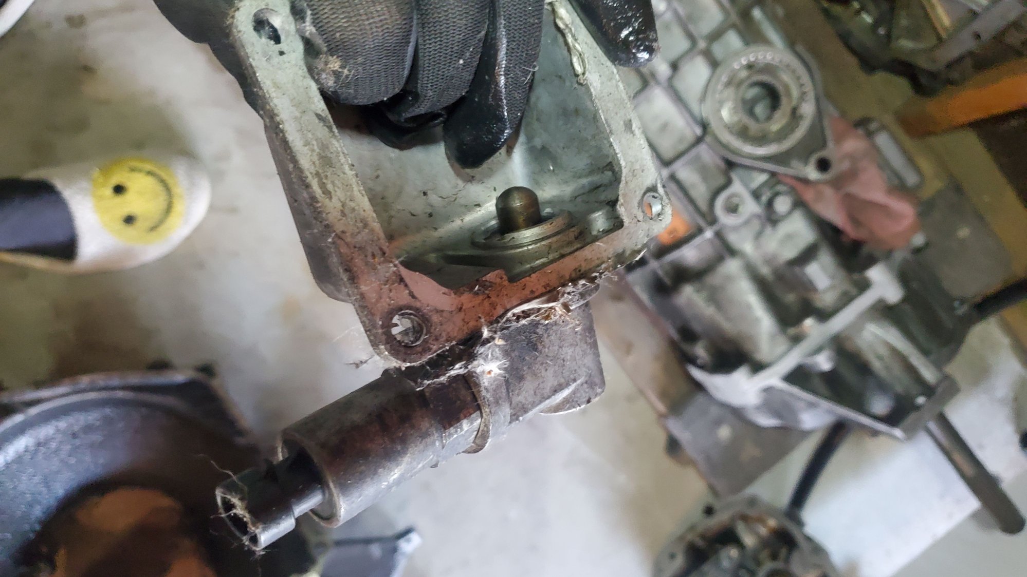

Old Sep 20, 2025 | 11:50 AM
helga203's Avatar
helga203
Joined: Jul 2010
Posts: 6,012
Likes: 726
 This side comes off
This side comes off
inside when off
inside when off
 This does nothing for your problem
same
same
This is the shaft that engages reverse gear pushes fork into reverse gear
 This is where you add shim to move fork closer to gear. Your shifting the fork closer so travel is shorter and can make more force to completly engage syncor so it doesnt pop out
Old Sep 20, 2025 | 11:54 AM
helga203's Avatar
helga203
Joined: Jul 2010
Posts: 6,012
Likes: 726
Im in the middle of rebuilding this trans for friend. Ask if you don't understand. This is what worked for the trans i did. Its the most common problem but your syncor might affect your problem if there damage. But start there because you have to tear down then you can inspect sycor teeth. Hope this helps
