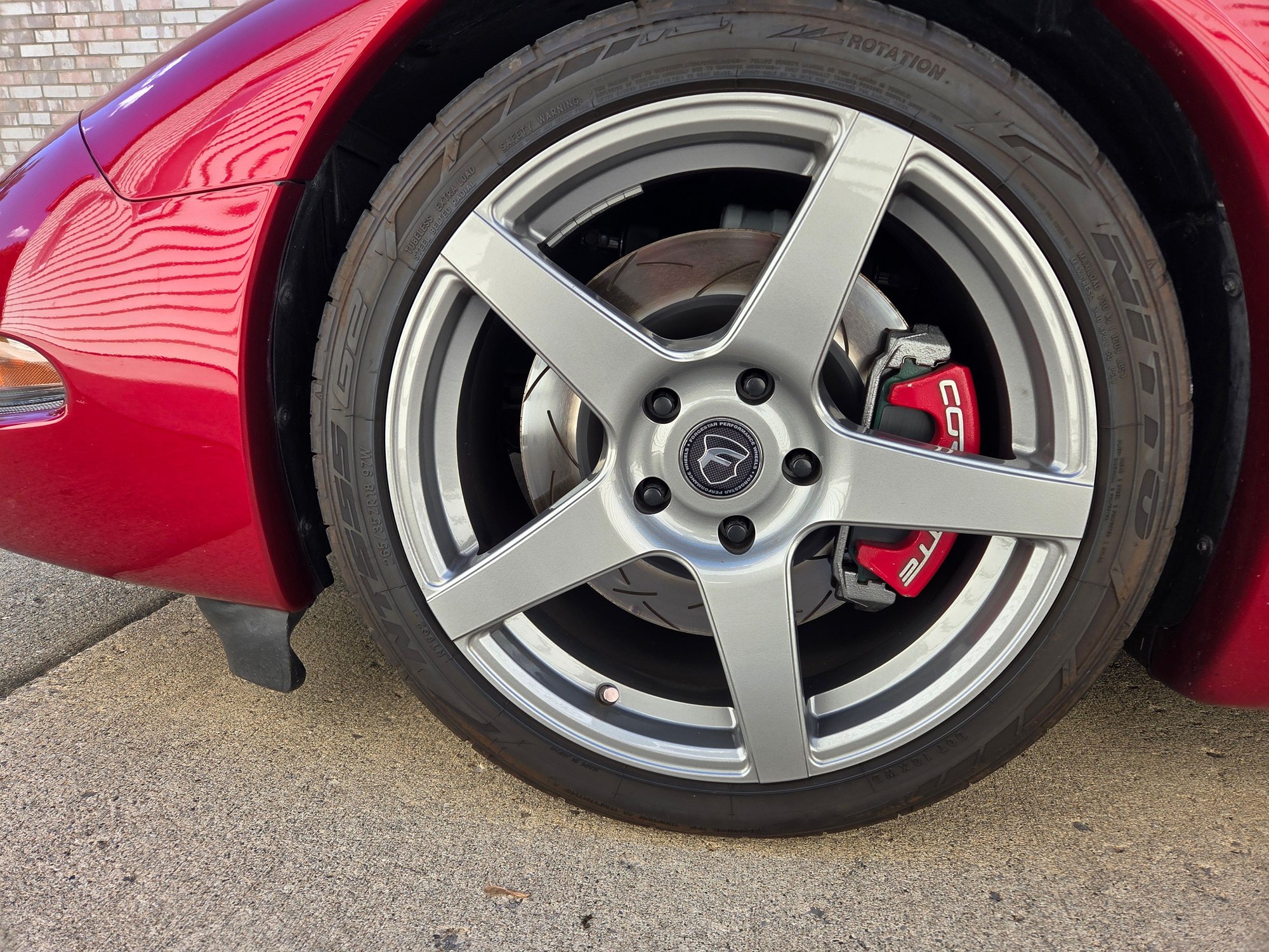

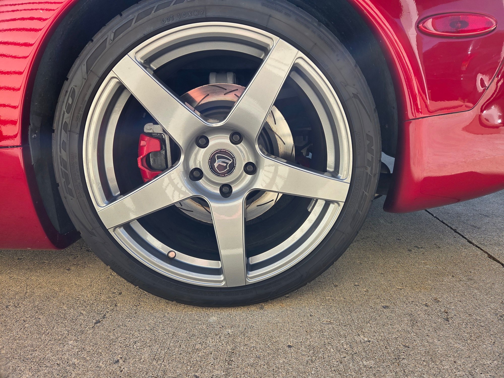

... I was wondering who of you are running 19" front and 20" rears on their cars? the C5 I just acquired has some Ruff Racing wheels in 19 and 20 but I am missing the front hub and spokes. Ruff Racing Wheels are out of business so no joy there. A lot of the C6 wheels are my favorite wheels on Corvettes anyway so will be looking at all those. I kinda like the 19 and 20 look on the car but just wanted to hear you opinions...... thanks

thank you for the posts.... someone has put 12" drilled and crosshatch rotors on this car somewhere in the past. Looks like the stock calipers on those bigger rotors..... The car is supercharged so that was probably the reason for bigger rotors......

Actually, stock front rotors are 12.8", just looks like drilled ones were added.
Stock rear rotors are 12".

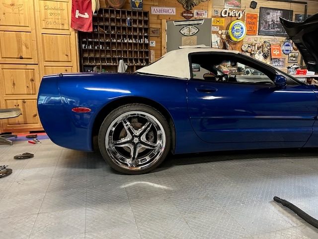

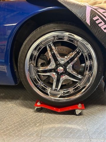

If you go big wheels and want better brakes on a budget the C6 J55 is a great option. 13" rear rotors and 13.4" up front. Look and work much better IMO. These are 18F and 19R wheels with J55.
